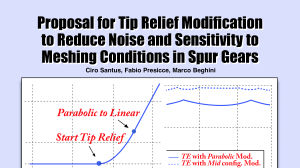

In this article, a new tip relief profile modification for spur gears is presented. The topography proposed here is a classical linear profile modification with a parabolic fillet.
