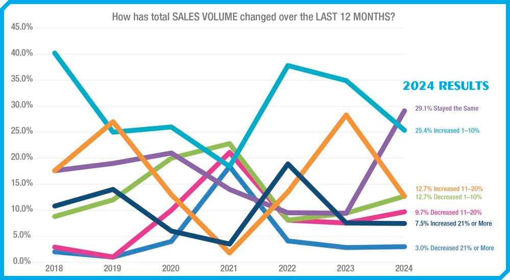

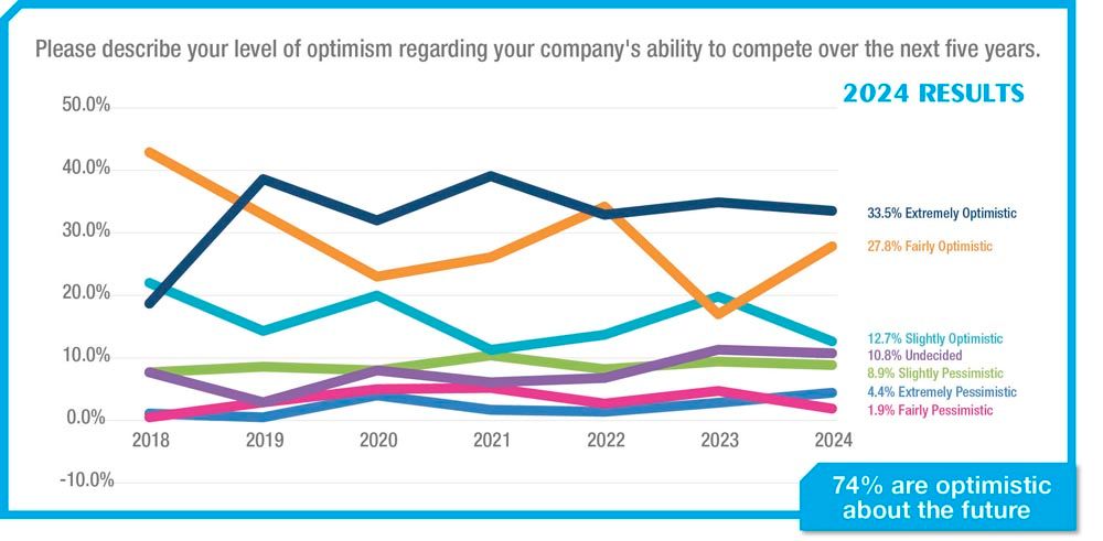

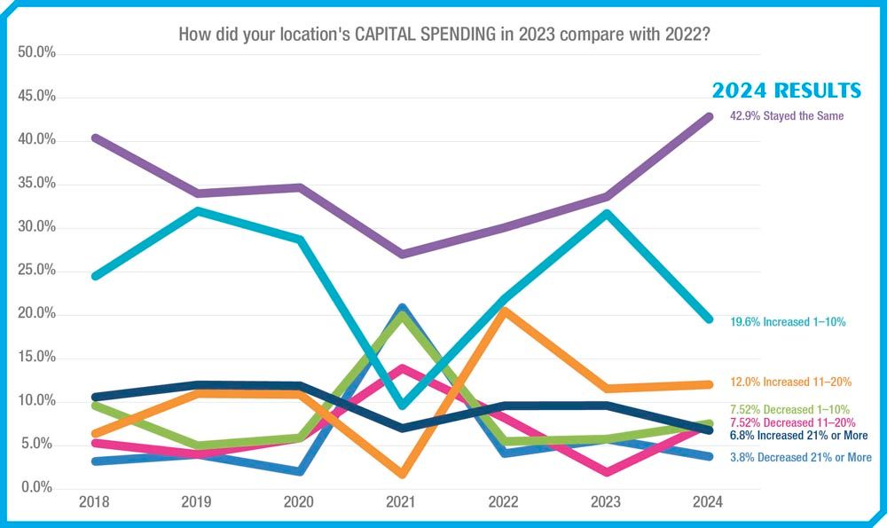

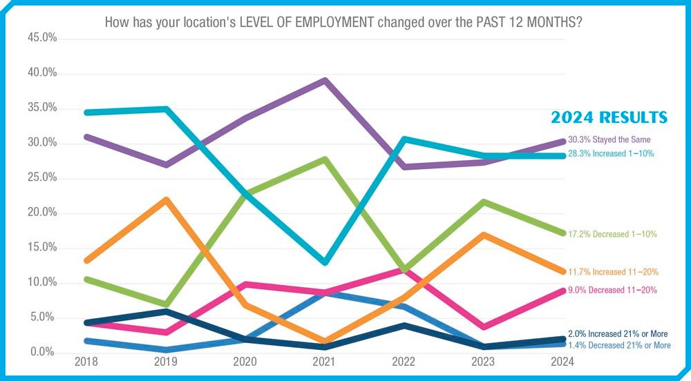

2024 State of the Gear Industry
Gear Technology’s annual State-of-the-Gear-Industry survey polls gear manufacturers about the latest trends and opinions relating to the overall health of the gear industry. As in years past, the survey was conducted anonymously, with invitations sent by email to our subscribers, AGMA members and others in the gear industry. Primarily, our responses come from North America, but they also include responses from around the world. Nearly 200 individuals responded to the survey.

“Difficult topic. Til now we are finding the right people—but it takes longer time.”
“Not much.”
“Try to retain old employes. Upskill junior level employees.”
“Automation wherever possible.”
“Hiring younger.”
“Increased internal training resources to create the skills. Also investing in technology to reduce reliance on skilled labor into the future.”
“We are trying to keep our current quality workers. But it’s taking longer to get new talent on board.”
“Using a partial non-migrant workforce.”
“Not very well. Recognition is slow in coming.”
“We are retaining our employees .”
“Much prayer, but maybe not to the correct deity. I’ve been in gears for 50 years. The biggest hurdle is management, because to bring a young engineer up to a level to be competent in gear unit design and engineering is five years with proper mentoring. A competent machinist about two years. A competent service man 3–5 years. The management philosophy is: Go hire someone today, they can start in two months, if they pass the hiring process, then they will be ready to go. The new people needed to be hired five years ago. Oh yes, pay!”
“We are not having a skilled worker shortage in the Greater Toronto area.”
“Investing in community development programs, investing in more job training programs, and automating what makes sense.”
“Increased compensation and benefits, increased internal training and opportunities to move within the company.”
“Hire and train and pay enough. Nobody thinks they can compete on compensation.”
“Trying to automate as much as possible.”
“Workers are being trained or reimbursed for college classes.”
“Training like crazy.”
“Training new employees.”
“We are not. We have a lot of old employees and no good way to fill the gaps.”
“We make people grow from the bottom. Nevertheless certain positions are difficult to cover.”
“Hiring bonuses.”
“Keeping talent motivated and rewarded. Generational changes are now more drastic with actual centennial people vs millennials and X, Y generations.”
“In-house training.”
“Recruiting heavily and attempting to automate wherever possible to reduce requirement of workers.”
“In-house training team with amazing capabilities.”
“Poaching is there to stay, and we are treating skilled workers as our own assets.”
“We have partnered and suggested our supply chain also partner with local schools and universities, basically bringing the apprentice program back.”
“Outsourcing.”
“Hope and a prayer. Refuse to develop or bring in young people. Keep holding on to “a hope and a prayer” to find experienced gear machinists. Need to bring back apprenticeships!!!”
“Training in house.”
“People are stable in their jobs, so far.”
“Still struggling.”
“Internal training programs.”
“Trying to do in-house training.”
“Continuously conducting interviews with possible candidates and improving the skills of unlearned workers through on-the-job training.”
“Poorly—we are having trouble retaining good people and finding replacements.”
“More on automation and de-skilling. For skilled worker, giving more opportunities and upgrading semi-skilled by training.”
“By adding fewer but people skilled in multiple areas and by training not-so-skilled ones in house under the guidance of the skilled workers.”
“With much difficulty because entrants to the metal industries are less available.”
“Internal training. Training local workforce.”
“Own internal school.”
“Upgrading equipment.”
“Society offerings of training, local junior college or trade school.”
“Training.”
“Training by using VR/AR/MR platforms.”
“Work in partnership with technical schools.”
“Automation.”
“I don´t know.”
“We have employed a new machinist in the gear cutting department to train and upgrade our output and quality.”
“Increasing the ability of current ones.”
“Training. Employees work in various positions. Promotion in universities and schools.”
“Training new candidates.”
“Training and skill development.”
“Increasing the trainees and providing the on-the-job training to them after systematic training courses.”
“Using CNC equipment.”
“There’s no way.”
“IT support.”
“Resource pooling, tie up with universities.”
“Apply new technology.”
“Push towards automating properties.”
“Working to improve our culture to keep people longer.”
“No problem as we are a small group who have all worked together for more than 55 years!”
“Apprentices (dual study).”
“No skilled young people available. Old people are still useful!”
“Offering competitive salaries and benefits in the market and a pleasant work environment to retain our staff.”
“In-house training programs.”
“Looking to sponsor out-of-country candidates, looking to education system for apprentice opportunities.”
“Junior colleges, recent military separations.”
“More focused hiring.”
“Reaching out to community partners for help in identifying and hiring employees.”
“Not a problem for us.”
“Focusing on internal skill-based training program and versatility training as well for longer term employees.”
“Exchanging skilled workers of the company located in different plants.”
“Internal training, women in trades, coop programs, increased compensation and benefits.”
“Working with local tech centers and colleges for their upcoming graduates. We are hosting many manufacturing visits from the local high schools.”
“Increase internal training capacity and attitude, expand company’s benefits to create employee loyalty.”
“Training.”
“Automating more, hiring less and upskilling.”
“Lots of interviewing.”
“It is extremely difficult to find professional help these days. We are on a constant look for a proper fit to our company.”
“No major issues this year after a rough 2023. Wages and extra recruitment efforts were needed in 2023.”
“Very hard to get young talent to do this type of work.”
“Looking to launch a formal apprenticeship program.”
