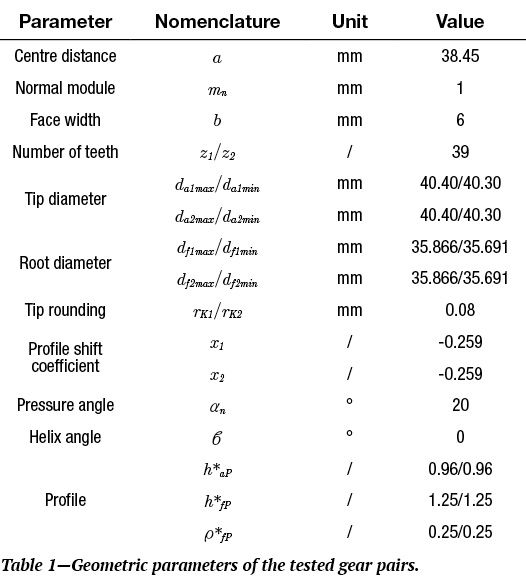

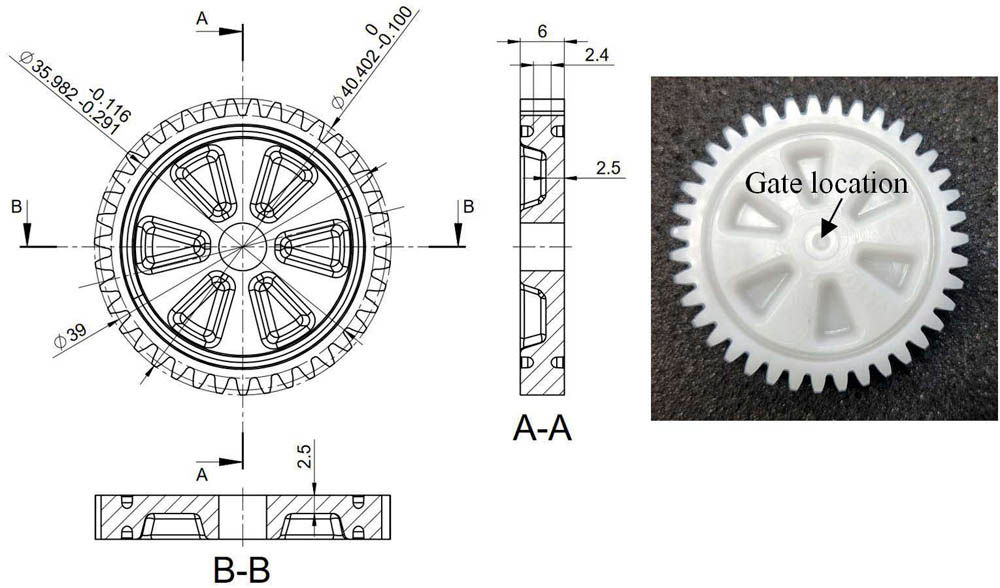

The test gear geometry was defined as per VDI 2736; Part 4, Table 1 (Ref. 1). Plastic gears were produced and used according to VDI 2736 “size 1-gear geometry” for the tests. The gear’s geometric parameters are presented in Table 1. The gears were made by injection molding in a single cavity injection molding tool. An Engel Victory 50 (Engel Austria GmbH, Austria) machine was used for molding. A mold with a hot runner system and a central pin-point gate of diameter 1.3 mm was used. The gear body is designed with a wavy structure that follows a uniform thickness of 2.5 mm (Figure 1). The transition from the gear body to the teeth is designed with a symmetric groove, which enables symmetric filling of the teeth. Gears were produced utilizing 7 commercially available plastic compounds, commonly employed for gear applications. The tool was designed with the possibility of exchanging cavities; hence, several different cavities were employed for molding to compensate for the different shrinkage of the tested materials. The goal was to produce all gears in the same quality range to exclude the gear quality affecting the NVH performance. The basic composition of the used grades was as follows:
