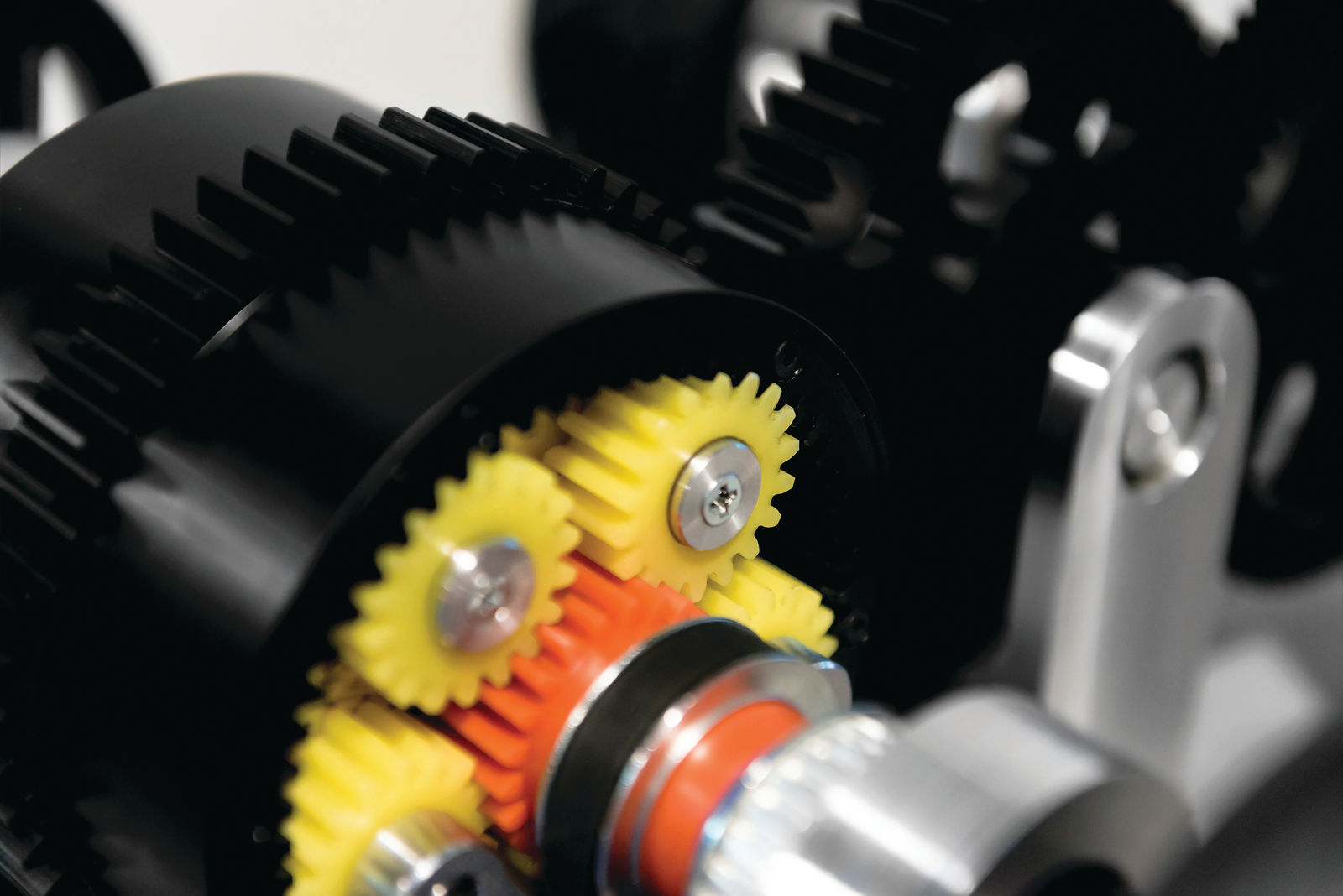

GettyImages-487391883.JPGSmall cog wheels made out of plastic | Getty Images/iStockphoto
