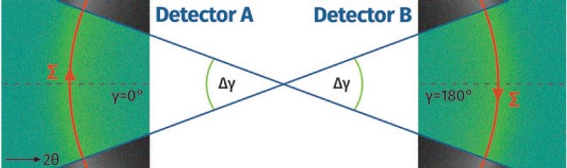

Traditional diffractometers tailored to measure residual stresses, including Stresstech’s prior offerings, often utilized 1D detectors. The use of more modern 2D detectors with improved sensitivity allows for significantly more diffraction data, as much as 100x, to be collected in the same amount of time. Sections of the 2D Debye-Scherrer ring are integrated into 1D intensity spectra for strain determination (Fig. 5).
Figure 5—The use of 2D detectors allows for the collection of significantly more diffraction data.

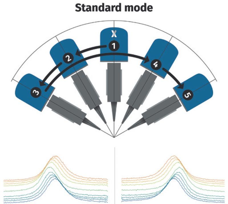

Diffraction systems utilizing the tried-and-true sin2ψ method have always followed a standard sequence of operation (or Standard mode, shown in Figure 6): 1, move X-ray incident beam and detectors to position; 2, Expose the sample the incident X-rays and collect diffraction data with detector; 3, Repeat 1–2 as necessary to satisfy the measurement specification such asEN15305. This type of measurement sequence is standard on nearly all diffractometers except for systems utilizing methods not in accordance with internationally recognized standards.
Figure 6—Standard mode x-ray diffraction systems use a time consuming sequence of individual scans.

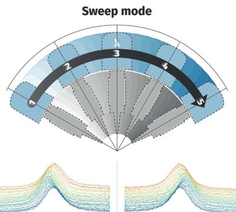

The speed of the detection system on the Xstress DR45 allows the diffractometer to collect “snapshots,” much like video frames, while it is moving (Fig. 7).
Figure 7—The Xstress DR45 is able to scan continuously, greatly improving inspection speed.

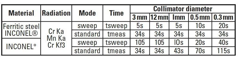

The result is a large improvement in total measurement speed over the already fast Standard mode speed provided by the Xstress DR45. Measurements on spots 1 mm in diameter or larger are performed in 5 seconds. Measurements on spots less than 0.5 mm in diameter can be performed in as little as 20 seconds. These speeds open the possibility of shot peen verification on gear teeth or roots which is fast enough to keep up with production in high-volume environments.

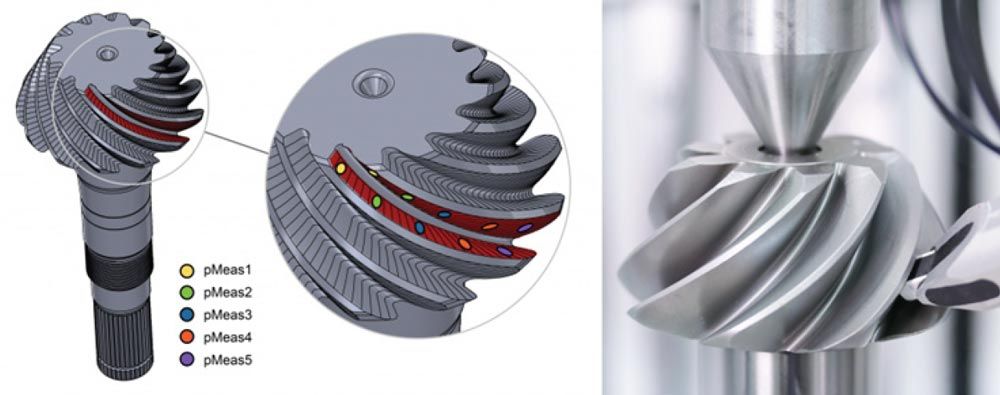

In the case of more complex geometries, such as hypoid gears, custom sensors are utilized, and sensor movement paths are generated along complex curves generated point-by-point (Fig. 14).
Figure 14—Complex geometries can be accommodated via special sensors and point-by-point control of the sensor path.

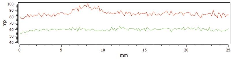

The result of a measurement sequence is a series of scans, or plots, similar to the output of an analytical gear checker. Lower and more consistent measurement values, essentially flat scans, are typically found in acceptable parts free of grinding burn (see the green line in Figure 15). In the presence of a grinding burn the MBN signal increases (see the red line in Figure 15).
Figure 15—In this chart, the red line represents MBN signal increases, indicating the presence of grinding burn.

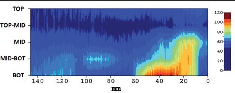

Multiple scans or passes per flank, performed at varying diameters, can be combined into a surface map. This provides the type of visual indication that Nital-etch users are accustomed to seeing, with the added benefit of objective, repeatable values (Fig. 16).
Figure 16 Multiple scans or passes per flank can be combined into a surface map.

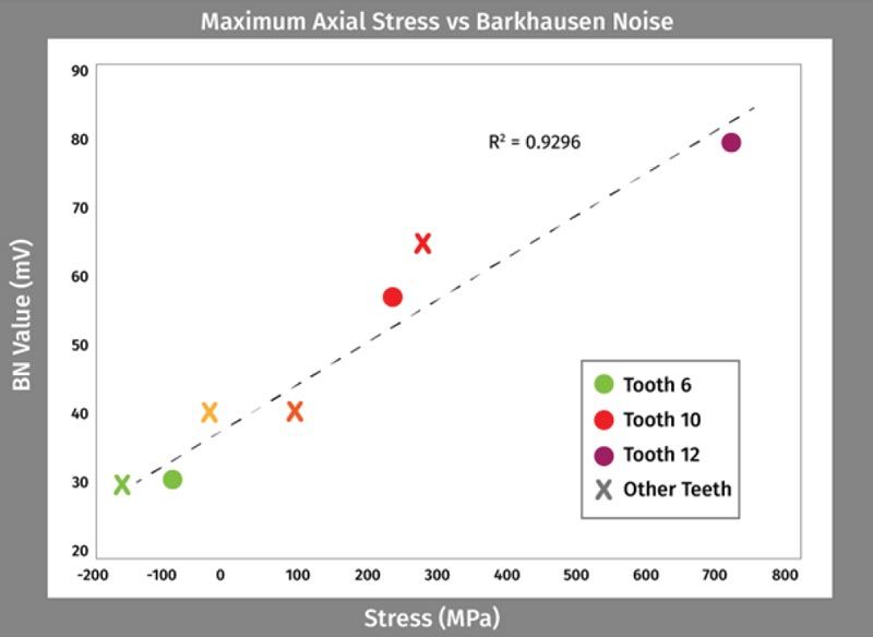

By comparing the relative MBN values to a quantitative method such as XRD the MBN values can be contextualized, and proper rejection/acceptance criteria can be developed. The most common method of developing rejection criteria involves comparing the MBN value to the maximum subsurface stress, measured via XRD, similar to the recommended practice in SAE ARP4462b. Such a comparison allows the user to choose an MBN value limit that corresponds to subsurface tensile stresses, or some other limit depending on the application and the design requirements for the component under test (Fig. 17).
Figure 17 Data from MBN scans can be shown against simple rejection/acceptance criteria for easy evaluation.
