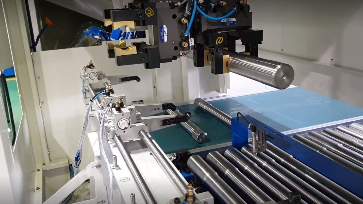

Affolter AF72 Linear Loader on AF160 CNC Gear Hobbing Machine
Affolter Group has introduced the AF160, which is their most versatile gear hobbing machine to date. “The AF160 is designed for high precision manufacturers that need versatility and maximum efficiency,” explains Vincent Affolter, managing director of Affolter Group. “With eight axes, a state-of-the-art digital CNC control, a variety of automation solutions, and a maximum module of 2 mm, it is ideal for manufacturers in industries such as automotive, aerospace, aircraft, gearbox, medical or robotics.”
The AF160 can process parts with an outside diameter of up to 60 mm and a length of 250 mm. The machining crews, worm wheels, cylkro gears, and internal gears. Gear skiving, the milling of worms and shafts, and chamfering are possible, too. Affolter continued, “The AF160 enables manufacturers to produce an impressive variety of high precision gears, worm screws, and worm wheels on the same, compact machine.” The footprint of the machine is only 4m². Including the loader AF72, which is a little more than 6m².” A new video shows the system in operation:
Depending on the application and production processes, manufacturers need automation solutions to facilitate an autonomous operation for 12 to 24 hours. Affolter provides a range of such automation solutions: The universal multi-axes part loading and unloading system AF72 was specially designed for the AF160. It features a double gripper system for parallel loading and unloading and offers different methods of feeding based on the volume, product, and application. The AF160 can also be equipped with the deburring unit AF54, integrating the deburring process into the gear production. Different clamping systems provide for added versatility. Customizable coolant systems and chip extraction conveyors are available as well.
