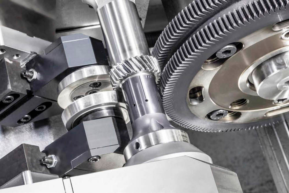

Chamfer Rolling for High-Volume Production
Chamfer rolling with secondary deburring discs. A very fast process that can, however, form a secondary burr that must be removed downstream.
Sometimes referred to as press chamfering or rotary chamfering/deburring, this very fast forming process has been around for years, and it is used effectively for high-volume production of planetary gears or shafts with interfering contours. Using gear-shaped tools that mesh with the workpiece creates chamfers along the tooth edges. Excess material flows mainly to the face side of the gear, where it’s cut away with single blades, deburring discs, or file discs, depending on gear shape and/or machine configuration. However, the forming process can result in a minute deformation of the workpiece and material flowing into the gear tooth flank itself, thus forming a secondary burr that must be removed in yet another operation before hard finishing downstream. Additionally, with dry machining now predominant, the forming process isn’t as efficient as when performed wet, reducing tool life. For EV applications in particular, these factors can combine to raise costs to prohibitive levels.
