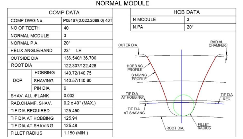

When the true involute form (TIF) diameter and fillet radius of a component is not achieved with a standard design, then the pressure angle of the hob is reduced or increased to obtain the correct TIF and fillet radius of the component. This can be explained with the below example.
gt0623_Page_30_Image_0001.jpgFigure 1—Component generated profile with standard design.
Standard Hob Design
Principally, TIF shaving should be below the required TIF diameter. However, when the hob is designed with the standard method, TIF required and TIF shaving are almost at the same values. Please refer to the component generated profile in Figure 1.
gt0623_Page_30_Image_0002.jpgFigure 2—Component generated profile with corrected design.
Corrected Lead Hob Design
To achieve the principal requirement of getting TIF shaving below TIF required, the pressure angle of the hob is reduced from 20 degrees to 18 degrees. Please refer to the component generated profile in Figure 2.
Hence, the corrected lead hobs are necessitated to be designed due to limitations in achieving the component data.

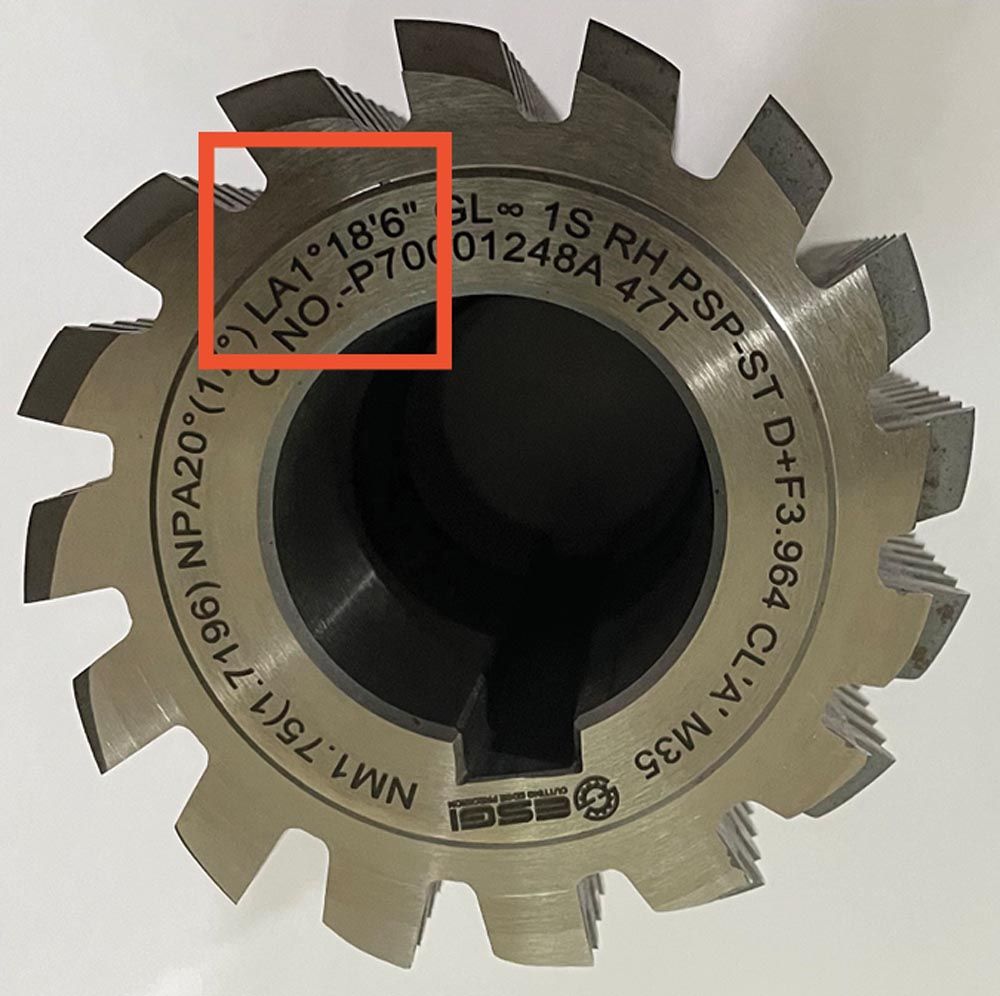

The lead angle is the same as the set angle. Hence, only the lead angle will be marked on the hob (Figure 3).

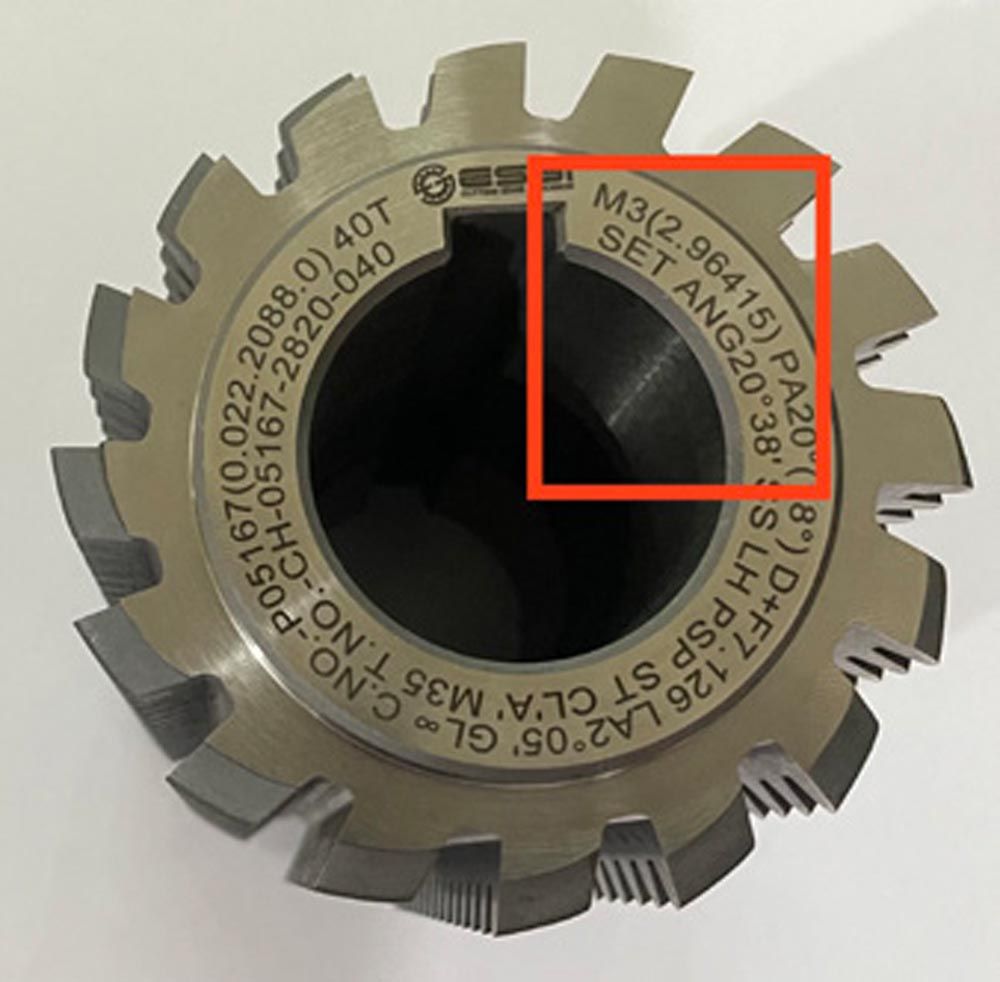

The hob set angle is different from the hob lead angle. Though, both the lead angle and set angle are marked on the hob, only the set angle should be referred to for setting the machine (Figure 4).

Spur Gear
The hob lead angle as marked on the hob is to be manually set on the machine. For example, referring to Figure 3, the value to be manually set on the machine is LA1°18'06".
Helical Gear
Hob set angle (not lead angle) as marked on the hob to be manually set on the machine. For example, referring to Figure 4, the value to be manually set on the machine is SET ANG 20°38'.

Input original module and original pressure angle (Module 3 and pressure angle 20 degrees as in Figure 1).
Hob Data File
Input corrected module and corrected pressure angle (Module 2.96415 and pressure angle 18 degrees as in Figure 2).

Input the corrected module and corrected pressure angle (Module 2.96415 and pressure angle 18 degrees as in Figure 2).
However, the operator must ensure that the hob set angle calculated by the machine is the same as what is marked on the hob.
