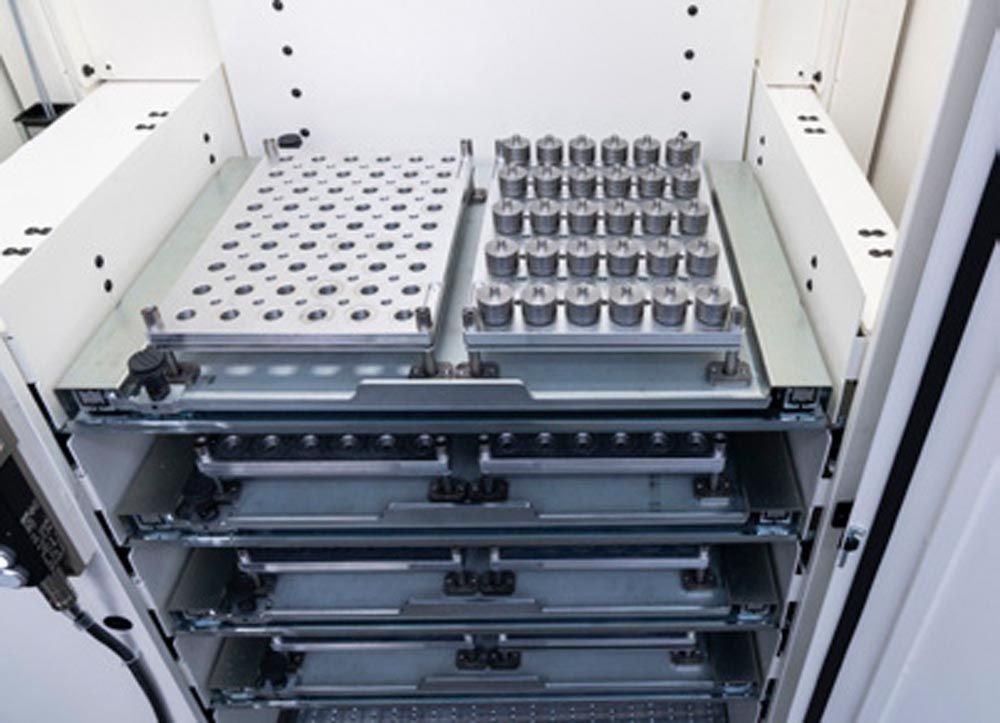

A look at the details shows just how different EMAG’s robotic solutions are: Parts can be fed, for example, using infeed and outfeed belts, palletizers, drawers, or bin picking. With the help of these systems, the robot “operates” itself when it picks up or finishes placing new components. Each solution has different strengths and basic conditions. For example, belt or hinge conveyors are an ideal option when the flow of parts needs to be smooth from an upstream production solution to the EMAG machine. The robot can then simply pick up the components from the belt and deposit them again later, with the belts arranged in different ways—depending on the space situation or the desired flow of parts. Pneumatic stoppers ensure that the components are separated. It is also possible to detect the workpiece alignment on the belt using a camera. A highly flexible alternative to this is the so-called “bin-picking systems” (“reach into the box”). Here, the workpieces are in a chaotic position, with the robot arm not only picking the components with the aid of a 3D sensor system but also correctly recognizing and aligning them and feeding them to the next processing step. The system can be used flexibly and configured for many applications.
In contrast, the use of palletizers presupposes an “orderly” start. In this case, the system is loaded and unloaded via a blister cart, for example. It contains boxes stacked on top of each other with corresponding mold nests containing the components—i.e., a relatively large quantity per cart, which an operator simply pushes into a defined position from which the robot can access. The cart with finished parts is in a different position. “One of the things that matter in this kind of solution is that you relate the cycle time of the EMAG machine and the desired man-hours at the machine. So, if the machining cycle within the machine is only a few seconds and at the same time you are aiming for minimum operator effort at the machine, this solution may not be suitable because the carriages would then have to be replaced too frequently. But these are precisely the calculations that we carry out for every robot solution and advise the customer accordingly,” explains Arnold.
