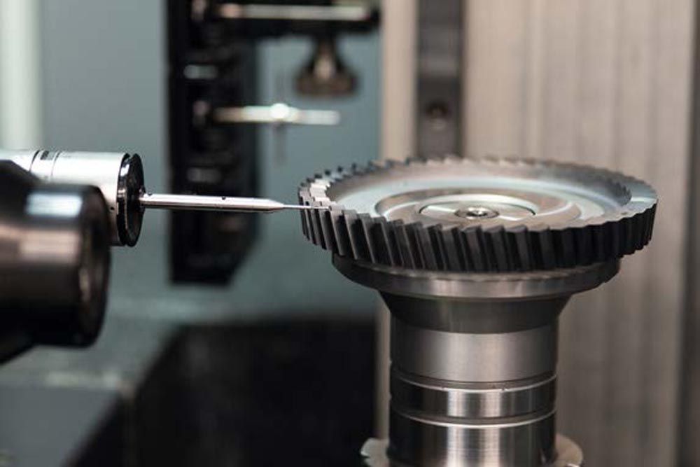

Manufacturing skiving tools is demanding, requiring stringent quality control. A sensor probe may be used to measure dimensional geometry.

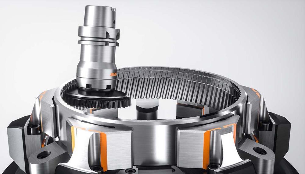

A gear skiving wheel should work on internal and external gears. This can be either a shell tool or a shank tool comprised of HSS or carbide. After the skiving wheel has been designed based on a 3D drawing and the part, the skiving process can be simulated to show the wheel passing through a tooth gap in the gear. In this first step, penetration occurs and results in interlocking and cutting. Then the adjusting screws can be turned until the skiving wheel is geometrically defined.
During the design process, collision checks are performed to produce a tool drawing with all the required parameters ranging from the number of teeth to the axis cross angle, to the recommended machining speeds and feeds. It is important to adhere to these specifications because while deviations from the specified machine speed may not immediately lead to a collision, the gear-cutting quality and result would surely degrade.
Once the tool design has been determined, the skiving tool can be produced. Manufacturing the skiving tool to integrate it into a demanding gear-cutting process requires tactile measurement technology. In addition to optical measurement, your cutting tool manufacturer may use a special sensor probe to measure with high accuracy the proper gear geometry. The sensor probe is a precise, safe, and repeatable method for inspecting the gear skiving wheels, and for scanning and evaluating the complete gear profile.
Skiving tool with bore is held by a diaphragm milling holder.

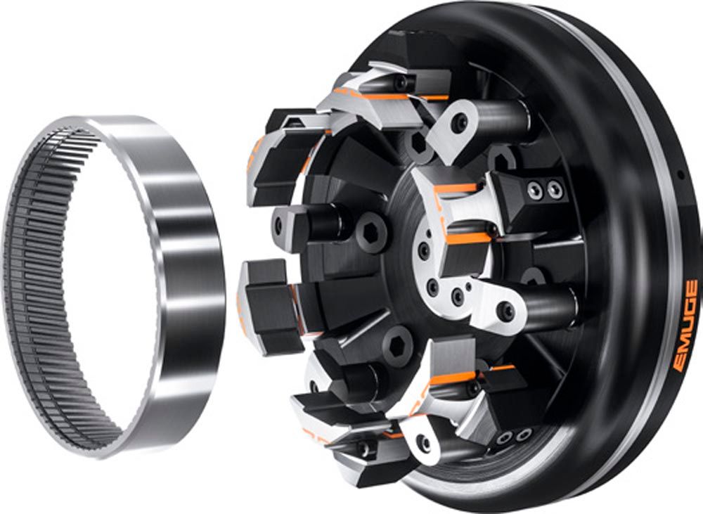

Diaphragm chuck adapts well to the contours of the gear.

When clamping the gear, a diaphragm chuck can achieve superior concentricity and roundness, even on filigree parts. This clamping solution adapts very well to the part contour. It also protects against contamination from coolant and swarf. In roughing operations, the clamping force can be further increased by the pulling force of the machine tool. In addition, due to the integrated centrifugal force compensation of the diaphragm, the part is tightly held even at higher machining speeds.
With the variety of parts that are “roller peeled” today, the diaphragm chuck is commonly tailored to ring gears or similar designs. However, custom clamping solutions featuring mandrels or chucks of other designs can serve a range of part geometries.
