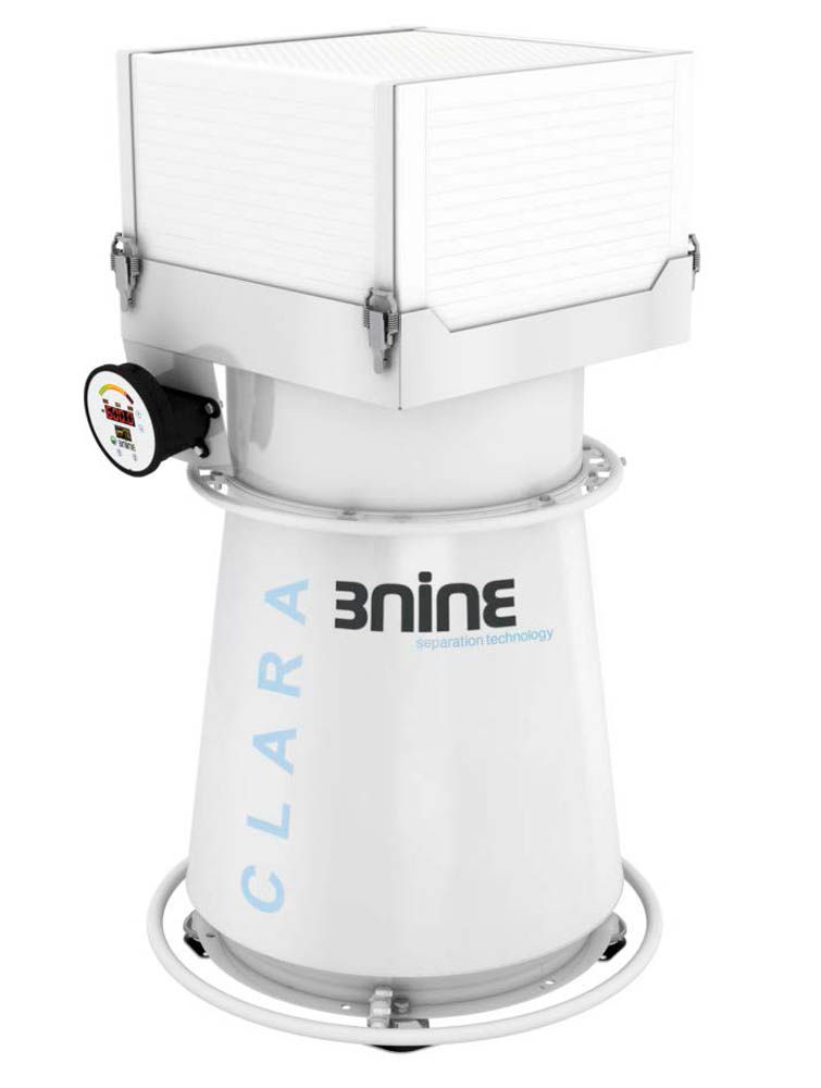

Specifications
Suitable for cabin size: Air flow: 600 CFM
Operating conditions: Power supply: 30/15 A, 230/460 V/3/60 Hz
Motor rating: 1.5 kW
Rated current: 5.6 A (230 V), 3.6 A (460 V)
Weight: 154 lbs
Height: 45”
Diameter: Ø 25.2”
Inlet pipe: Ø 6.3”
Sound level:
The oil mist eliminator Clara by 3nine is suitable for just about any type of machine tool with a cabin size not exceeding 353 CF (10 m³). The Clara effectively cleans the oil mist formed during parts processing and delivers clean air into the workshop, along with recycling almost all of your oil/coolant for reuse.
3nine is a Swedish company that develops solutions for the purification of processed air for the metalworking industry. The technology is based on centrifugal separation, using a disc stack which produces an extremely high degree of purification in a very compact format. Disk stack technology, also known as a disc stack centrifuge or separator, is a separation technology that uses centrifugal force to separate solids and liquids based on their density. The technology differs from traditional technologies such as rotating filters, electrostatic filters and mechanical filtration solutions by physically separating out the oil particles from the air instead of collecting them in filters. This allows for the immediate reuse of expensive cutting fluids and reduces maintenance.

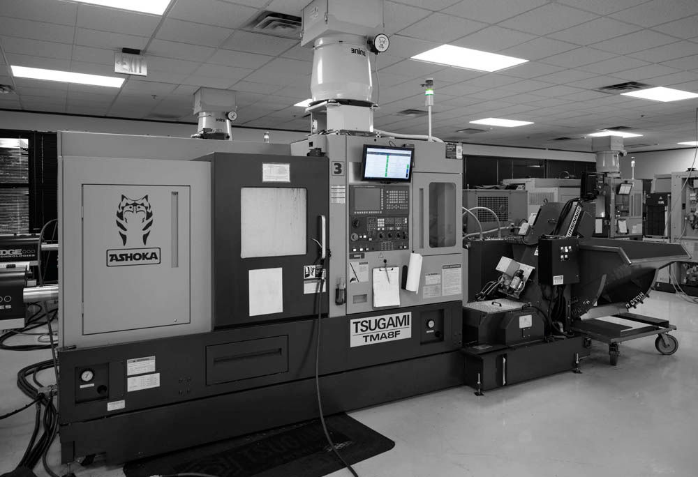

Stepping into Wolfram Manufacturing’s facility today, you wouldn’t know it was a place where heavy-duty CNC machining takes place. The air is clean, and the shop floor is free from the usual haze of mist that characterizes many machine shops. This hasn’t always been the case, however.

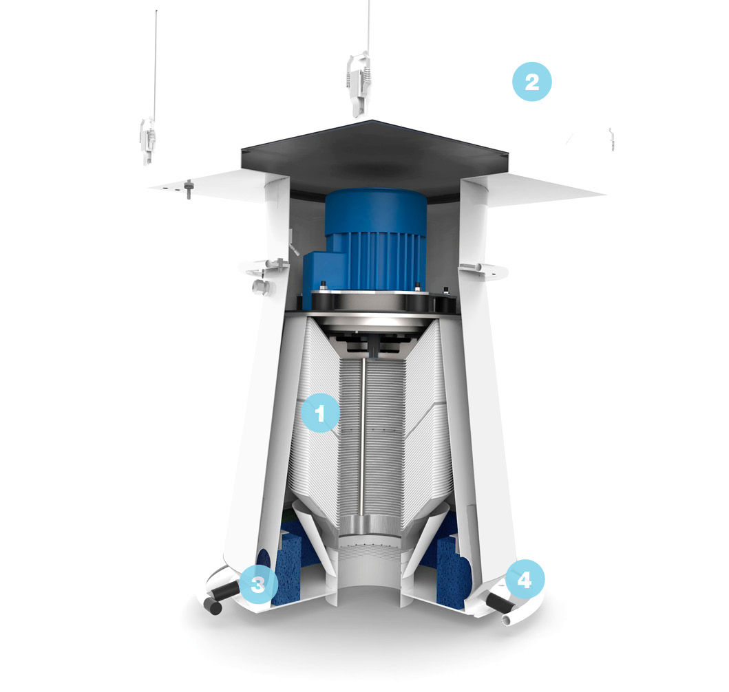

Operating Principle
1. Permanent media—The oil mist enters the disc stack where 99.9% of the fluid particles are separated from the air down to 1µm.
2. H13 HEPA filter—The particles smaller than 1µm, will be collected by the final stage HEPA filter.
3. Fluid Recovery—The separated cutting fluid is returned to the machine tool for reuse.
4. Self-Cleaning—The disc stack is automatically and continuously cleaned with the CIP (Clean in Place) system using clean cutting fluid from the machine tool.

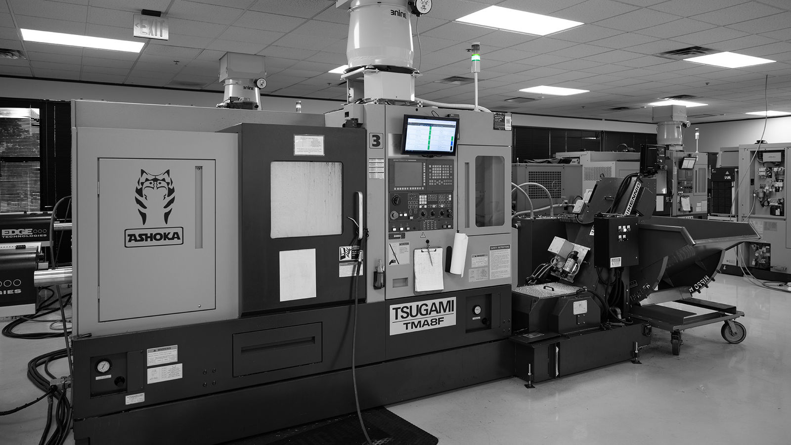

The design of the 3nine system offers significant advantages over traditional mist collection systems. Unlike bulky ventilation units that require extensive piping and large floor space, the 3nine collectors are mounted directly on top of the CNC machines. This space-saving design was crucial for Wolfram, particularly as they moved into their new facility.
“Our current space has a drop ceiling, which helps keep the temperature down, but it also limits how we can position large equipment,” says Martinez. “The compact size of the 3nine units allowed us to make the most of our available space without compromising our cooling systems.”

A 3nine filter in service at Wolfram Manufacturing with clean epoxy floors and a white drop ceiling.
