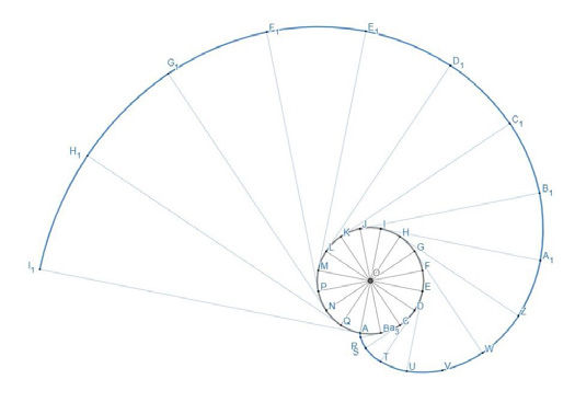

Often overlooked is the possibility of cutting gears with tools that have different pressure angles from the gear, resulting in benefits on several fronts. These type of tools are called “corrected lead” (Ref. 2), “short-pitched” (Ref. 3) or “modified rolling” hobs.
Before proceeding to analyze this possibility, it is worth noting that the involute geometry (and thus the shape of the tooth flank) is solely determined by the base circle from which the involute curve is “unrolled.” It is not the module or the pressure angle that defines the involute, but the base circle. The standard Equation 1 is not the definition of the base circle, but rather that of the base pitch. In Equation 1, the only truly physical quantities are the number of teeth (which can be counted) and the diameter of the base circle, which, although not visible to the human eye, uniquely defines the shape of the involute curve. Infinite combinations of module m and pressure angle α can lead to the same base pitch and thus the same base circle diameter, if multiplied by the number of teeth.
Equation 1
(1)
where
db is the base diameter
z is the number of teeth
m is the module (without subscript, considering spur gear)
α is the pressure angle
The module is therefore a conventional quantity used to define the size of the teeth (so much so that in AGMA documents, diametral pitch is found instead of the module). To simplify the approach, only spur gears are considered, so module and transverse module are the same.

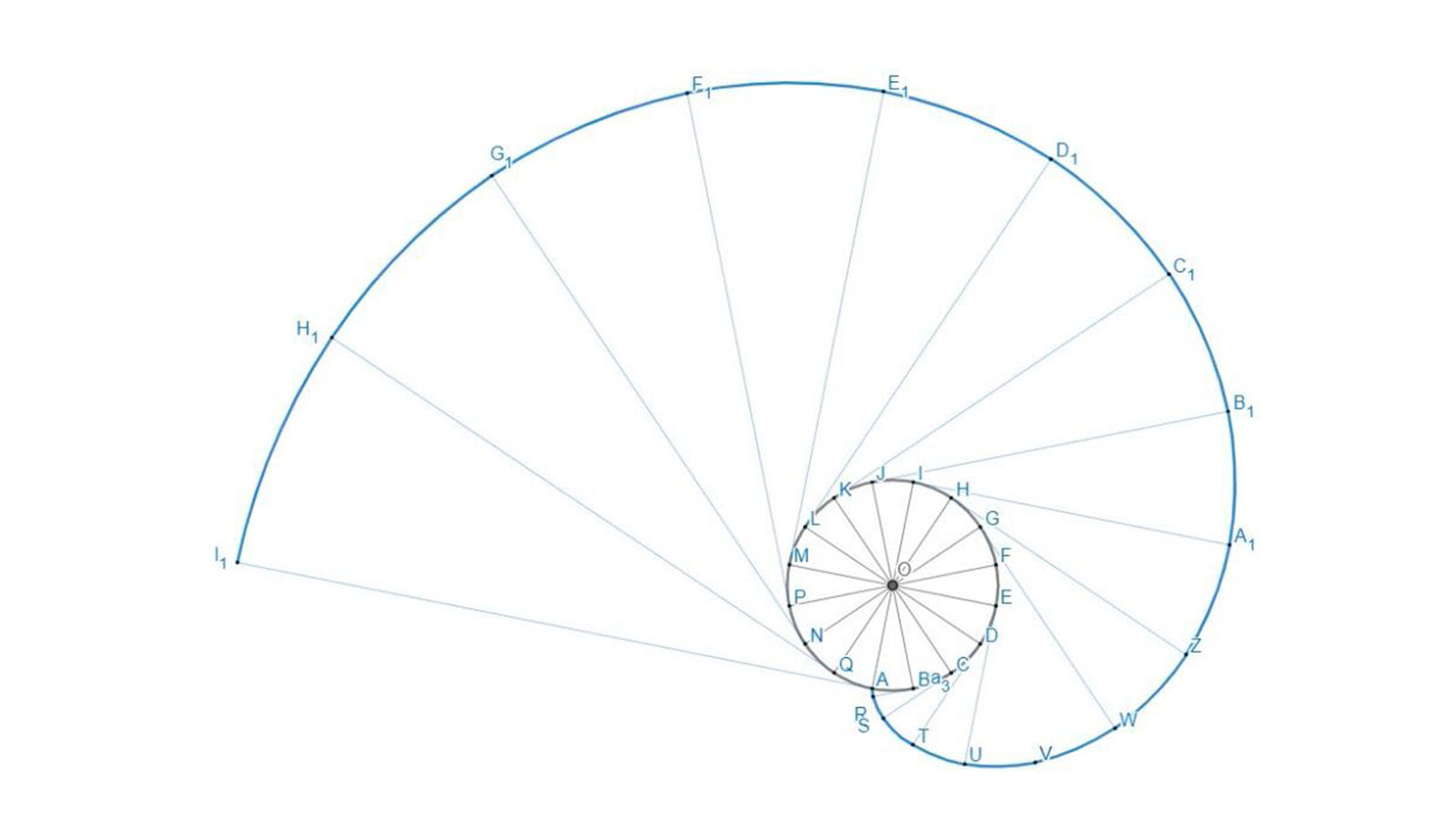

A bit less conventional is the definition of the pressure angle, but there isn’t just one: there is a distinction between the operating pressure angle and the reference profile pressure angle (Ref. 4).
The logical sequence for defining the shape of gear teeth starts with fixing the base diameter and the number of teeth (and then cutting it from root to tip circle). The base pitch pb will then be uniquely determined.
Equation 2
(2)
But this formula is also valid
Equation 3
(3)
At this point, there is only one degree of freedom: either the module or the pressure angle is fixed. Any combination of module and pressure angle that leads to the same base pitch will also result in the same shape of the tooth flank.
At an industrial level, however, it is convenient to follow the reverse path, having standardized the pressure angles and modules (Refs. 5,6).
Figure 1—Involute of circle
Figure 1—Involute of circle.
As explained very well in (Ref. 7), since the phenomenon of cutting interference is greater when the hob’s addendum is larger, meaning when the distance from the tooth tip to the pitch circle is greater, it follows that reducing the hob addendum value is sufficient to reduce interference. Essentially, it involves rolling on a circle closer to the center of the gear.
Decreasing the pressure angle a, while keeping the base circle diameter db and therefore the profile tooth shape, means reducing the pitch diameter d, according to the formula (4). This is why reduced pressure angle hobs are discussed.
Equation 4
(4)
The main advantage of using this type of hob is the reduction in interference and thus the increase in the length of the contact profile, resulting in less stress on the tooth tip and consequently improving the efficiency of the hob itself.
It should also be noted that a hob with a lower pressure angle has a lesser tendency to transmit manufacturing and assembly errors to the tooth profile.

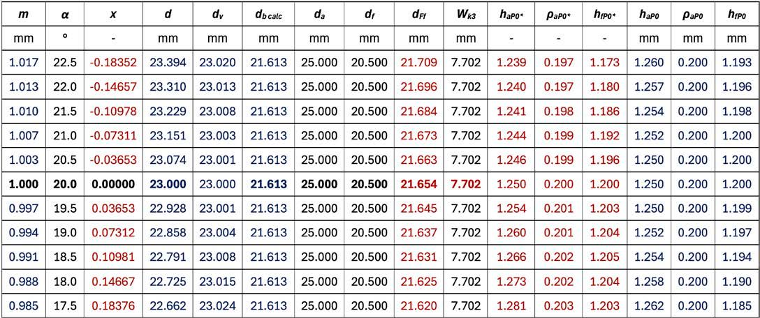

Case 1: “Classic” Gear, Profile II DIN 3972, Hobbing
The first analysis was performed on a standard gear, for academic purposes only, with no practical application. It was chosen to start with a hobbed gear module 1, with 23 teeth, pressure angle 20 degrees, x=0 and reference profile II DIN 3972 (Ref. 9).

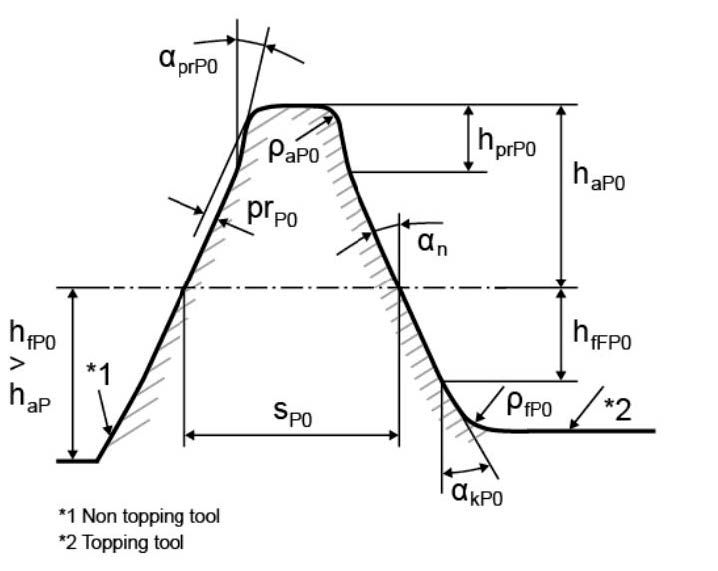

Two phases were undertaken. In the first phase, the geometry of the reference profile of the tools was defined with different pressure angles to achieve the same geometry of the flank of the starting gear (including tooth thickness) and the same tip and root diameters. In the second phase, these tools were used to generate gears with different numbers of teeth.
Tool Preparation
On a spreadsheet, the geometry of the “master” gear with a pressure angle of 20 degrees has been entered, as indicated in bold in Table 1. On the same spreadsheet, the column α has been populated with values from 17.5 to 22.5 degrees with a step of 0.5. For each row, the module has been calculated using Equation 3, keeping the base pitch of the reference gear fixed. The tip diameter da, root diameter df, and tooth thickness (span measurement) have been set equal for all rows. The pitch diameter d and V-circle diameter dv have been calculated on the same spreadsheet. These values have been entered into the KISSsoft calculation software to obtain the values indicated in red. In Figure 2, the geometries of the gears with pressure angles of 17.5, 20, and 22.5 degrees are visible. The rightmost 3+3 columns of the table constitute the definition of the tool reference profile for each gear. These profiles have been saved in the software’s database.
Table 1—Gear data for different modules and pressure angles, with fixed base pitch, tooth width, root diameter and tip diameter
Table 1—Gear data for different modules and pressure angles, with fixed base pitch, tooth width, root diameter and tip diameter.
Figure 2—Different root form circles due to different pressure angles (red for 17.5 degrees, blue for 20 degrees, green for 22.5 degrees)
Figure 2—Different root form circles due to different pressure angles (red for 17.5 degrees, blue for 20 degrees, green for 22.5 degrees).
Figure 3—Reference profile symbols for hob in the db
Figure 3—Reference profile symbols for hob in the db.

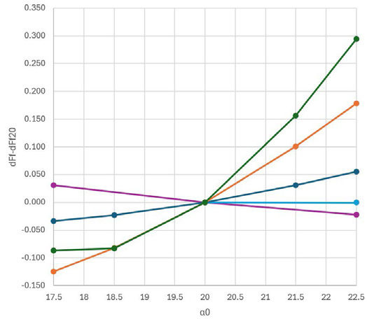

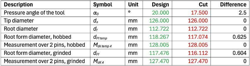

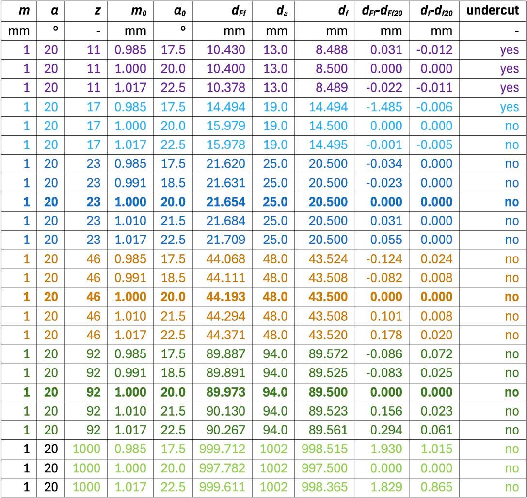

With the newly defined tools, gears with different numbers of teeth were generated. It was required that, for the same number of teeth, the gears must have at least the same tooth thickness and the same tip diameter (the root diameter cannot be imposed, having defined the hob).
The obtained results, especially the root diameter and the root form diameter, are indicated in Table 2. The cutting pressure angle α0 identifies the hob defined in the previous section.
Table 2—Gear data for different number of teeth <i>z</i> and different hob pressure angles
Table 2—Gear data for different number of teeth z and different hob pressure angles α0.

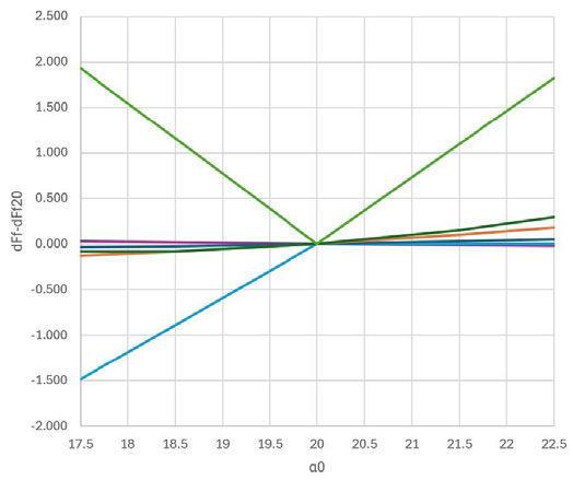

In Figure 4 (using the same colors), the difference between the obtained form diameter and that of the gear cut with the 20 degrees hob is shown for each number of teeth, for various hob pressure angles.
Figure 4 (top)
Figure 4—Variation of the root form diameter for different number of teeth z (see Table 2 for colors of z) versus hob pressure angles a0. In the upper plot the vertical scale is magnified between -0.15 and +0.35.
Figure 4—Variation of the root form diameter for different number of teeth z (see Table 2 for colors of z) versus hob pressure angles α0. In the upper plot the vertical scale is magnified between -0.15 and +0.35.
Analysis of Results
From the information presented in the previous clause, it can summarize that:
  • Although the tooth height was requested to be the same on all gears, with different numbers of teeth, the obtained tooth height is not.
  • The curvature of the involute flank is the same whatever the number of teeth.
  • The tool’s pressure angle affects the root form diameter of the cut gear, especially with a high number of teeth.
  • The impact of the tool’s pressure angle on the gear’s root diameter is often negligible, being two orders of magnitude smaller than its effect on the root form diameter (≈1/100).
  • If the tool’s pressure angle is greater than that of the gear, the root form diameter increases with the cutting angle, except in cases of undercutting.
  • For hob with pressure angles less than gear, the relationship is typically the opposite, although verification is advisable.

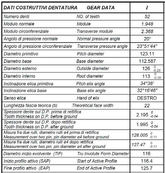

As a second case study, a 52-tooth HCR gear with a 20 degrees pressure angle for automotive use, cut with a hob and finished by grinding, was selected. High contact-ratio or HCR gears are gears defined with a contact ratio greater than 2.0 (Ref. 10), sometimes called also long-addendum gears. The drawing also indicated semi-topping and tolerances on diameters and tooth thickness. To simplify the study, calculations were done without considering tolerances on tooth thickness and diameters. It was chosen to position on the maximum tip diameter and average tooth thickness.
Comparison was made only between the case with a 20-degree hob (as per drawing) and 17.5 degrees (actual), on this gear. Then, an analysis was carried out on what happens when using this same hob with a 78-tooth gear, with the same reference profile and tooth thickness as the Z52 gear.
Z52 Geometry

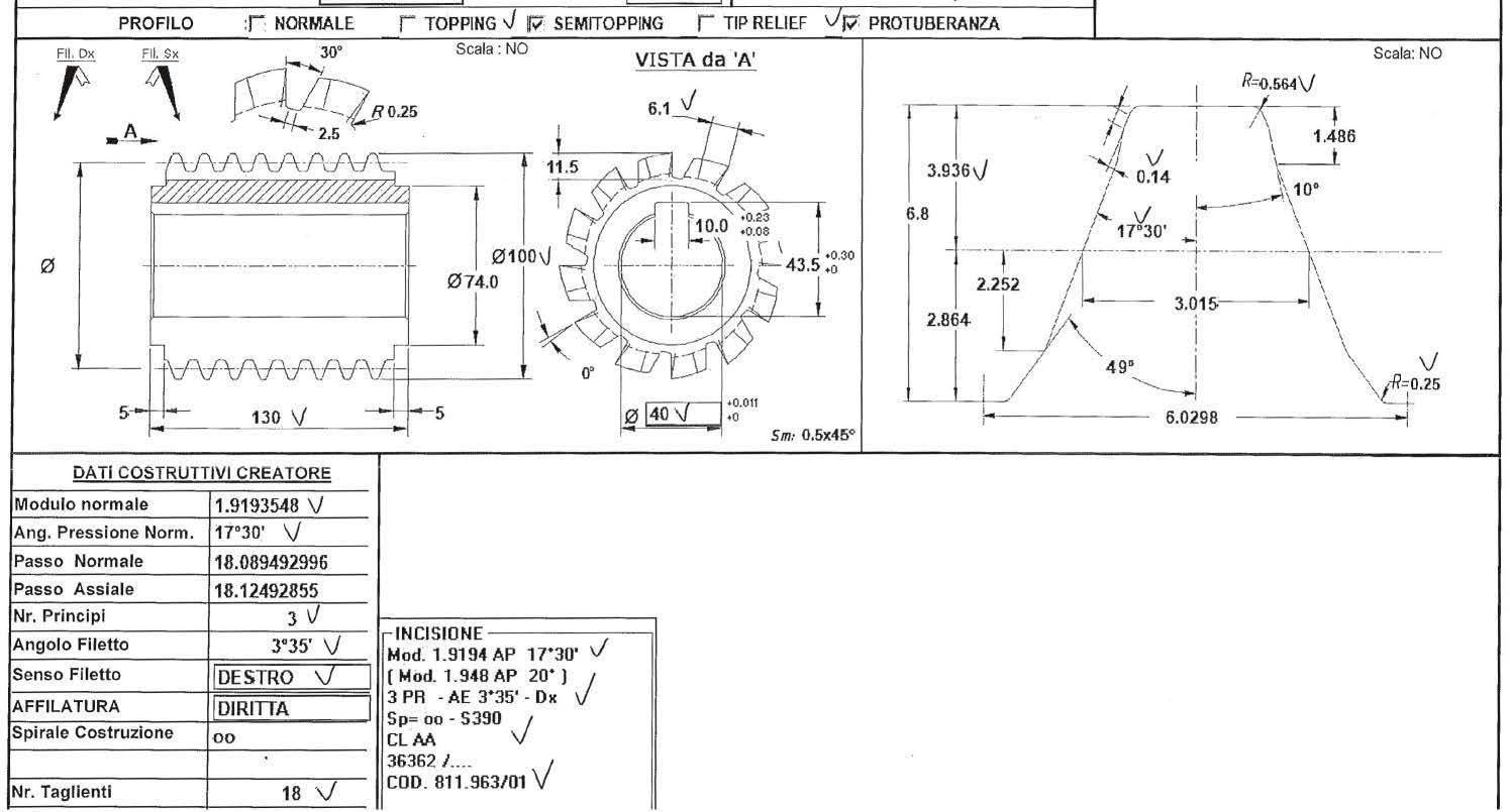

The gear in Figure 5 was cut with the hob in Figure 6, specially designed for this gear with a pressure angle less than that of the gear to reduce wear on the tip. The geometry of the obtained gear exactly reflects the requested one.
Figure 5—Table with data for gear Z52 from the gear drawing
Figure 5—Table with data for gear Z52 from the gear drawing.
Figure 6—The hob used to cut the gear Z52
Figure 6—The hob used to cut the gear Z52.

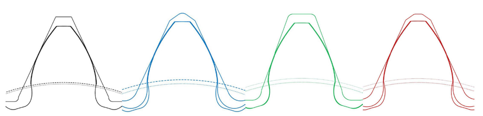

A comparison was made between the geometry obtained with the indicated hob and a hob with the same pressure angle as the gear and the same values of protuberance and protuberance angle as the previous hob.

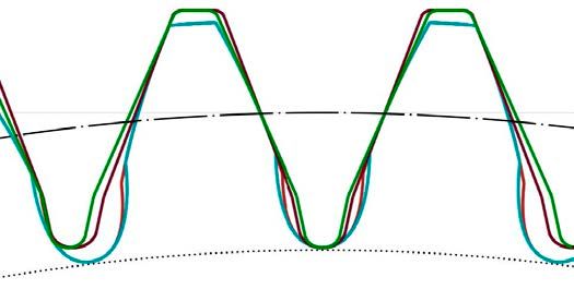

Figure 7 shows different geometries of the gear hobbed with a hob with pressure angle of 20 degrees in green and of 17.5 degrees in red. The involute profile is the same. In the same picture there are four elements: tooth form and hob profile for both cases. Involute profile is the same, root diameter is the same, but also after grinding, root form is different. In Figure 8 only hobs are shown.
Figure 7—Gear Z52 hobbing by hob with a= 20 degrees (green shades) and a = 17.5 degrees (red shades). The base circle is dotted. The dash-dotted circle is tangent to the reference line of the hob (the same in both cases).
Figure 7—Gear Z52 hobbing by hob with α = 20 degrees (green shades) and  α = 17.5 degrees (red shades). The base circle is dotted. The dash-dotted circle is tangent to the reference line of the hob (the same in both cases).
Figure 8—Hob with a= 20 degrees (green) versus a = 17.5 degrees (red).
Figure 8—Hob with a= 20 degrees (green) versus  α = 17.5 degrees (red).
It is evident that the use of a hob with modified rolling brings benefits to the root form diameter after grinding (Figure 9), which is lower. In fact, to avoid meshing interference, it is important that the start of contact occurs in the part of the tooth where the involute is. That is, it is important that the root form diameter is lower than active root diameter (SAP, Start of Active Profile): dFf < dNf.
Figure 9—Root form circle (dashed) after grinding for the gear Z52 hobbed by hob with a= 20 degrees (green shades) and a = 17.5 degrees (red shades).
Figure 9—Root form circle (dashed) after grinding for the gear Z52 hobbed by hob with  α = 20 degrees (green shades) and  α = 17.5 degrees (red shades).

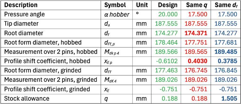

The same hob with a 17.5-degree pressure angle and protuberance was used to cut a gear with 78 teeth that had the same reference profile and thickness as the one with 52 just examined.
Complication arose due to the presence of the grinding step following the hobbing. Thus, two cases were examined: one with the same stock allowance also left on the Z52 gear, the other with the same root diameter as the design one. The results are shown in Table 4.

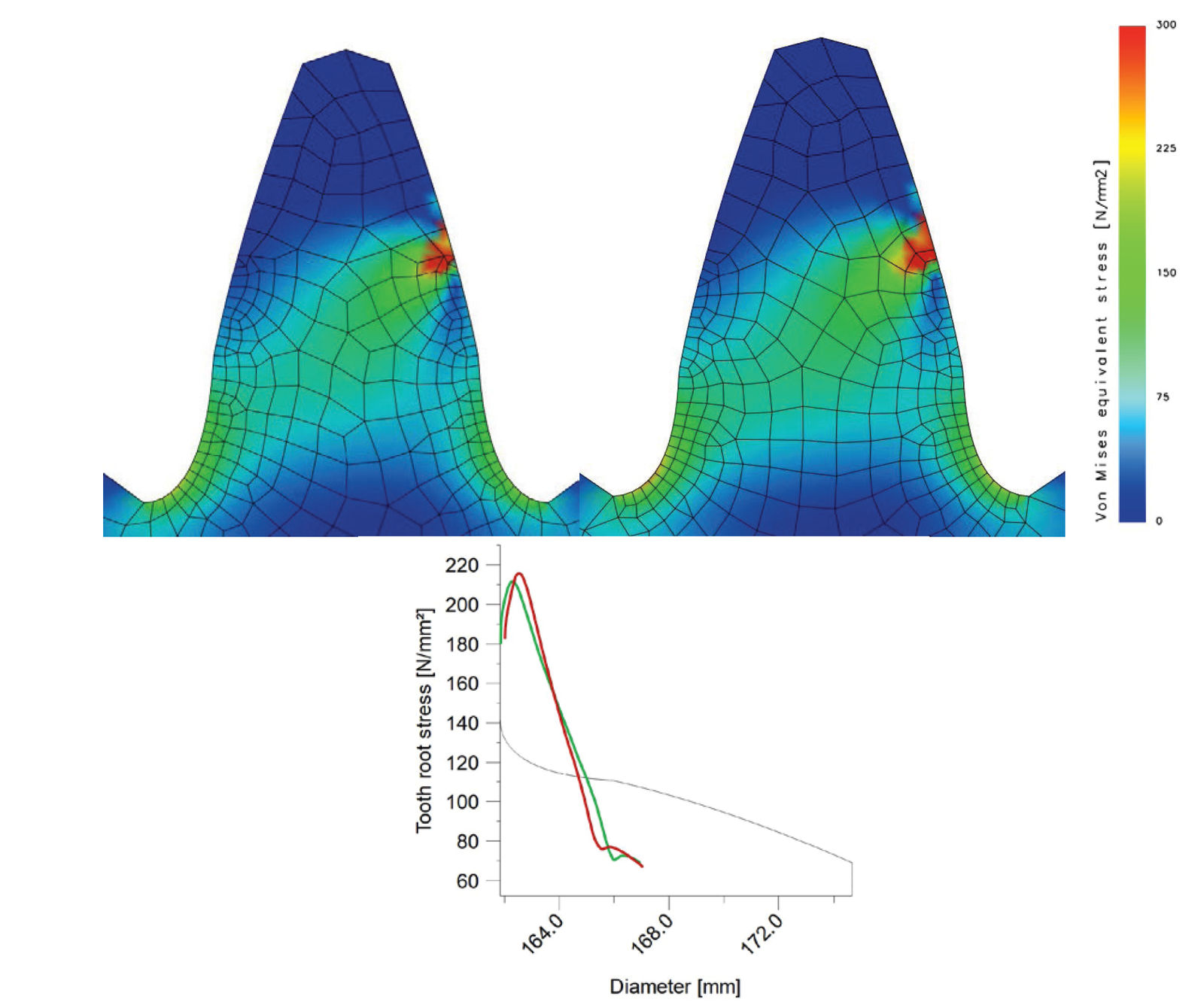

Although the scope of this paper focuses on production, it was deemed appropriate to investigate the consequences of modified rolling on tooth strength.
In both examined cases per gear Z52, the tooth flank shape is identical. Therefore, the contact pressure during operation is not affected by the production process with modified pressure angle, nor will it affect the resistance to macropitting.
The situation is different concerning the tooth root bending strength because the radius of curvature of root fillet is indeed different in the two cases.
The FEM solver of the same software used for all previous calculations was used. A pair of identical Z52 gears with face width b = 10mm in a 1:1 ratio was assembled, and an arbitrary load of T = 450 Nm @ 10 rpm was applied. The absolute value of the calculated stress is not important; rather, the comparison between the stresses at the tooth root between the two geometries is crucial.
The results shown in Table 5 and indicate another advantage in using a hob with modified rolling for this gear: there is not an effective reduction of stress at the tooth root.
Table 5—Stress on the gear Z52 hobbed with hob pressure angle 20 and 17.5 degrees.
With only one case examined, it is not possible to establish a universal rule regarding the relationship between modified rolling and changes in bending strength. As seen in the “Analysis of Results” section, it is also not possible to establish rules for geometry. However, it is interesting to note that the tooth strength changes depending on the production process, particularly based on the pressure angle of the hob.
Figure 10—Von Mises equivalent stress on the designed gear (hobbed with hob pressure angle 20 degrees, green) and cut gear (hobbed with hob pressure angle 17.5 degrees, red). KISSsoft images with kind permission by KISSsoft AG.

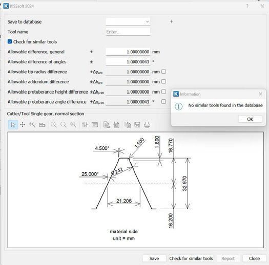

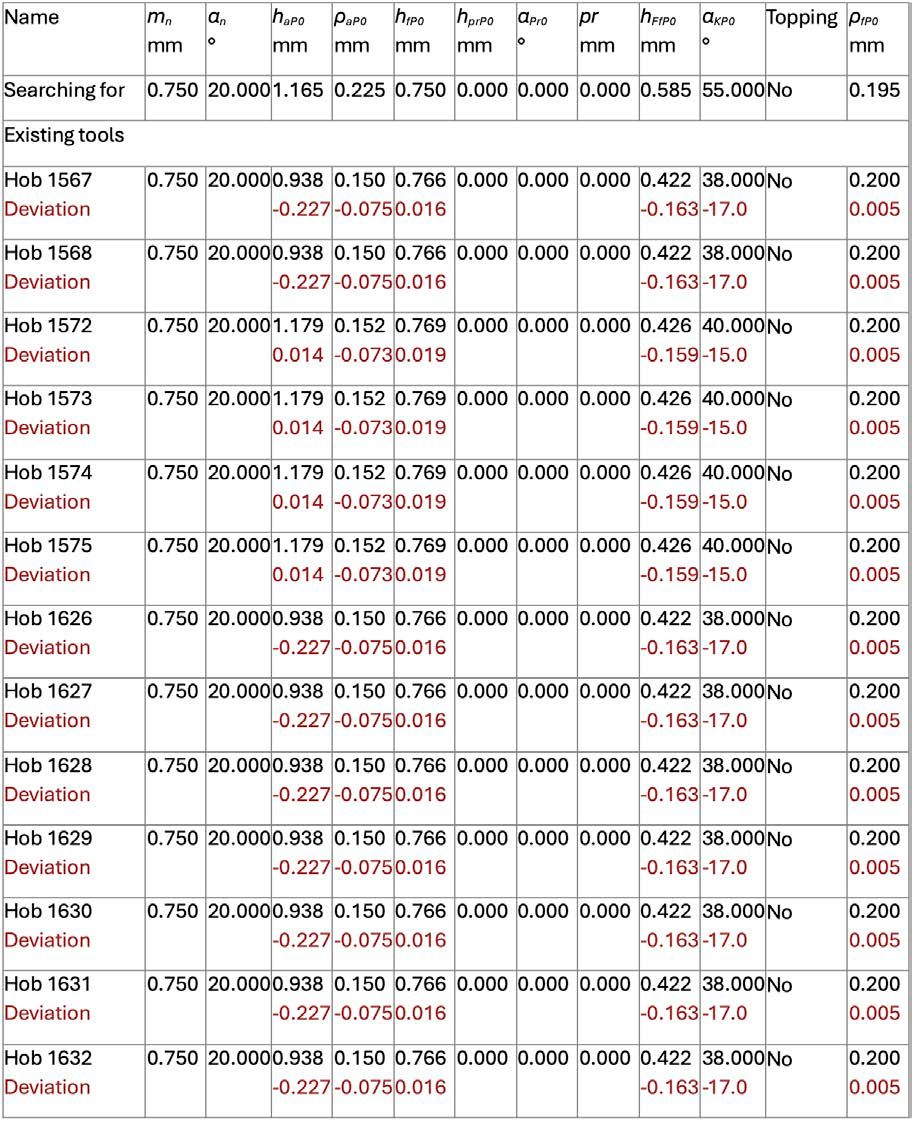

The gear data, including the required profile, were entered into the workshop’s calculation software (Figure 11). A search for suitable hobs was then conducted in the available database (Figure 11). It can be noted that the search can be extended by setting ranges for lengths and angles. The search results are in Table 7. Searching through a database of 850 records took only a few tenths of a second.
Figure 11—Windows with the definition of the profile designed for the gear Z30. KISSsoft image with kind permission by KISSsoft AG.
Figure 12—Window of the hob searching for the gear Z30. KISSsoft image with kind permission by KISSsoft AG.
Table 7—Result of the hob searching for the gear Z30 mn 0.75.
For this gear, the workshop did not deem it necessary to adopt modified rolling hobbing.

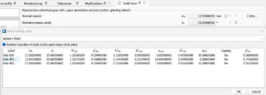

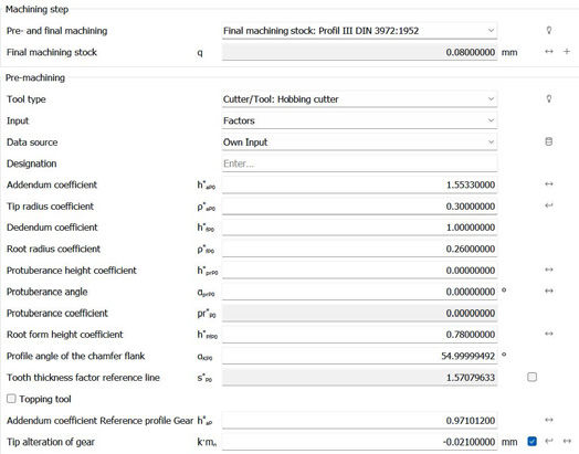

As in the previous case, after entering the gear geometry, a search was conducted in the current tool database to see if there was a suitable hob to cut the gear. The search did not yield any results (Figure 15 and Figure 16).
Figure 15—Window with the definition of the profile designed for the gear Z11. KISSsoft image with kind permission by KISSsoft AG.
Figure 16—Window of the hob searching for the gear Z11. KISSsoft image with kind permission by KISSsoft AG.

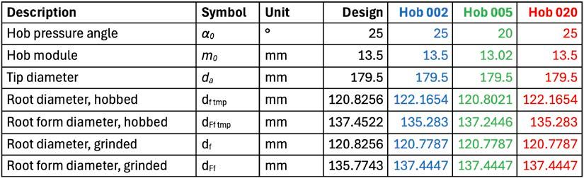

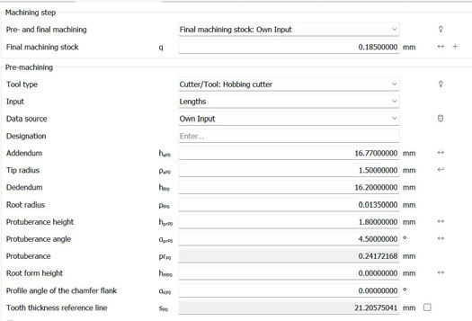

At this point, the decision was made to use modified rolling. In this case, there is no tool search feature like in the previous case, but there is the option to view all hobs that have the same base pitch as the gear with a tolerance of ±2 percent (Figure 17). The number of solutions found is fortunately small, so it is possible to calculate the three options individually. The results are in Table 10 and Figure 18.
Figure 17—Window of the hob searching for the gear Z11. KISSsoft image with kind permission by KISSsoft AG.
Table 10—Comparison for gear manufacturing of the gear Z11.

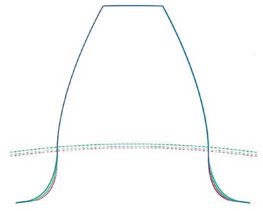

Figure 18—Comparison for gear manufacturing of the gear Z11: tooth form with and without stock allowance, base circle (dotted), root form circle (dashed) and hob.
Hob 002 and Hob 020 are very similar, only the root radius value ρfP0 are different, but these hobs are not for topping, so the tooth form they generate are identical.
Hob 005 has protuberance and a lower pressure angle than the gear.
The gear is manufactured by the Hob 005.

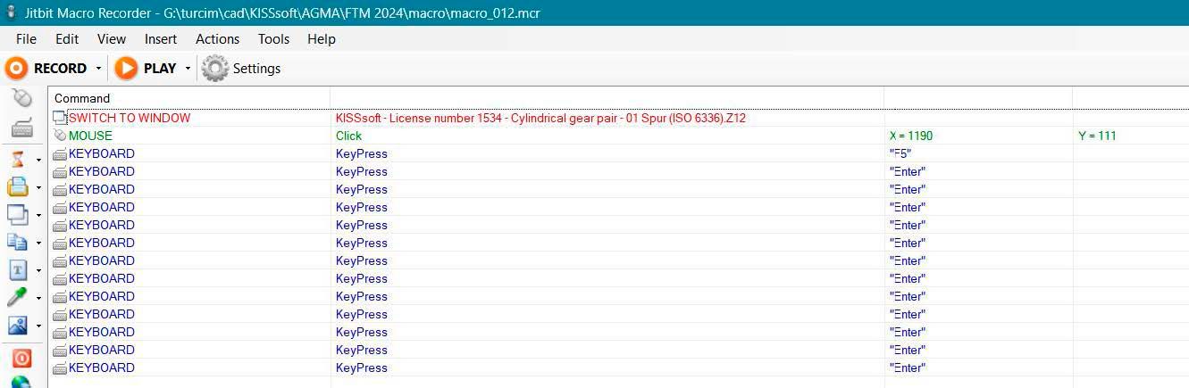

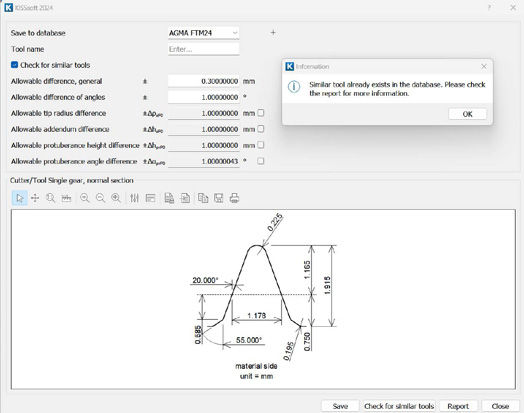

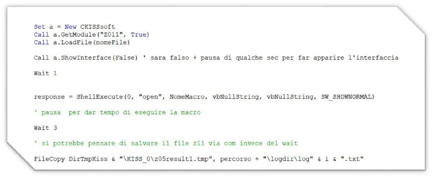

The list of hobs to be examined could have been very long (as in the previous example). Therefore, it was decided to automate the generation of Table 10 with a VBA macro in Excel. This macro, in turn, calls a Windows macro recorded on Jitbit macro recorder (Figure 19) that simulates the operations (mouse clicks) that the operator would manually perform for each row indicated in Figure 17.
Figure 19—Jitbit macro to run the tooth form calculation in KISSsoft.
  • The first line (in red) activates the KISSsoft window, where the file with the gear and the hob geometry are already defined.
  • The second line (in green) activates the “tooth form” window with the tool’s data.
  • The third line (in blue) performs the calculation using the F5 shortcut.
  • The remaining lines close any message or error windows that may appear when using an unsuitable tool by an ENTER key press.
In Figure 20 there is the portion of VBA code that calls this macro from Excel after inserting the tool definition into the KISSsoft file of the gear. In the Excel macro, there are “Wait” commands for the execution of operations on KISSsoft.
Figure 20—Part of the VBA macro code.
