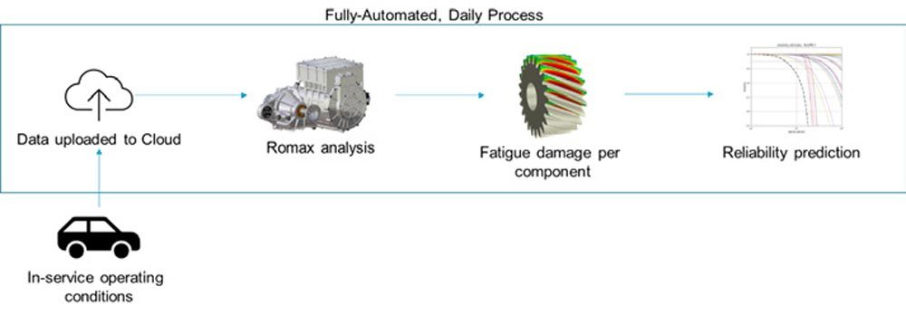

This provides the opportunity for a digital twin of the gearbox. Alongside Big Data and the Internet of Things (IoT), a digital twin is another phrase that is widely used, often misused, promises much, and usually under-delivers. What does it mean within this context?
Hexagon’s recent work (Refs. 2, 3) goes into the details of the origins of the term digital twin (Ref. 13) and the basis on which Hexagon uses the term in relation to others. In summary, the Hexagon digital twin is where the digital asset shadows the physical asset (the machine) during its in-service operation, extracting operational data and, potentially, feeding this back to the machine for performance optimization.
Figure 1—Overall workflow for Hexagon’s gearbox digital twin.
This is separate from a design twin, which is essentially a computer-aided engineering (CAE) model. However, there is a close relationship between a CAE model and an in-service digital twin. In the case of gearboxes, the digital twin was based on Hexagon’s Romax software, which has been used worldwide for gearbox design since its release in 1994. Meanwhile, data handling, processing, queuing, results plotting, etc. was handled by the various capabilities of Nexus, Hexagon’s open digital reality platform for manufacturing that is developed to provide connectivity and interoperability across all aspects of design, manufacturing, metrology, and in-service operation for all Hexagon’s client industries.
The work saw vehicle operational data uploaded to the Cloud where the Romax Digital Twin calculates fatigue damage and then predicts reliability for the gears and bearings. The reliability methods used were based on recommendations from the standards in the case of bearings and Hexagon’s best judgment from the literature search. Detailed explanation and justification of this is covered in Hexagon’s papers at 2023’s VDI International Gear Conference (Ref. 3) and AGMA Fall Technical Meeting (Ref. 2).

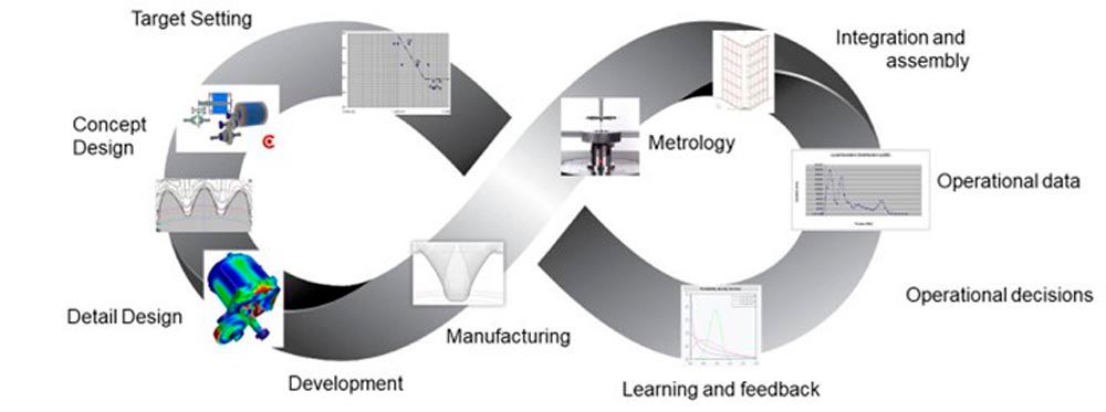

Adoption of the digital twin across a fleet of vehicles will provide sample sizes and confidence that will dwarf the approaches used to date to understand reliability. Often companies sign off on a gearbox design by rig testing a sample of prototype gearboxes prior to the start of production. This sample is small—somewhere around 5, perhaps a few more. Analysis shows (Ref. 17) that this actually provides very little confidence in the result. Even university research programs, on which the S-N curves of gear materials are based, extend to a couple of hundred samples, although FZG can point to a dataset of around 1,000 pitting and 1,700 bending test results for the common case hardening steels 16/20MnCr5 or 18CrNiMo7-6 (Ref. 18). This is all very good if you use one of these steels, but Hexagon has still seen large variations in results for 20MnCr5, for example, owing to variability of heat treatment and shot peening, factors which are defined by each manufacturer. By comparison, vehicle manufacturing companies could build up sample sizes running into the hundreds of thousands or even millions of gears.
This is not to say that rig testing before the start of production should be stopped, but rather that the processing of vehicle usage data and component failure data, combined across a sizeable fleet of vehicles/machines, could provide unprecedented accuracy in the ability to predict component fatigue and reliability.
Figure 2—Completed digital thread covering the life cycle of gears.
How would this all actually work? Recently (Ref. 17), Hexagon carefully stepped through the process for how a digital twin could automatically adjust the calculation such that the predicted failure rate matched the observed failure rate. This would not involve throwing away ISO 6336, or appending additional complexity to its calculation, but simply adjusting parameters such as application factor, allowable stress, and Weibull shape parameter. Note the change in emphasis from precision (adding complexity) to accuracy (making sure the predictions match the observation).

  15. James, B., Runkel, R., “Developing a digital thread linking gear design to manufacturing simulation and metrology,” VDI International Conference on Gears, Munich, 12 September 2022.
