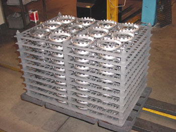

As in the case of liquid quenching, proper fixtures and optimized loading of the parts are also important for gas quenching. But contrary to liquids, fewer restrictions exist because there is no risk of quenching residue in the parts, such as with blind holes, for example. Alloy fixtures are widely used for grids in heat treatment. These grids have a rigid design and they have—as long as sufficient high-temperature-resistant material is used—an acceptable lifetime. However, these fixtures limit the net weight to be loaded due to the high fixture weight. After long-term service, the fixtures tend to deform due to high-temperature deformation, which has a negative effect on the distortion of the loaded parts. Moreover, due to the pick-up of carbon and the subsequent formation of carbides, the grids undergo dimensional growth, creating further problems during handling in automated, external transportation devices.
As an alternative, carbon-composite materials—CFC (chlorofluorocarbon), for example—were introduced for use as fixtures in heat treating applications, but with little success due to the liquid quenching process, risk of drastic wear during use in atmospheric pusher-type furnaces and their high price. On the other hand, vacuum carburizing furnaces with high-pressure gas quenching are perfectly suited for the use of CFC fixtures (Fig. 2). By way of walking beam transportation, any wear and overstressing of the fixtures are avoided. The use of oxygen-free hydrocarbons in a vacuum environment, and the inert quenching gases during the quenching process, avoid any surface reactions with the fixtures. In this service environment, one can take full advantage of the excellent material properties of CFC, which has a very high deformation resistance at high temperatures, low thermal expansion coefficient and very low specific weight. Fixtures made from CFC are designed to carry more parts, as they exhibit less gross weight, thereby increasing productivity and reducing energy costs. But the major advantage is that CFC fixtures do not show deformation during the heat treatment process, assuring optimum positioning of the parts. This has a significant, positive effect on part distortion, as shown later.
Figure 2—Load of internal rings on a graphite composite fixture.

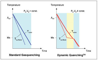

To further reduce distortion—particularly of thin-walled automotive parts—a quenching process has been developed where the quenching parameter’s gas pressure and/or gas flow velocity are varied during quenching (Fig. 3).
Figure 3—Schematic comparison of gas quenching process.
Dynamic quenching starts in the first quenching step with high quenching severity. After a period of time, when a certain part temperature is reached, the next quenching step follows where the quenching severity is reduced for a set time to allow for temperature equalization in the part. This is followed by a third and final quenching step, where the quenching severity is increased again until the end of the quenching process. The control system in the quenching chamber serves to provide differing steps of dynamic quenching with enhanced accuracy and reproducibility.
