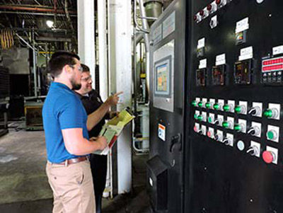

Q:Do you have a certified quality system in place – what accreditations do you hold?
It is important to understand how your heat treater’s quality system interfaces with yours. What data do they record and how is it used to control the quality of your product throughout the heat treat process?Are these controls appropriate for your application and do they satisfy the standards that your component must be designed to? Make sure you understand what quality system requirements your heat treater should meet. These will typically be dictated by the end user. Is CQI-9 compliance sufficient or is ISO or NADCAP certification required?
Quality audits are an important part of quality heat treating (courtesy of Applied Process).

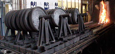

Q:Are you experienced in heat treating gearing?
Heat treating a forging or a piece of bar is one thing, heat treating gearing is another. Typically when the heat treater sees it, it’s semi-finished, meaning there are very few finishing operations to go afterwards. The heat treater has to be somewhat familiar with how to handle gearing. You just don’t throw it in a basket — you treat it with care and respect; you fixture it properly to try to minimize any distortion. So you want to find someone who has a certain level of experience.
There are different methods of hardening or heat treating parts. It depends on what’s required. Does [the customer] need induction hardening; does [the customer] need flame hardening; does [the customer] need it nitrided or nitrocarburized? A heat treater experienced with gearing should be well-versed in all types of heat treating as it relates to gearing. He may not offer all the processes, but he should be knowledgeable about them and be able to recommend someone who can.

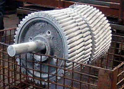

Q:Do you offer copper plating as a maskant?
Oftentimes — and this is strictly for carburizing — there are areas on the gear that don’t need to be hard. Many heat treaters will mask those areas off with a paint. Copper plating is 100% effective, while painting is probably 90% effective. Very few heat treaters offer plating, as well. Generally, they can recommend a good plater.
