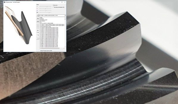

Dontyne Systems will promote the latest developments of GPS at IMTS. In recent years, the company has concentrated strongly on linking gear design to tool design and manufacture. An important part has been to produce complex gear forms at low cost on flexible multi axis machines. As wells as cylindrical gears, it is possible to produce straight and spiral bevels using standard end mill tools. The software has been adopted by many companies in the UK and beyond for low volume production and for R&D. A hypoid design option has been added for the current GPS 5.7 release. Interfacing to the Equator and Sprint devices from Renishaw has enhanced the ability to create a closed loop control system at low cost compared to dedicated gear machines.
Dontyne has also improved the hob/grind simulation for GPS 5.7, already in wider spread use worldwide, to manufacture Beveloid gear forms compatible with grinding machines such as those produce by Reishauer AG. The hob/grind functionality in GPS has been integrated to the Romax Technology system model software to confirm correct gear generation and define stable and safe production tolerances at the design stage. An interface exists from system model software of both Romax and Ricardo to GPS this to enable user to quickly and accurately export data to tool makers using Dontyne’s software whether in house or outsourced. The manufacturer can quickly check and take corrective action if required. The correction can be updated in the client while still in the design stage. There are significant savings to be made in avoiding mistakes during production.
There has been significant improvement to the skiving and honing simulations. This has included validation of gear tooth profile calculated by skiving simulation in GPS with software used internally by Kashifuji, Japan. Good correlation was seen in various cutting conditions including expected profile changes due to tool sharpening. The GPS project files can be utilized by tool makers using the Dontyne Machine Centre module reducing production times and the risk of inaccurate data transfer. Dathan Gauge and Tool, UK has been able to produce skiving tools more quickly and accurately by adopting the software while also improving communication with their clients.
