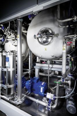

The EcoCDuty is provided with a new pre-degreasing feature using steam. This technology directs the oil-laden solvent straight into the distillation circuit, thus minimizing oil enrichment of the solvent and oil deposits in the flood tank for superior cleaning performance. This is made possible by a powerful distillation system capable of handling as much as 400 or even 500 litres/hour, depending on the solvent employed. The oil collected by distillation is automatically removed via the standard oil discharge system which has a capacity of four litres per hour. Customers who encounter high oil input rates can add a second unit, thus doubling the capacity of the oil discharged system to eight litres per hour. To remove particulate contaminants from the solvent as well, the distillation system is preceded by a filter unit with bag or cartridge filters. This system further contributes to the good cleaning result and prolongs the service life of the solvent.
On EcoCDuty versions with a flood tank, quick flooding and draining of the work chamber and tank is ensured by powerful frequency-controlled pumps. This technology reduces non-productive times and speeds up cleaning processes, thereby reducing costs. Furthermore, these versions comprise a separate filter circuit for each tank. Full-flow filtration of the solvent is provided in the supply and return flow lines by means of three filter units per flood tank. These can be fitted with bag or cartridge filters. As a result, even exceptional cleanliness specifications can be reliably met.
When designing the EcoCDuty, Dürr Ecoclean placed great emphasis on low operating costs and high availability. This starts with the new 7 inch color display with self-explanatory pictographs that makes the cleaning system simple, safe and quick to operate. The stainless steel flood tanks have a smooth surface and come without internal heating components. This design prevents the formation of chip and dirt pockets which could re-contaminate the parts. Customers who do not yet own a steam heating source can order an optional external steam generator to heat the distillation unit. The flood tanks are heated exclusively by waste heat from the distillation system, i.e., no additional energy input is necessary.
