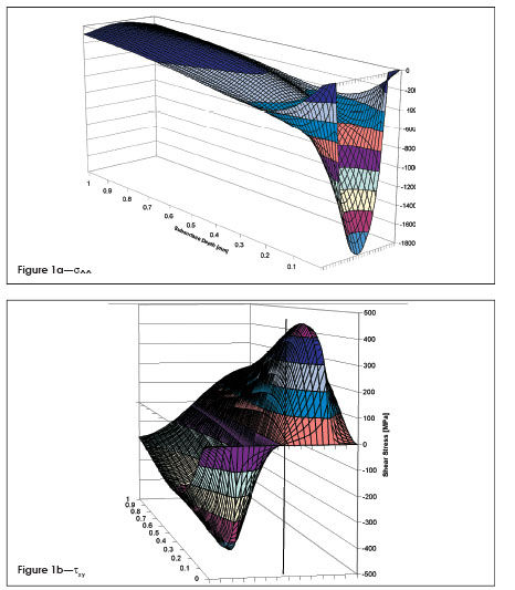

The three-dimensional sub-surface stress field. In order to understand the failure of material under RCF conditions, it is important to understand the complex three-dimensional stress field caused by elastic deformation of the contact zone. The stress field (in terms of maximum contact pressure) is calculated in real arithmetic using a software package (Refs. 5, 6). Figure 1 shows as an example the three dimensional stress field under line contact in the x-direction (σxx is shown in Fig. 1a) and the shear stress (τxy is shown in Fig. 1b) calculated in the contact zone of the ZF-RCF test rig using the following parameters:
1. Contact pressure = 1,800 MPa
2. Radius of test specimen = 15 mm
3. Radius of load roll = 35 mm
4. Young’s moduli = 206 GPa
5. Poisson’s ratio = 0.3
6. Coefficient of friction f = 0
Figure 1—Subsurface stress field due to Hertzian contact pressure.
The contact force produces a complex three-axial stress field within the material (σyy and σzz show similar sub-surface stress distributions as σxx). Only at the line of contact at which τxy = 0 are the stress components identical to the principal stresses σ1, σ2, σ3. Otherwise, magnitude and direction of the principal stresses change at every point. It must be emphasized that all components of the stress tensor are negative (compressive), with the exception of the shear stress, τxy, which is positive before the line of contact and negative thereafter.
From the viewpoint of fatigue, there are several ways to convert the multi-axial stress field into appropriate failure criteria:
1. Calculating yield criteria such as von Mises (distortion-energy) or Tresca (maximum shear stress), and using the maximum and minimum stress (= 0 in RCF) to calculate stress amplitude and mean stress (Refs. 6, 7).
2. Finding the maximum and minimum shear stress at every sub-surface point and calculating shear stress amplitude and mean stress (= 0 for f=0 due to symmetric shear stress).

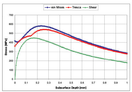

Figure 2 shows the comparison of all three criteria as a function of sub-surface depth. All three criteria show a similar sub-surface distribution with a maximum stress between 0.15 and 0.3 mm. Differences occur especially at the surface, at which the shear stress is zero. Von Mises and Tresca stresses are compressive stresses (R = infinity); stress amplitude and mean stress would be half of the calculated data. The shear stress represents the amplitude with σmean = 0 (R = –1).
Figure 2—Comparison of Failure Criteria–1,800 MPa f=0.
The sub-surface stress distribution, the position and width of the area of maximum sub-surface stress, and therefore the volume of material exposed to the highest stress, are affected by the type of contact (point, elliptical, and line), the relative curvature of the bodies in contact, the Young’s moduli, and the contact pressure. This is different from most conventional fatigue tests, in which the point or volume of maximum stress is almost independent of the load level. This difference can play an important role for RCF strength under variable loading conditions.

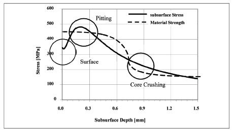

Failure Modes Under RCF Loading
Figure 3 illustrates the three most important failure modes for RCF conditions (Refs. 13, 14):
1. Surface-induced cracks. There are two different cracking modes possible:
a) Surface cracks, which usually grow according to the shear component at 30° into the material.
b) Micropitting or gray-stained areas at which many very small surface cracks form. Micropitting most frequently occurs in surface-hardened steels in the regime of mixed lubrication. If lubrication is restored, micropitting may arrest; otherwise micropits may grow and damage the material.
2. Sub-surface cracks are usually formed in the region of the highest von Mises stress. They first grow parallel to the surface and turn toward the surface, forming the pitting.
3. Core crushing or sub-case fatigue (which should not be confused with sub-surface cracking) occurs deep within the material and is usually caused by insufficient heat treatment.
Figure 3—Failure modes in RCF.

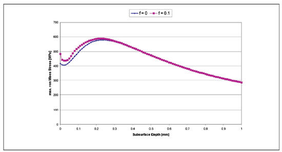

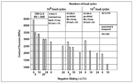

Surface Friction and Sliding. Surface shear stress due to relative sliding and friction affects the sub-surface stress distribution. The shear component τxy becomes asymmetrical with regard to the line of contact. The stress components σxx, σyy, σzz in the line of contact are no longer principal stresses. The amplitude of the shear stress is only affected in the near surface region, but the stress ratio shifts into more negative values (from R=–1 to R =–1.3 at 1,800 MPa, f = 0.1). The maximum von Mises stress (Fig. 4) increases, shifts out of the line of contact, and moves closer towards the surface. The surface stress is also increased and can exceed the magnitude of the sub-surface stress at higher coefficients of friction (f >0.3).
Figure 4—Comparison maximum von Mises stress, with and without friction.
Sliding in gears occurs at every point of the line of contact except at the pitch point. Sliding is positive in the addendum and negative in the dedendum of the tooth profile (Ref. 9). Experience shows that most pitting occurs in the dedendum of teeth at negative sliding (Refs. 13–15). There is only one comprehensive research program that determined the RCF strength of different materials at different sliding ratios (Ref. 16). Results confirm that the RCF strength is reduced by sliding and is leveling off at about –24% (Fig. 5). Due to the fact that the tests were carried out under full EHD lubrication and the coefficient of friction was below f = 0.1, the decrease in RCF strength cannot be explained by the change of the sub-surface stress distribution alone.
Figure 5—Effect of sliding of RCF strength of gear materials (Ref. 16).

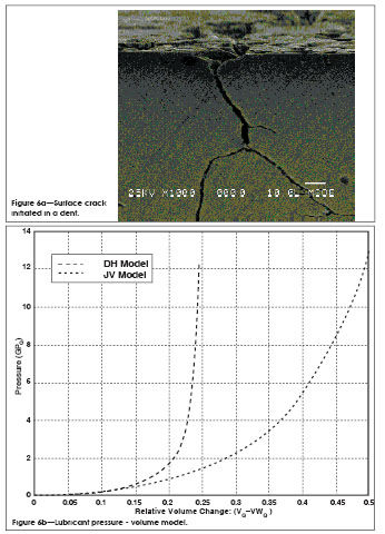

Surface Topography. The surface topography affects the RCF strength by an inhomogeneous distribution of the contact pressure over the contact area. There is a higher pressure in high asperities that can lead to localized plastic deformation and crack initiation. Secondly, if lubricant is trapped in surface pockets during over-rolling, i.e., if the dimension of the pocket is small relative to the patch width, the lubricant is compressed by the elastic deformation of the surrounding material, producing a high hydrostatic pressure within the pocket (Fig. 6 a and b) (Ref. 17). Grain boundaries within the pocket are sites for crack initiation. PM materials may additionally be affected when the manufacturing process leaves surface porosity.
Figure 6—Effects of trapped lubricant in surface dents.

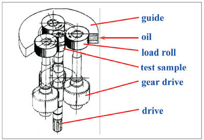

The RCF Test Bench
The RCF test rig used in this program was developed by ZF Friedrichshafen, Germany, in the early 1960s in order to study RCF at test conditions that simulate live gear contacts. The rig was used in extensive research programs in Germany in connection with the Gear Research Institute of the Technical University in Munich (Refs. 16, 23–25) and was used for the first study of RCF strength of PM steels (Ref. 26). A detailed description of the test rig has been published (Refs. 13, 26, 27).
Figure 7 shows the basic principle of the RCF test rig. The test sample is located in the center of the machine and loaded by three load rolls. The contact force is applied by hydraulic pressure of the lubricant, which furthermore provides the required amount of oil to produce full EHD lubrication in the contact zone. By changing the gear ratio of the gear drive, the relative velocity of the load rolls in regard to the test specimen (the sliding ratio) can be easily varied within a wide range.
Figure 7—Principle of the RCF test bench.
The test rig offers features that make the unit especially feasible for model testing of materials for gear applications:
1. The design allows cylindrical test surfaces, resulting in line contact, which is normal in gears. If required, crowned test samples can be used, resulting in elliptical contact. The cylindrical surface allows testing of original, native surfaces that are manufactured using the same gear manufacturing process. Due to the fact that the surface topography becomes more and more important, including the actual surface topography is an essential part of model testing. The surface becomes even more important for manufacturing processes, such as PM processes, that produce a unique surface structure.
2. Establishing full EHD lubrication is essential for determining the real material RCF strength, and doing so excludes additional effects such as uncontrollable surface friction and wear.

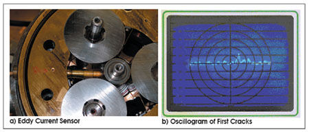

3. Full EHD lubrication is also a necessary condition to use crack detection technologies. The test rig used in this program is equipped with an eddy current sensor (Fig. 8), which allows the detection of cracks in the very early stage of nucleation (Refs. 3, 15). Therefore, the failure criterion used is the initiation of first cracks.
Figure 8—Eddy current technology used with the RCF test bench [Refs. 3,15].
4. Eddy current technology allows the monitoring of crack growth. However, there is no direct correlation between the actual size of the flaw and the magnitude of the eddy current signal. Therefore, calculation of crack propagation rate uses a modified Paris’ equation in which the actual eddy current signal indicates flaw size (Refs. 3, 15).
5. The eddy current technology can be used to determine the threshold for crack growth. By pre-cracking test specimens, stepwise reducing the load, and monitoring the eddy current signal, the contact pressure can be determined at which the crack stops growing (Ref. 3). If such a threshold exists, it could be assumed that it represents the true endurance limit of the material, and that contact pressures below that level do not contribute to the damage sum and can be dismissed in reliability calculations and/or tests under variable loading conditions.
6. The machine is equipped with a variable drive, which allows testing samples at different surface velocities. The standard speed is between 3,000 and 3,600 rpm, which results in 540,000 to 648,000 load cycles per hour.
7. The load is controlled by hydraulic pressure. Changing the level of contact pressure can be done automatically using a servo-hydraulic control valve. This allows tests under variable loading conditions to simulate real operational conditions.
8. As is common with every RCF test rig, the ZF-RCF test bench is equipped with a vibration sensor that shuts off the machine when pitting leads to excessive vibration of the machine. Therefore, tests up to the occurrence of the final, catastrophic failure can be performed.

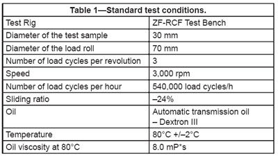

Table 1 summarizes the standard test conditions used for the test programs included in this paper.

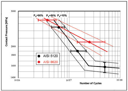

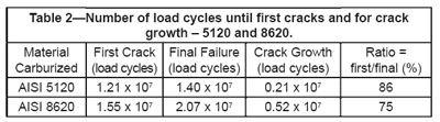

AISI 5120 and AISI 8620 Carburized. Both wrought steels are very common materials used in today’s automotive transmissions, and performance of both materials under operational conditions is well known. Therefore, both materials can serve as benchmark material in RCF investigations. Other materials and/or processes can also be benchmarked.
Figure 9—S-N curves of benchmark materials (AISI 5120 and 8620).
Figure 9 contains the S-N curves of both materials for final pitting. In the time life region, five test samples per load level were used. A staircase test with 15 specimens has been performed at AISI 5120 and 50 million load cycles. To determine test data scattering, data were plotted in a log-normal diagram and the number of load cycles for probability of survival of 90% and 10% determined graphically. The scattering can be expressed in terms of the probability of survival by
Equation (1): TN = 1: T10% / T90%
with:
TN = Factor for the scattering of the number of load cycles.
T10% = Number of load cycles for 10% probability of survival.
T90% = Number of load cycles for 90% probability of survival.
Using the eddy current technology, the number of load cycles for the occurrence of first cracks has been determined for both the materials at a contact pressure of 2,100 MPa. The results are given in Table 2.

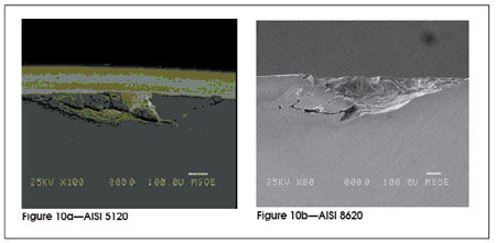

The analyses of the first cracks (Fig. 10) reveal that, in both cases, the failure is surface initiated. The cracks show the typical crack growth at 30° from the surface and branching toward the surface. The cracks propagate until they reach the region of maximum sub-surface stress and turn horizontally, forming the pitting by branching toward the surface. The failure mode indicates that the surface topography plays an important role and that the true RCF strength of both materials may be higher.
Figure 10—SEM pictures of first cracks.

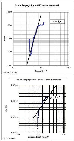

The crack propagation rate (Fig. 11a & b) is very comparable to crack propagation in tension. The Paris’ exponent, which represents the slope of the log (da/dN) vs. log (ΔK) plot, is within the range of wrought materials under tension. That might be an indicator that even at the compressive stress field, tension stresses may be responsible for crack growth. More research is necessary, however, to generalize those findings.
Figure 11—Crack propagation rate.

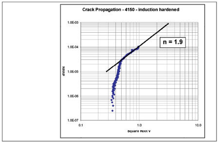

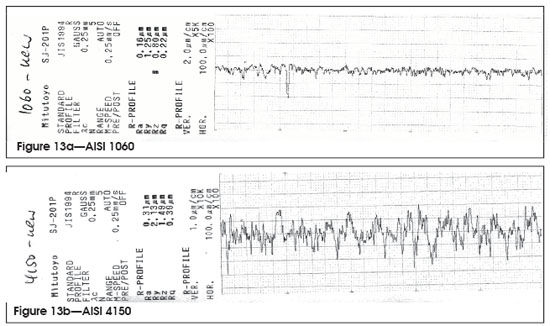

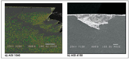

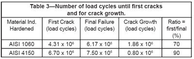

AISI 1060 and AISI 4150—Induction Hardened. Induction hardening is a second heat treatment to produce favorable surface conditions for RCF applications. Due to the higher carbon content of the material, the core hardness might be higher compared to carburized steel, and the case depth is deeper as well. Both materials were tested at a contact pressure of 2,100 MPa. The number of load cycles for the first crack and the final pitting are shown in Table 3.
As can be seen from Figure 12, AISI 1060 fails by initiating sub-surface cracks at the region of the highest sub-surface stress, while AISI 4150 shows a surface-induced crack that turns horizontally at the region of maximum sub-surface stress. The surface profile (Figure 13) indicates that the surface roughness may play an important role in the failure mode. Figure 14 shows that the crack propagation rate (expressed by the Paris’ exponent) of the investigated materials is also within the range of those typically experienced under tension loading.
Figure 12—SEM pictures of first cracks.
Figure 13—Surface Profile Before Test.
Fig. 14a—Crack propagation rate. AISI 4150 at 2,100 MPa.

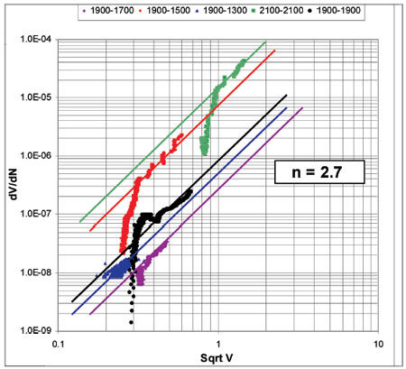

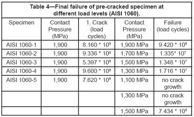

AISI 1060 was tested for the threshold for crack growth. Pre-cracked specimens (at 1,900 MPa) were tested at lower load levels, the crack propagation was monitored and the number of load cycles before final failure was recorded. Table 4 summarizes the results. Figure 14b shows the crack propagation rates at different load levels.
Figure 14b—Crack Propagation Rate. AISI 1060—different load levels.
There are some very important conclusions that can be drawn from the test results:
1.There is a threshold for crack growth. There was no crack growth for more than 10 million load cycles at 1,100 MPa. This threshold level is surprisingly high.
2. After running the test at 1,100 MPa, the load level was increased stepwise until renewed crack growth could be seen. The load increased by two steps before crack growth occurred. It seems as if load levels at or below the threshold lead to compressive residual stress at the crack tip, which would explain the incubation time for renewed growth.
3.The crack propagation rate at all investigated load levels is very similar and independent of the load itself. This may be another indication that the crack growth is actually governed by tension stresses at the crack tip.
