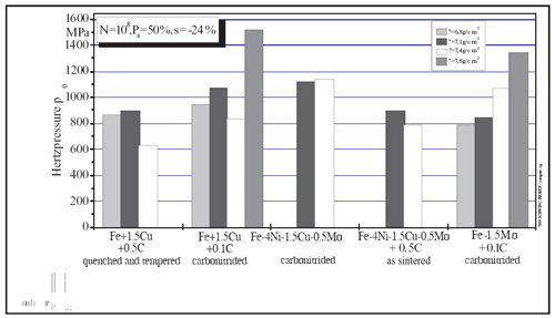

Experimental Test Results. There is only one test program that determined the RCF strength of PM materials at different densities under full EHD lubrication, with and without sliding, and line contact using the ZF-RCF test rig (Refs. 26, 38, 39). The results indicate a small increase or even a decline in RCF strength when the density is in the range at which the open pore structure changes into closed and isolated pores (Fig.15).
Figure 15--RCF strength of PM steels at different densities (Ref. 38).
It shall be noticed that materials that show the largest drop contain copper that is added to the powder mixture as elementary powder. The copper particles melt before the sintering temperature is reached, leaving pores behind. Which role the additional pores play in the decrease of RCF strength is not understood yet. The reduced strength, however, may have some important consequences for porous PM materials used in RCF applications:
1. It may affect the trend in the PM industry to produce parts at higher densities. If a material is susceptible to surface failure due to isolated, open pores, it may be advantageous to avoid the close pore structure and to maintain an open pore structure.
2. To maximize RCF strength, full density processes are necessary, with special emphasis on surface topography and surface porosity.

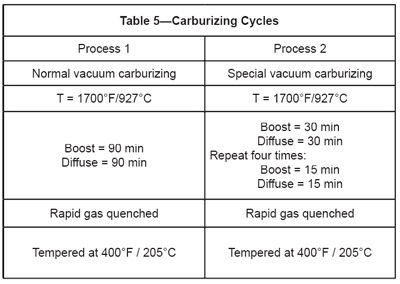

Effect of Carburizing Cycle
The standard way of case-hardening steel by carburizing contains two cycles:
1. Increased carbon potential in the carburizing atmosphere for a certain period of time (boost cycle).
2. Reduced carbon potential in the atmosphere to allow carbon to diffuse into the material (diffusion cycle).
For case carburizing transmission gears, the automotive industry often uses special heat treatment cycles which contain multiple boost and diffusion cycles. Two different surface-densified PM steels were heat treated using the single- and the multiple-boost/diffusion carburizing cycles. Table 5 contains the process parameters of both carburizing heat treatments.
Figure 25 shows that the effect on surface-densified PM steel is marginal. Crack initiation analyses revealed that different failure modes occur in the different materials:
Figure 25--Effect of different carburizing cycles on RCF strength.FLN2-4405 and Ancorsteel 4300, both by Hoeganaes Corp. (Ref. 47).
1. FLN2-4405-process 1: Subsurface cracks and dominant subsurface crack growth.
2. FLN2-4405–process 2: Mixed failure modes–surface and subsurface, dominant subsurface crack growth.
3. Ancorsteel 4300–both processes: Surface-initiated cracks which grow deep into the material, far below the maximum subsurface stress (see Fig. 26).

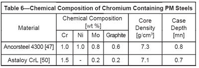

Two different chromium-containing materials produced by two different powder manufacturers were included in this program. Table 6 summarizes the chemical composition and major process parameters of both materials. Figure 29 shows the S-N curves of both materials.
Figure 29--RCF strength of chromium-containing, surface-densified PM steels.
At first glance, it seems as if Astaloy CrL is superior to Ancorsteel 4300 (Ref. 29). The 3-D maps of the first cracks (Fig. 30) reveal that Ancorsteel 4300 fails by surface-initiated cracks, while Astaloy CrL shows subsurface cracks. Therefore, the real RCF strength of Ancorsteel 4300 may be higher if surface cracks could be avoided; the material simply is not utilized to its maximum strength due to premature failure by surface cracks.
Figure 30--3-D CAD maps of first cracks in chromium-containing PM steels.
