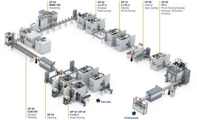

The "assembled" rotor shaft is an impressive example of this flexible approach. EMAG was asked to develop a multi-stage production system that would combine soft machining, laser welding, hardening and hard machining. In addition, the shaft is assembled during the process from two different end pieces – a basic principle that is known, for example, from assembled camshafts. The procedure can be broken down into short and partially parallel sub-processes - this approach often gives component developers more freedom. The shafts are finished with perfectly timed cycles: In the first two operations (10 and 20) the two different blanks are machined inside and outside, creating the hollow internal geometry.
Four EMAG VL 4 pick-up machines are used for this. After a cleaning process (OP 30) the end pieces are joined together in an EMAG ELC 250 machine by laser welding (OP 40) – an extremely fast and safe process. The precisely controlled, concentrated energy of the laser beam allows high welding speeds and involves a minimum of distortions on the welded component. Next, the bearing seats are hardened in a matter of seconds and with high precision in the MIND 750 induction hardening machine by EMAG eldec (OP 50). Hard machining of the shaft starts with external turning in the EMAG VT 4-4 pick-up machine (OP 60) and internal turning in the modular VL series (OP 70). OP 80 and 90 consist of gear-cutting the shaft and finish-turning various shoulders on the outside. The finishing with close tolerances and high demands on surface quality is provided by the final grinding process on a vertical shaft grinding machine of the VTC series (OP 100).
The shaft is then ready for joining with the corresponding laminations. The EMAG automation technology, which ensures transport between the machines, is adapted to customer requirements. For example, line gantries, stacking cells, accumulation conveyor belts or the EMAG proprietary TrackMotion system can be used. In any case, the system benefits from the standardization of all machines and their optimized interfaces. The customer benefits from a complete solution in the form of a comprehensive system and EMAG as the only contact needed during planning, implementation and service. In addition, the EMAG proprietary pick-up technology ensures speed in the process flow:
The shaft (or its two separate components at the beginning) is transported into and out of the machining area with a movable workpiece spindle. The vertical turning and milling process is then performed at high cutting speeds with optimized chip flow.
About every 45 seconds a finished rotor shaft leaves this line. Unwanted idle times are reduced to a minimum.
