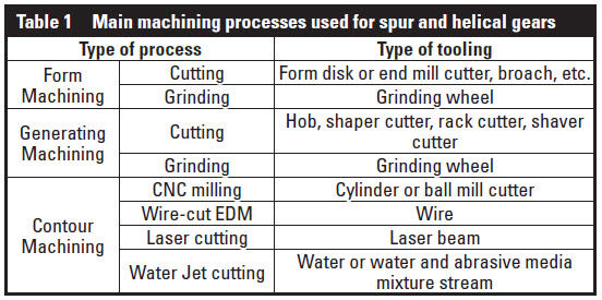

When compared with the traditional gear design approach — based on pre-selected, typically standard generating rack parameters — the alternative Direct Gear Design (Ref.1) method provides certain advantages for custom, high-performance gear drives. Among them are increased load capacity; efficiency; length-of-service; reduced size and weight; noise/vibrations; and cost. However, the manufacture of such non-standard gears requires custom tooling and certain alterations of known gear fabrication processes.
This paper presents specifics of application main methods of gear fabrication, i.e. — form and generating machining (cutting and grinding); gear forming injection molding technology; net forging; powder metal (PM) processing; die casting; and wire EDM gear prototyping. It also describes tooling profile definition, dependent upon the selected gear fabrication method. It presents the Genetic Molding Solution technique for compensation of differential warpage and shrinkage for plastic injection molding tooling — that enables enhancement of gear accuracy and shortens the process development cycle.

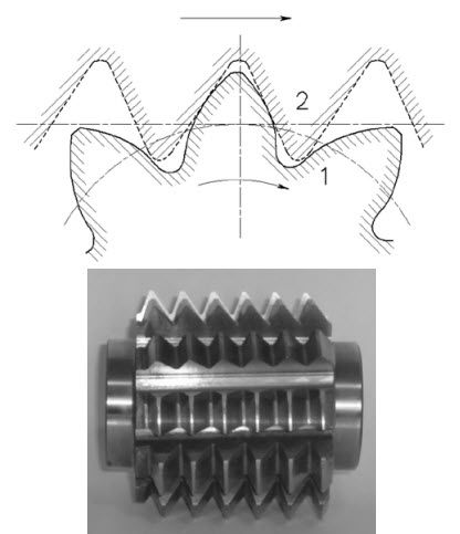

Generating machining. Schematics of the rack generating gear cutting or grinding process are shown in Figure 4. In this process a gear blank and tool are engaged in a mesh, and all gear teeth are machined practically simultaneously. In traditional gear design the tooling (a hob or rack cutter) profile is determined early on in the gear design procedure. In combination with its position relative to the gear center (addendum modification or X-shift), the tooling rack profile defines the gear tooth and whole gear profiles.
Figure 4 a. rack generating: 1) gear profile; 2) hob or rack cutter profile; b. asymmetric gear hob cutter.
Direct Gear Design applies a different approach. The optimized gear tooth and whole gear profiles are described without use of any redefined tooling rack parameters. Next, the reverse-generating technique is applied to find the tooling rack profile, using the known gear profile. This technique assumes that in the rack/gear mesh, every point of the gear tooth profile has its mating point on the rack tooth profile. Figure 5 illustrates how the tooling rack profile point At position is defined from the gear tooth profile point At position. In order to find the generating rack profile point At corresponding to the gear tooth profile point Ag, the line AgBg perpendicular to the tooth profile in the point Ag is constructed. The point Bg lays in an intersection of the line AgBg with the gear pitch circle. The gear tooth profile and line AgBg are rotated on the angle Xg, relative to the gear center until the point Bg reaches its pitch point position Bg', where the gear pitch circle 3 is in tangent with the rack pitch line 4. Then the point Ag is in the position Ag' where the gear tooth profile 1' is tangent to the rack profile 2'. The line Ag'Bg' is moved parallel to the rack pitch line 4 on distance Bg'Bt that is equal to the length of the arc BgBg'. This movement puts the point Ag' in position At at the rack profile that is corresponds to the point Ag at the gear tooth profile. This approach allows for the defining of any generating rack profile point that is related to a certain gear tooth profile point.
Figure 5 Generating rack profile definition: 1 and 1' - gear profile positions; 2 and 2' - rack cutter profile positions; 3 - gear pitch circle in mesh with rack; 4 - rack pitch line in mesh with gear.

Contour machining. Contour machining (Fig. 8) is not a highly productive gear fabrication method; but, unlike form or generating machining, it does not require special tooling. This makes it very useful for gear prototyping and the quick fabrication of a relatively small quantity of gears.
Figure 8 a. schematic of contour gear machining: 1) gear profile; 2) cutting tool; 3) cutting direction; b. wire EDM gear cutting.
The contour gear machining processes include CNC milling, wire-cut EDM, laser cutting, water jet cutting, etc. In many cases, in order to achieve higher accuracy and surface finish, the contour machining process may require several passes, with the final pass removing just a small amount of material. While most of these processes are used only for spur gears, the CNC ball cutter milling can be used for helical gears as well. The contour cutting path (Fig. 9) is defined with off-set S from the nominal (average material condition) gear profile. This off-set contains one-half of the cut width Wc and some additional off-set that depends on the machining process. The additional off-set may include a stock for final machining, over-cut or over-burn (for wire EDM and laser machining), and/or a defective layer that should be removed by a tooth surface treatment operation; e.g. — polishing.
