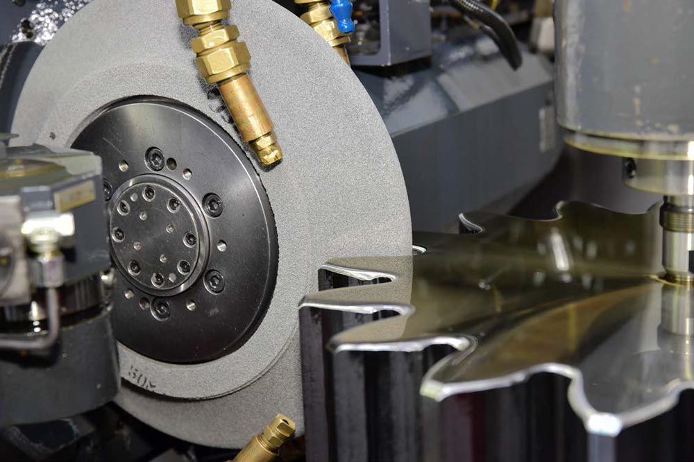

Gear tooth profile grinding, also known as form grinding, is a finishing method used in gear manufacturing. It involves the use of vitrified bonded grinding wheels to modify or correct the profile of gear teeth, often after heat treatment. The grinding wheel runs between two opposing teeth, grinding both surfaces at the same time.
Compared to gear cutting, this process is known to provide a more accurate tooth finish and offers more versatility because of its ability to make a specific, unique profile or to make profile corrections by dressing the wheel with the required corrections or modifications. In most applications, a type 1 or type 4 wheel is used. The machine and gear geometry will determine the size of the wheel.
Profile grinding is used to grind internal and external gears and allows for unique versatility. It can be used on gears that have clearance issues that do not allow for other grinding processes like continuous generating gear grinding. Typically, profile grinding is used to finish larger gear teeth, such as those greater than module 5. This type of grinding is used to produce many types of gears across a variety of industries—from automotive and aerospace to agriculture and energy. The gears can be quite large for some applications, such as those for mining and rock crushing that measure over 30 feet in diameter. However, this method has proven successful on smaller modules as well, especially when gear quality is critical or when special R&D, small-production batches are made.
Because of the quality requirements involved, profile grinding can be a very labor- and cost-intensive process—making it a critical part of overall gear production for a manufacturer. Therefore, it’s important to choose the right wheel and to follow best practices that will help reduce cycle time, reduce burn risk, and optimize quality in these operations.

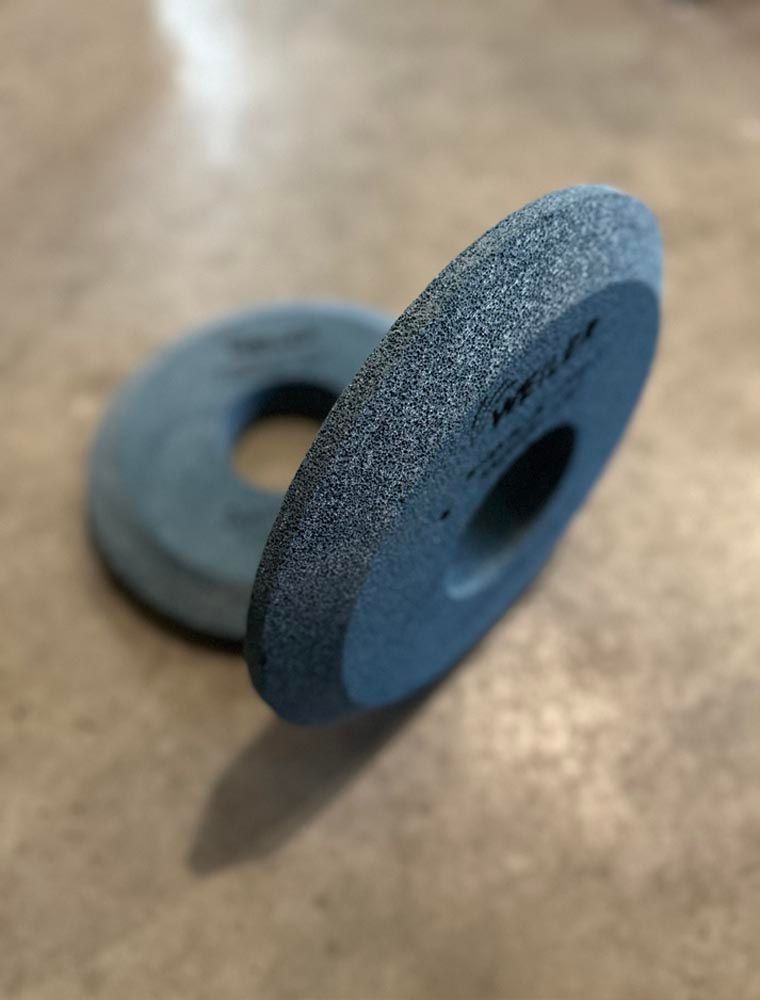

A high performance profile grinding wheel from Weiler Abrasives, showing the high porosity of the wheel. These high performance wheels offer better form holding and longer wheel life.

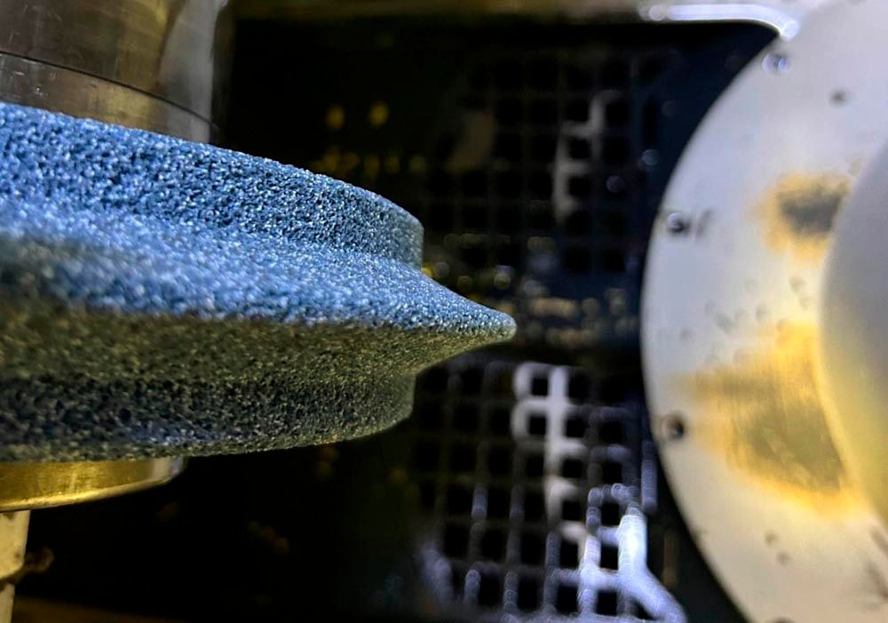

An example of the profile grinding wheel with the profile dressed in.

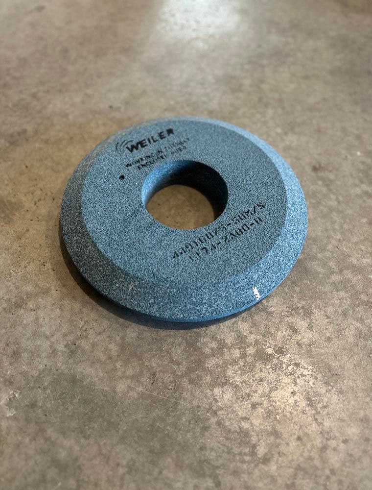

Some profile grinding wheels come pre-formed from the manufacturer, as shown in this example of a high performance profile grinding wheel from Weiler Abrasives.

Gear tooth profile grinding is a discontinuous process that grinds both the right and left gear tooth flanks at the same time, gap by gap. The grinding wheel is dressed in with the exact dimensions of the gear being ground. Most machines use a rotary diamond dresser mounted in, either behind the grinding wheel, on top of the wheel or below it. During the process, the dresser and grinding wheel (or a combination of both) move in multiple axis to achieve the desired gear tooth profile. Compared to continuous generating gear grinding, where the profile is produced by the generating movement, in this process the profile is generated by the profile form that is dressed in the grinding wheel. This helps provide greater profile accuracy.
Most of the time, gear grinding is the last step in the manufacturing process. After grinding, the gear is typically prepared for assembly. The machines used in this process vary by manufacturer and size. Some machines are capable of grinding gears up to 20 feet in diameter inside an enclosure. Other machines are built for larger production batches and can be equipped with automated loading and unloading capabilities, although most material handling in and out of the grinder is typically done manually with hoists.

When choosing a grinding wheel, many formulations are available. Depending on gear hardness, size and finishing method, different wheels will have different results. Other factors to consider include wheel size (width and diameter) as well as rated speed. Different types of wheels can provide varied cutting properties, durability and product life.
Typically, profile grinding operations select an open porosity, vitrified bonded wheel that uses either aluminum oxide grains or high-performance ceramic grains. This differs from the wheels used in continuous generating gear grinding, which typically uses a normal or non-induced porosity wheel. For profile grinding, it’s preferred to use a wheel with induced porosity, or very large pores, to reduce the risk of damaging or scrapping the part—which can add considerable cost to the operation—it’s important to use the correct wheel for the job. Even if the operation is not running the wheel at its maximum capacity, choosing the right wheel can help avoid disastrous results. One wrong grinding wheel can potentially cost a company thousands of dollars or more if the gear fails after it is installed and in use.

Action of a profile grinding wheel being dressed to demonstrate the method used.
