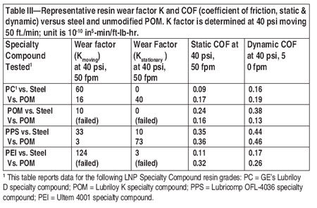

Tribological factors are highly important in all gear applications. A material’s wear and friction characteristics are important to understand, because they can affect such critical factors as gear tooth life, tooth mesh and backlash, noise generation, and gear train efficiency. Self-lubricating properties and enhanced wear resistance are primary reasons that many designers switch to plastic gears. Consequently, the wear factor and coefficient of friction of a given resin are key properties to understand.
Even if the material data suggest that a particular material is strong enough to carry the applied load for the number of cycles expected in the application, another concern is wear of the gear set. The removal of material from the active flank of a gear tooth can dramatically limit the life of the gear, since a thinner tooth may not support the design load of the application (Fig. 5). Wear behavior is influenced by the materials/fillers used in the gear pair, environmental conditions and contaminants, and the load condition of the application.
Figure 5—-Thinned gear teeth.

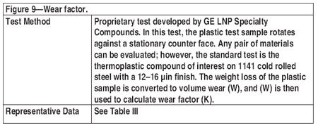

Two different tests have been used to characterize the wear performance of gears. Traditional wear testing is done on a thrust washer wear configuration, which places the raised edge of a rotating disc (moving sample) in contact with another material (stationary counterface). The volume of material lost during the test is recorded, and a wear factor is calculated for both the moving and stationary sample. Measurements of coefficient of friction can also be made during the test. Versions of this test have been widely used to determine if a particular material pair “wears well” or not. Failures can be characterized as a large loss of material (high wear) or a thermal failure (material flow, “PV” or pressure-velocity failure) due to frictional heat generation.
A new type of wear test using actual molded gears has also been developed. In this test two molded gears are run together at a predetermined speed and load. Any loss of material from the face of the gears is detected as a shift in the phase angle between the driving and driven gear shafts. This phase shift is expressed as a linear value and charted against the time the gear set is running. This wear value is a combination of the loss of material from the gear tooth and any additional deflection caused by the tooth thinning or increased flank temperatures. Some might describe the value as an increase in backlash, but backlash has a specific definition in gearing that doesn’t fit this value. This same test can be used to generate fatigue curves (S-N) for a set of gears by simply running the gears at a series of loads/speeds and plotting the curves vs. cycles. Tooth wear as a factor in failure must be included. Similar tests are being adopted by the industry for application testing and validation.

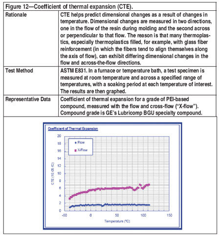

Even the best-designed gear set that uses an appropriate material for the strength and wear requirements of the application can fail if the gears cannot be held at the proper operational center distance. Two aspects of thermoplastics that can make this a challenge are changes in the size of the gear due to temperature change and moisture absorption. For most materials the thermal component will overshadow any growth due to moisture absorption. A gear designer needs to consider the gear mesh not only at a maximum and minimum material condition (as a result of runout in the finished gear), but also at those conditions as influenced by the maximum and minimum temperature in the application. Multi-point coefficient of thermal expansion data can be consulted to evaluate this effect.
Figures 6–12 discuss the testing of different gear-related parameters. In each figure, you will find (a) the rationale for considering a parameter as important to gears; (b) the test method; and (c) representative data. The data are necessarily representative because space limitations preclude inclusion of all data gathered to date for all compounds evaluated.

Typically, the mold shrinkage values given for a material have been determined by measuring the shrinkage of a 5" x 1/2" x 1/8" rectangular bar measured in accordance with ASTM D-955 test methods, or a 60 mm x 60 mm x 2 mm plaque for ISO 294 test methods. These values are usually given corresponding to the dimensions that are parallel (flow) and perpendicular (transverse) to the direction of melt flow in the part. They are normally expressed as “inch/inch” or sometimes as a percentage. These mold shrinkage values can be useful in comparing the relative shrink rate of one material to another, but they should not be treated as absolutes. Mold shrinkage can and will vary with part thickness, mold layout, processing variations, and mold temperature. Of greater value is mold shrinkage data collected on an actual part, whether it is a simple prototype mold or a similar application. It was this approach that was used to study the effect internal lubricants and reinforcements have on the overall accuracy of a gear. A series of gear cavities based on a common spur gear geometry was created to mold a range of materials. The molded sample gears were then used to study how material composition affects dimensional parameters, including:
