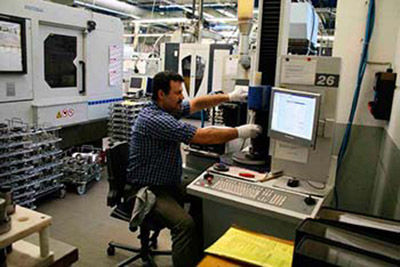

Installation Location Requirements for a Shop-Floor Measuring Device
The installation conditions of a measuring device are crucial for ensuring the accuracy and reliability of the measuring results (Figure 1). Major influences include the effect of temperature on the measuring device and on the workpiece undergoing inspection, as well as the effect of vibrations on the device and the cleanliness of the workpiece.
Figure 1 Gear inspection in a shop floor environment.
- Click image to enlarge
The influences shown here are largely absent in an air-conditioned measuring chamber. A measuring chamber has known disadvantages, however, such as long distances and wait times for measurement, air-conditioning costs, and additional staff.
With smart planning, the effects of negative influences can be minimized, even when the measuring device is used on the shop floor:

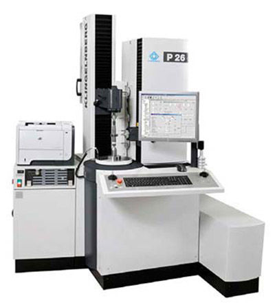

Precision measuring centers for gear measurement, as shown in Figure 2, provide the appropriate prerequisites:
  • The measuring centers are made from a single material throughout (cast iron or steel) to avoid material deformation (bi-metal effect) due to temperature influences.
  • Moreover, metal (cast iron/steel), when used as a design material for a measuring device, provides the advantage of being identical to the material of the workpieces undergoing inspection. Thus under the influence of temperature, both components exhibit the same behavior, and a natural temperature compensation takes place due to physical effects.
  • As the length measuring system, temperature- neutral gauges made of a special glass alloy (Zerodur) are used, with a constant dimension relative to the reference temperature of 68°F.

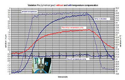

  • Integrated temperature sensors measure the ambient temperature and the temperature of the measuring device. Combined with a software compensation model, the measuring accuracy remains nearly constant over a broad temperature range (64.4°F–86°F). A test conducted over 12 hours comparing measurement results with and without temperature compensation is shown in Figure 3.
  • Figure 3 Temperature compensation test results.
  • The current workpiece temperature can also be measured and compensated for with an additional sensor.
  • High-precision guidance systems for the linear axes and workpiece rotary axis have an anti-friction guideway design and require no energy supply, e.g., via purified compressed air.
  • All guidance and measurement systems are installed covered and are protected against soiling and external influences.
  • To insulate the measuring device against vibration effects, the device is installed on three diaphragm air spring elements, as seen in Figure 2. Lowfrequency vibrations and impacts are thus reliably absorbed.
  • The measuring device features a highly accurate 3D tracer head for recording measured values on gearing. In addition to software monitoring of the measuring ranges, the system also includes mechanical protective devices to prevent damage in the event of improper operation or collision.

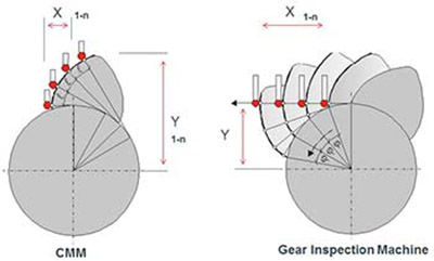

Gearing measuring centers as shown in Figure 2 also have the advantage that measured value recording takes place for cylindrical gears with involute gearing according to the generation principle (Figure 4). The involute curve is generated automatically through the coupled rotational movement of the workpiece with the tangential measuring axis, resulting in stable measurement results, even in the case of positional deviations of the probing system due to environmental influences in production, for example.
Figure 4 Measuring principle.
By contrast, profile measurement based on polar coordinates, as is common in general CMM, is significantly more sensitive to positional variations.

An important feature of shop-floor measurement is that the operating staff for the production equipment (hobbing machines, grinding machines, etc.) also carries out the gear measurements.
The purpose of the measurements is to inspect gearing quality following a workpiece change, for instance, or during ongoing production.
This means that the measurements are not carried out by trained measurement technicians, but rather by machine operators. Additional measures are therefore required to perform reliable, accurate measurements.

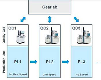

Figure 5 shows the layout of a shop floor with an integrated measuring station. There are production lines (PL1– PLn) for the individual components of a transmission. Each production line has its own test station (QC1–QCn). Each test station is also networked with a central measuring chamber. In this central measuring chamber, prototype measurements are carried out, and the individual measurement programs that will subsequently be transferred to the test stations in production are created. The measuring results recorded on the shop floor are then transferred back to the measuring chamber, where approval will be granted or additional evaluations, such as statistical analyses, will be carried out.
Figure 5 Layout of a gear component factory.
The objective is to enable the operator to carry out the necessary measurements on the shop-floor measuring machine with as much ease and reliability as possible. This relies in part on a simple, precise workpiece fixture. A workpiece fixture between centers lends itself well for shafttype workpieces. For disk-shaped workpieces and internal gearing, a chuck is the fixture of choice. The chuck should be designed so that few or no exchange parts are required for different workpieces.

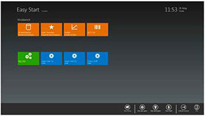

The individual measurement programs are accessed by means of a simply designed graphical user interface, as shown in Figure 6. All measurement programs needed for a measuring station or specific transmission components can be programmed into this page as on a desktop and launched as necessary.
Figure 6 Software HMI.
The system also includes measurement program retrieval via a barcode scanner.
