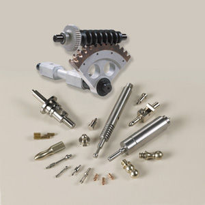

Meanwhile, Precipart is able to get business that wouldn’t have been cost effective without a lower-cost, high-quality alternative provided by its GEM Network partners. "We have some large opportunities," says John P. Walter, Precipart’s president & CEO.
The GEM Network is a group of companies, all ISO 9001:2002-registered, that manufactures gears, gearboxes, turned parts and mechanical assemblies and systems. The group includes European and Asian companies with operations in France, Switzerland and the United Kingdom, as well as China, Malaysia, Singapore and Vietnam. The members created the network to offer what Precipart describes as "a seamless and controlled approach to global sourcing of precision, customized products."
