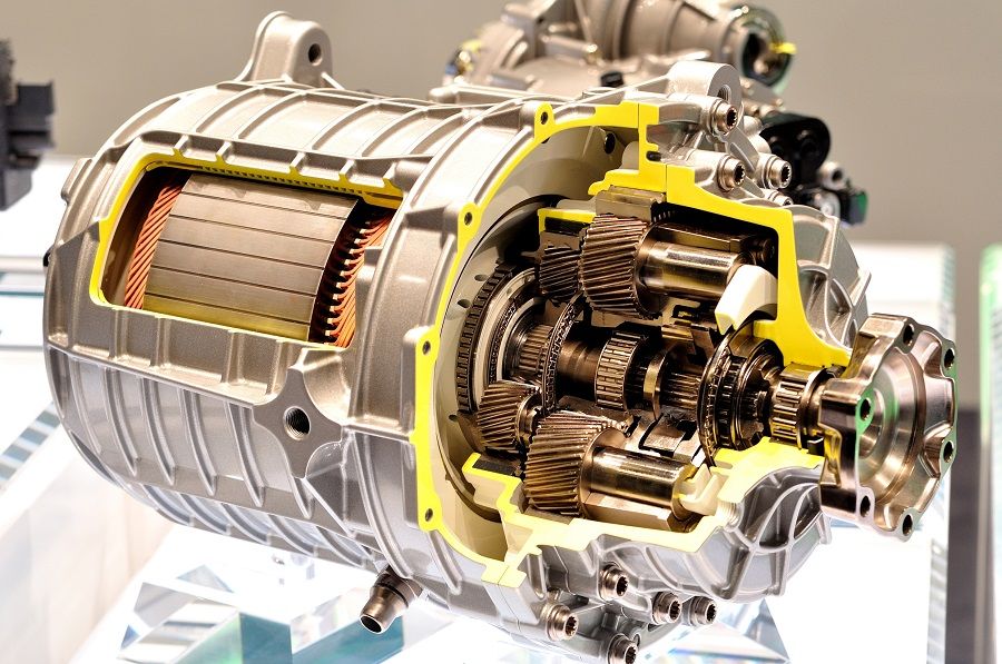

Integrated electric car drive module with an automatic transmission. Courtesy iStock/loraks.
