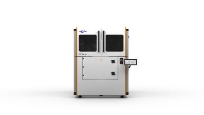

Designed specifically for the additive manufacturing process, the CUT AM 500 horizontal wire EDM makes it easier than ever to quickly separate additively manufactured metal parts from build plates while maintaining geometrical accuracy and ensuring assembly readiness. The machine is a fast, precise, affordable and automation-ready alternative to the use of standard vertical EDM equipment or band saws to separate parts from build plates.
In addition to improving overall efficiency, the CUT AM 500 also resolves a number of quality barriers encountered by manufacturers created by the use of band saws, including but not limited to geometric inaccuracy, loss of workpiece material (kerf) and damage to the part. Ideal for risk-averse industries such as medical manufacturing, the CUT AM 500 maintains the integrity of the part by eliminating any contamination and/or damage.
