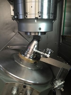

GMTA will feature its Profilator line of gear pointing, rounding, cutting, Scudding, Hard Scudding, deburring and polygon machine tools for North America. The highly modular machines are used for polygon and slot facing, shifter stop machining, chamfering and deburring of highly complex automotive and other powertrain gears. The “Scudding” and the “Hard Scudding” process sets the Profilator apart in the market because of its manufacturing efficiency. “Hard Scudding” allows the machining of green and hardened gears on the same machine, using the same programs. Furthermore, it is a superior technology to skiving, the previous technology used in the gear industry.
While Profilator GmbH & Co. KG introduced the concept of “Hard Scudding” in 2015, it expanded scudding technology with “Micro-Finishing.”  “Micro-Finishing” takes place after the Hard Scudding process has been completed. The process takes a high quality “Hard Scudding” part and improves its surface quality. Additionally, this is a completely “dry” machining process and requires no cutting fluids or MQL technology. The total cycle time for finishing a ring gear via Hard Scudding and “Micro-Finishing” is approximately 64 seconds but the cycle time could be decreased by 10%, keeping it under one minute for all automotive gear rings.
“Micro-Finishing” technology is aimed at making at quieter gear and the superfinishing process reduces friction, increases pitting resistance and the life of gears. This process uses a high quality diamond plated tool, designed to remove only a small amount of part material. The resulting part greatly increases surface quality on the gear teeth.
The “Micro-Finishing” technology can be applied as a “stand-alone” process on a “Scudding” machine, a sequential process where “Hard Scudding” and “Micro-Finishing” are completed using a tandem tool set-up or it can be applied on a double Profilator machine. The processes of “Hard Scudding” and “Micro-Finishing” can be completed simultaneously.
