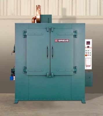

No. 1045 is a 1250°F (677°C), high temperature horizontal air flow cabinet oven from Grieve, currently used for heat treating at the customer’s facility. Workspace dimensions of this oven measure 38” W x 38” D x 38” H. A 350,000 BTU/HR is installed in a modulating natural gas burner, while a 2,000 CFM, 2 HP recirculating blower provides horizontal airflow.
This Grieve horizontal air flow cabinet oven features 12” thick insulated walls comprised of 2” of 2300°F ceramic blanket and 10” of 10 lb/cf density rockwool. Features include an aluminized steel exterior, 16 ga stainless steel interior and a 325 CFM powered forced exhauster. Additional features include inner and outer door gaskets, inner gasket seals directly against door plug and outer gasket seals directly against front face of oven, plus all safety equipment required by IRI, FM and National Fire Protection Association Standard 86 for gas-heated equipment.
