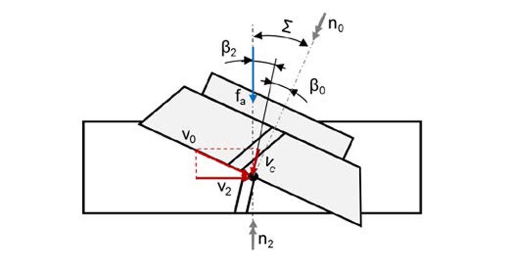

Gear Skiving
During gear skiving, the tool and workpiece are engaged and rotate continuously and synchronously in the same way as crossed helical gears (Ref. 1). The tool axis is inclined relative to the workpiece axis by the axis cross angle ∑, which is calculated by the helix angle of the tool and workpiece (Refs. 1, 2, 3). The profile to be produced on the workpiece is created by the rolling process in combination with the tool shape and the relative movement of the tool and workpiece. The cutting speed component vc is created by the relative movement and the axis position, the feed movement fa takes place along the axis of rotation of the workpiece, Figure 1 (Refs. 1, 2, 3).
Figure 1—Process kinematics for gear skiving (Ref. 14).
The radial infeed usually takes place in several cuts, which can be adapted to the respective machining case using different infeed strategies. It is often useful to differentiate between roughing, semifinishing, and finishing cuts and to vary the process parameters accordingly.

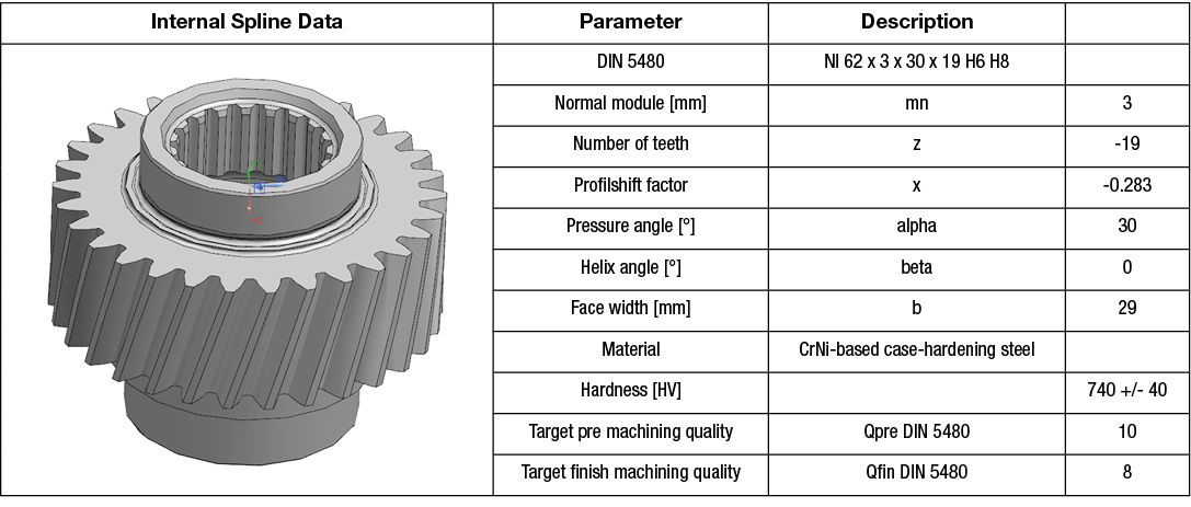

Use Case
New technologies such as skiving offer enormous potential for optimization. To exploit this potential, it is necessary to analyze existing process chains and identify possible starting points. The application case described here involves the production of an internal DIN 5480 spline with small to medium batch sizes of 10–40 parts, the gearing data is summarized in Table 1 (Refs. 8, 9).
Table 1—Gear data.

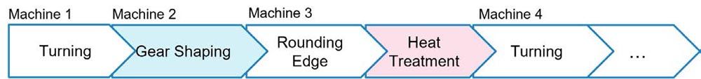

The sequential process chain established before optimization is shown in Figure 4.
Figure 4—Sequential process chain on single-purpose machines.
Sequential machining on single-purpose machines has so far led to a long process chain with a long throughput time. The manufacturing processes commonly used to date for internal gears, such as gear shaping or gear broaching, offer only limited possibilities for economically viable hard-finishing processes, which is why the gearing was previously finished before heat treatment. Due to the lack of a hard finishing process, there was no possibility of compensating for the changes in volume, shape, and position of the gearing induced by the heat treatment. In addition, these geometry changes are very difficult or even impossible to predict due to the large number of influencing factors, making stable prediction extremely difficult. Due to the lack of a hard finishing process, the process chain described was quality-critical and the manufacturing process was not stable.

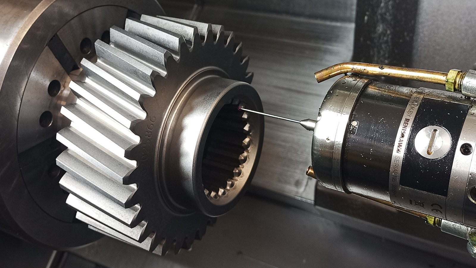

After heat treatment, machining takes place in the same setup as during premachining. Due to the existing tooth gaps in the workpiece, determining the tooth gap position is crucial for machining after heat treatment. For this purpose, a macro was implemented on the universal processing machine which determines the angular position of the tooth gap using a measuring probe. Figure 8 shows the determination of the tooth gap position on the processing machine and the tool cutting edge centered in the tooth gap.
In addition to the angular position of the tooth space on the workpiece, the exact angular position of the cutting edge must also be determined. Deviations in the angular positions of the tool and workpiece lead to incorrect effective positions in the process, resulting in deviations in the tooth profile and changing the meshing conditions.
Figure 8—Indexing on the processing machine and tool in the engaged position.
