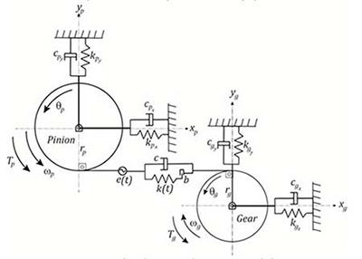

In this study, impact of indexing errors on spur gear dynamics is demonstrated via a simplified lumped parameter dynamic model, as shown in Figure 1. It is a 6 degree-of-freedom (DOF) dynamic model that assumes both gears can translate in x and y coordinates and also can rotate about their own local rotational axis represented by the z coordinates. However, the line of action (LOA) is selected such that it is coincident with the global x-axis of the inertial frame which uncouples the gear dynamics observed in the y directions for both gears from the rest. Consequently, the model can essentially be seen as a 4 DOF gear pair model that represents the LOA and torsional dynamics, as shown by several other researchers to be a valid model when not including the effects of friction (Refs. 13–15).
Figure 1 The discrete dynamic model.
- Click image to enlarge
The proposed model can accept broadband quasi-static transmission error excitations both in the form of long-period time domain input and also in the form of multi-harmonic frequency domain input. This is shown to be superior when certain timevarying and nonlinear effects act on the dynamics of the gear pair simultaneously, such as the cyclo-stationary, quasi-static transmission error.
In the lumped parameter dynamic model developed here, gears are represented by rigid disks which are connected to each other through a number of elements. A spring element is used to represent gear mesh flexibility k(t), which is a time-varying function that is evaluated at different input torque levels by using a contact model (Ref. 16). Here, k(t) includes the parametric excitations due to the mesh stiffness variation caused by the fluctuation of number of teeth in contact into account. A clearance element b accompanies the mesh stiffness function to account for tooth separations caused by backlash or other tooth profile deviations. A viscous damper element c is employed to represent the gear mesh energy losses. A displacement element e(t) is used to represent the quasi-static transmission error that acts along the line of action. The quasi-static transmission error function is also load-dependent and thus should be evaluated at each different input torque level.
Each disk that represents a gear body has a mass of mi, a mass moment of inertia of Ji and a base radius of ri, where i = p or g. Gear bodies are supported by stiffnesses kix, kiy, and also by dampers cix, ciy, which represent the combined elasticity and damping of supporting bearings and shafts that carry the gears. The equations of motion are given below where xi, yi are the translational, and θi are the rotational degrees-of-freedom for the gear bodies:
In Equation 1 a-f, δt represents the relative mesh deflections defined as:
and gear mesh contact loss is mathematically induced by the unit step function, g(δ(t)). The unit step function, g(δ(t)) = 0, if δ(t) < 0 and g(δ(t)) = 1, if δ(t) ≥ 0. An over-dot means a time derivative of the corresponding variable in the equations of motion. In Equation 2 e(t) is the time-varying transmission error function that represents the motion errors caused by gear mesh deflections due to load and also due to manufacturing deviations. Transmission error is a periodic function and is simulated via discrete Fourier series amplitude and phase of this periodic function in modeling schemes that exist in literature (Refs. 16–17). The model can employ the transmission error function either in a time-series form or in a broad-band frequency domain form from a measured or a simulated timeseries. In other words, this model makes it possible to use measured time-domain or broad-band frequency domain representation of the long-period quasi-static transmission error to predict dynamic transmission errors and dynamic mesh forces. Moreover, the dynamic model developed in this study accepts measured transmission error signal with any resolution, automatically synchronizing the time resolution of the transmission error signal with the time resolution of the dynamic model equations for the right solution. A simplified mathematical representation of such a signal in the time domain can be given as:
This transmission error function assumes an infinite number of harmonics, sub-harmonics and overtones of the mesh frequency ωm that are superimposed to obtain a broadband transmission error function as in Equation 3. The quasi-static transmission error, e(t), when measured from a gear set with indexing errors, is periodic over the complete rotation of the gears in mesh if the gears are unity-ratio gears. If two gears with different number of teeth are used, then transmission error signal is periodic over Z1Z2 rotations of both gears, where Z1 and Z2 represent the number of teeth on the pinion and the gear, respectively. On the contrary, for a gear set with no indexing errors, transmission error is periodic over a mesh cycle and over a complete rotation of the gear. This difference constitutes the main mechanism for the signals to convolute.
This dynamic model employs a number of assumptions. First of all, gear wheels are assumed to be rigid, with flexibility only coming from the gear mesh. Gear motions in some other directions, such as rotations about x and y, and translations in z, are excluded for the sake of simplicity. Bearings are assumed to be linear. Finally, simplified damping elements are used. The model presented here makes use of Rayleigh damping, where [C] = α [M] + β [K]. Here, [C], [M] and [K] represent the overall system damping, mass and stiffness matrices and αand β are constant coefficients, and α = 479 and β = 1.4·10-7 was used here.

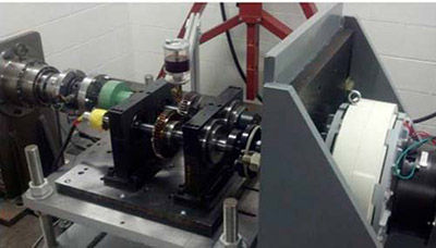

Test machine and set-up. In this study, an open-architecture gearbox with drive and load capacity was used to measure the quasi-static transmission error of spur gears with different indexing errors. This rig (Fig. 2) is designed to operate gears under high-load and low-speed (loaded quasi-static) conditions. A small DC motor is connected to a 100:1 ratio harmonic drive to reduce the speed significantly while increasing the torque delivered to the gear pair. The harmonic drive was directly connected to a torque-meter to monitor the input torque provided to the gearbox. The output side of the torque-meter was connected to one of the test gear shafts via a flexible elastomer coupling. The test gearbox consisted of a unity-ratio spur gear pair held by relatively rigid shafts. Concentric bearing housings holding the bearings were mounted on two massive split pedestals. The shaft of the driven (output) gear was connected to a magnetic particle brake with a maximum torque capacity of 400 Nm by means of another flexible coupling. The shafting permitted optical rotary encoders to be mounted on their free ends outside the bearing pedestal for measurement of TE. The rotary encoders (Heidenhain, RON 287) have the capability to measure 18,000 positions per complete rotation.

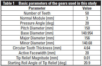

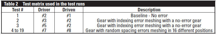

Test specimens and test matrix. Unity-ratio spur gear pairs were used in this study with an operating center distance of 150 mm. A total of 7 gears with tightly controlled indexing errors formed the inventory for the test matrix. Two gears with no indexing errors, three test gears with discrete spacing errors at a few teeth along with two additional gears with randomized spacing errors were procured specifically for this study. Basic gear parameters for these gears are listed in Table 1. Each gear pair had a theoretical contact ratio of 1.8. The test gears had the following intentional spacing errors:
  • Gears #1, #2: Gears with no indexing errors (in reality, errors exist but less than 2 μm).
  • Gear #3: Gear with a single tooth having a negative 15 μm spacing error.
  • Gear #4: Gear with two consecutive teeth having negative 15 μm spacing errors.
  • Gear #5: Gear with two teeth having negative 15 μm indexing errors with the tooth in between them in the correct position.
  • Gears #6, #7: Gears with all teeth having spacing errors with randomly distributed magnitudes between the range [-15, 15] μm.

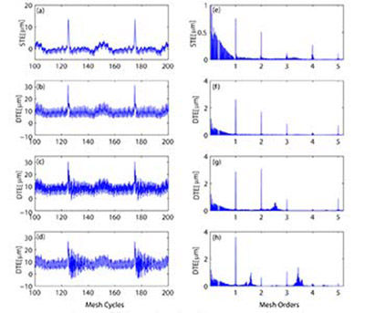

Although numerous test cases, along with the corresponding dynamic model predictions, were carried out, a subset of the results is reported here to illustrate the importance of incorporating indexing errors into the gear design and dynamics considerations. Results from Test #1 that included the baseline gears with no indexing errors along with the corresponding dynamic transmission error predictions are shown in Figure 4.
Figure 4 Measured static TE (a) along with predicted dynamic TE time histories from Test#1 at 400, 1,300 and 2,100 rpm (b-d); and corresponding frequency spectra (e-h).
In Figure 4(a) a measured STE time history is given between gear mesh cycles 100 to 200. This mesh cycle range was intentionally chosen to exclude any transient effects taking place — especially for the initial cycles for the predicted DTE. In addition, measured STE and predicted DTE traces were presented within the same mesh cycle ranges to clearly demonstrate the dynamic magnification effects. It is apparent from both Figure 4(a), and its corresponding frequency spectrum Figure 4(e), that even baseline gears had limited indexing errors on them along with teeth deflection and other geometric imperfections that contributed to the STE. Predicted DTE at 400 rpm, 1,300 rpm and 2,100 rpm is presented in Figure 4(b-d), along with their corresponding frequency spectra in Figure 4(f-h). Although it is clearly observed from the comparison between time histories for STE and DTE at different speeds how dynamics play a significant role on TE, note also that frequency spectra are intentionally presented in gear mesh orders to help us detect the changes at main mesh order and its harmonics, shaft orders and also gear pair resonances at once. For instance, in Figure 4(g), when gears were rotating at 1,300 rpm, resonant peak revealed at the mesh order 2.8 that corresponded to the second mode (torsional mode) of the system. Similarly, in Figure 4(h), when gears were rotating at 2,100 rpm, resonant peaks at the mesh orders 1.6 (torsional mode) and 3.6 (coupled torsional-translational mode) were revealed due to gear pair dynamics.

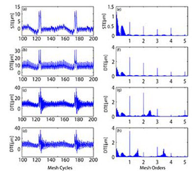

In Figure 5 STE and DTE time histories, and corresponding frequency spectra from Test #2, are given following the same sequence in Figure 4. Test #2 included a gear with no indexing errors and a pinion with an intentional spacing error of 15 μm at tooth #25 (Fig. 3). The peaks that are seen in the filtered STE time trace (Fig. 5(a)) exhibit how the discrete spacing error of the particular tooth on the gear comes in mesh and causes a sudden increase in the measured STE once during a complete rotation of the gear; i.e. — once in every 50 mesh cycles. The fact that one of the teeth has discrete spacing error, whereas all the other teeth have almost perfect spacing, breaks the cyclo-symmetricity of the meshing action and thus mistunes the dynamics of the gear pair. This can essentially be observed in Figure 5(a-d), when the same gear pair was used but was run at sequentially increasing speeds. Especially, in Figure 5(c) and (d), when the gears were rotating at 1,300 and 2,100 rpm, respectively, time traces exhibit how more than once mesh cycle was affected due to a single discrete spacing error on the gear.
Figure 5 Measured static TE (a) along with predicted dynamic TE time histories from Test #2 at 400, 1,300 and 2,100 rpm (b-d); and corresponding frequency spectra (e-h).
Under dynamic conditions, teeth do not only deflect due to the applied external load, but also oscillate about this pre-deflected position under the influence of dynamic loads. Moreover, indexing errors cause time and phase lags (or leads) on the mesh timing that can cause dynamic loads to become magnified and also modify them to where they become more impulsive. Gear contact ratio reinvigorates the gear pair dynamics as it is the most important design parameter that decides upon when and how much load will a particular tooth carry. Moreover, mesh damping strongly influences the dynamic response of the gears, but is hard to determine and also to change. The other important point to stress here is the energized broad-band shaft order regime and its physical reasoning. In Figure 5(e-h), although run-out effects were excluded from the measured STE, shaft order (orders lower than the fundamental mesh order) peaks and integer multiples are revealed. The main reason is that the teeth with deterministic spacing error repeats and leaves its signature once in every rotation of the gear, leaving a strong mark on the frequency spectrum. This effect becomes even more significant when dynamics come into play at higher speeds. The peaks revealed at integer multiples of the shaft orders are due to the amplitude and phase modulation of the TE and will be further studied in a subsequent study by the authors. In Figure 6, results from Test #3, where an intentional deterministic indexing error pattern of 0-15-0-15-0 μm was used on the pinion, is presented. In this case there is a single, intentionally misplaced tooth on the gear that was followed by both a perfectly positioned and misplaced tooth. This error pattern introduced another layer of complications to the resulting frequency spectra by strengthening 2× shaft orders along with 1× shaft orders. The complicated phasing relationship affected the resulting peak distribution in the frequency spectra, which is more clearly visible from orders lower than the fundamental (1×) gear mesh order.
