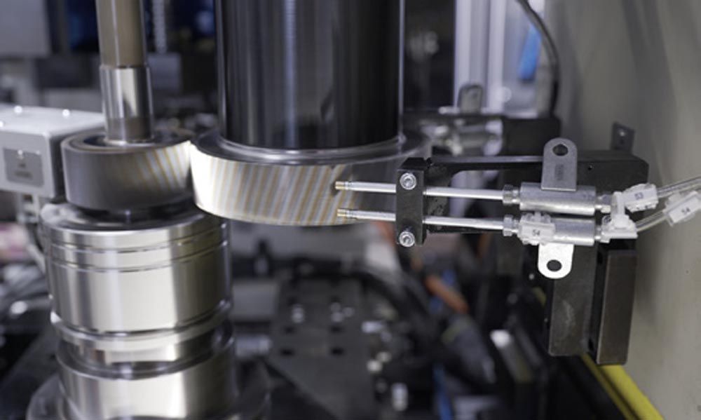

To achieve this task more easily, new testing technologies are entering the market. Marposs recently introduced the NVH G-EAR testing machine that works on the Single Flank testing methodology to help its customers identify potential noise-producing gears prior to the assembly into the gearbox. The single flank testing principle is based on one master gear meshing with the component under inspection to detect macrogeometry (nicks, runout, etc.) and microgeometry (gear mesh excitation, ghost orders) defects that are responsible for gear whine and noise phenomena. The ability to achieve high torque and rotational speed, as well as the possibility of adjusting them at will during testing, is one of the major benefits of the application. This allows for the testing of gears in operating conditions almost comparable to those found in the final e-drive.
Figure 2—This gear tester from Marposs works on the single flank testing method where a master gear meshes with the component under inspection, identifying defects not detectable with traditional production tests.
