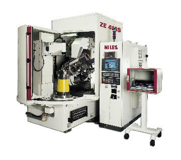

Kapp and Niles to Highlight Gear Grinders’ On-Board Measuring and Ring Loader Automation
Booth B-7030
The Kapp Group will feature at IMTS a technology transfer involving a popular Kapp gear grinder and Niles’ ZE 400S (extended stroke) gear grinder.
The ZE 400S will simulate profile grinding of internal gears. However, the machine’s on-board measuring and inspection will be demonstrated for real, with contact between workpiece gears and probe.
“The machine will actually demonstrate gear measuring,” says Bill Miller, newly appointed vice president of sales for Kapp Technologies, the North American operation of the Kapp Group.
The ZE 400 can measure lead, involute, and index on internal and external gears in accord with AGMA standards, DIN standards or customer specifications, such as via K charts. The measuring is done with a Renishaw touch probe, which isn’t sensitive to temperature, Miller says, so it doesn’t require frequent recalibration due to temperature variations.
Also, the ZE 400 can perform on-board dressing of its grinding wheels. The on-board measuring and dressing are transferred Kapp features, and together, they allow the correction of the tooth form in a semi-automated process that Kapp calls GMG (grind-measure-grind) technology.
“It doesn’t require the typical trip to the gear lab with the component,” Miller says of the on-board measuring and correcting. “The most important feature is the higher productivity for larger gears.”
Kapp will display its KX 300 P, too. The popular profile and generating grinder features on-board measuring and inspection and on-board dressing of its grinding wheels and worms. Also, the machine will be set up for simulated grinding cycles and for demonstration of a working, integrated ring loader system.
“It’s coming as a turnkey solution from Kapp,” Miller says. “It’s designed to be very easy to set up, so it can be used for smaller lot sizes.”
However, Miller says automation, like the ring loader system, is usually for large production, such as in the automotive industry. He adds that the ring loader system is Kapp’s first to be integrated within the machine enclosure.
“It’s designed as a CNC axis,” Miller says of the system. “The CNC axis enables the loading to be faster, more precise and easier to set up, so it can be efficient for batch lot production also.”
Kapp and Niles personnel will be available to discuss the new ZX series, too. A gear grinder in that series is the ZX 1000, which was introduced in June in Düsseldorf at the German show METAV (Manufacturing Technology and Automation). Miller describes the ZX series as an extension of KX 300 P: “The ZX is an extension of that line to a larger platform.”
As of early August, Kapp had delivered its first ZX 1000 to a company in the printing press industry.
Kapp and Niles will also display scale models of other machines and processes, such as the VUS 55 P and the CX 250. Miller says these models enable more efficient explanation of various processes available from Kapp and Niles.
The VUS 55 P form grinds external and internal spur and helical gears and uses either CBN or dressable grinding wheels. The CX 250 finishes external spur and helical gear flanks via Kapp’s Coroning® process.
The VUS 55 P also performs on-board gear measuring, facilitating automatic documentation of the amount of stock removed from each gear tooth flank.
“Several of our customers have an interest in controlling the case depth of every single tooth,” Miller says. He adds this interest exists when the gears will be heavily loaded in high-duty applications, such as in a city bus. He also cites aerospace as another application in which gears may be high duty and heavily loaded.
In such instances, inspection of each flank can be necessary, Miller says, because: “The case depth is so critical to the design integrity.”
Also, on-board inspection allows gear inspectors to avoid problems that can result when matching a gear’s in-lab orientation with its on-machine orientation.
Miller says the Kapp and Niles products coming to IMTS signify a continued sharing and integration of key technologies, yielding benefits for Kapp’s customers.

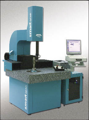

Wenzel’s Smart Gear machine, introduced in 2005, can perform four-axis measuring of internal and external spur gears, helical gears and splines, as well as worms and worm gears.
The machine can inspect gears with a minimum module of 0.4 mm, a maximum outside diameter of 270 mm and a maximum face width of 300 mm. It can also perform 3-D measurement and inspect tools such as hobs and shaping and shaving cutters and other special tools, like stick blades. Moreover, the machine can be equipped to perform CMM work.
Gimpert says the Smart Gear is “ideally suited for a job shop that needs a more economical gear inspection machine or a combination machine with gear and CMM capability.”
