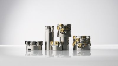

Square T4-12
With larger insert sizes, Seco's T4-12 line of square shoulder and helical milling cutters allows parts manufacturers to achieve increased depths of cut and higher metal removal rates when roughing and semi-finishing steel, cast iron and other workpiece materials.
The bigger inserts all come with four curved cutting edges that lower tooling cost per part and ensure smooth machining operations. They tangentially mount in the cutter bodies for increased performance stability and easier access to their mounting screws. Plus, this mounting design directs cutting forces to the thickest part of the inserts, which contributes to their higher metal removal capability.
Cutter diameters for the larger T4-12 square shoulder inserts range from 1" to 5" (25 mm to 125 mm), with corner radii up to 0.125" (3.1 mm). Diameters for the larger T4-12 helical inserts range from 2" to 4" (50 mm to 100 mm), with corner radii up to 0.125" (3.1 mm). The inserts also come in a wide selection of grades and geometries as well as in normal and close pitch versions.
Highfeed 6
Seco's new high-performance Highfeed 6 milling cutter easily tackles a variety of difficult-to-machine materials from stainless steel to heat-resistant superalloys. The large-diameter cutter bodies are capable of 0.070" (1.8 mm) axial depths of cut and feature double-sided inserts with six cutting edges for unsurpassed material removal and low operating costs. The cutter performs equally well in all types of high-feed applications, including face milling and plunging operations.
Highfeed 6 inserts mount at low lead angles to direct machining forces up into the machine tool spindle rather than radially against the side of the tool. As such, the tool experiences less vibration and provides long, predictable performance.
