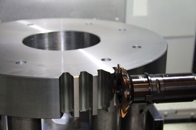

DMG Mori is also launching its new horizontal machining center NHX 4000 2nd Generation. This machine provides a very cost effective way to produce large diameter cylindrical gears. The super accurate B-axis (rotary table) ensures machining of excellent quality gears and a pallet changer (standard feature) eliminates the setup time altogether. The fast tool changes will reduce the cycle time and a large tool magazine will keep the machine running overnight. This machine will show a 19 in. diameter spur gear machined using the InvoMilling process and a 26 in. diameter herringbone gear machined using the flankmilling process.
