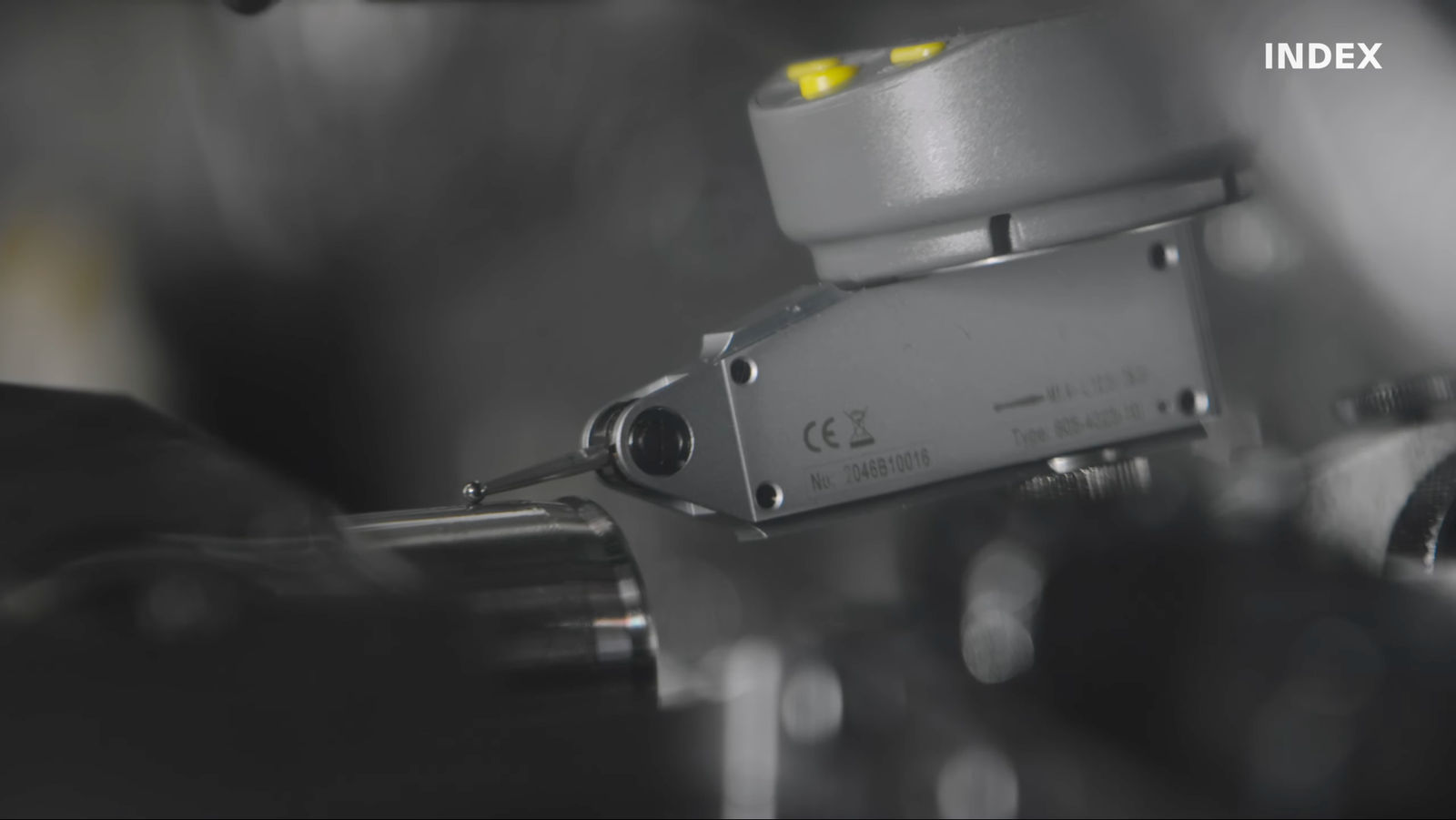

INDEX has announced the launch of its new CenterMaster accessory. As part of the company’s sustained investment in R&D focused on streamlining the setup and changeover process for CNC multi-spindle lathes, CenterMaster reduces the time needed to align a drill by up to 90%.
Previously, center alignment of a drill required specialized knowledge by the operator and a challenging, manual process that could take up to 30 minutes per holder. With CenterMaster, the user simply clamps a radio dial gauge into the workspace and sets it to the quill. The gauge and machine wirelessly communicate, automatically adjusting the holder along the x axis. The system then guides the operator through adjusting the y axis via the machine’s touchscreen display.
The CenterMaster system allows operators with no specialized knowledge or experience to set up a drill in two to three minutes. Additionally, it provides a repeatable accuracy of
“Over the past several years, we have introduced multiple innovations to make CNC multi-spindles more flexible,” says Cris Taylor, president & CEO of INDEX. “We had already taken a lot of the time out of setups and changeovers via presetting and our quick clamping system with W-serration locating. CenterMaster eliminates another time-consuming aspect of setups, so that customers can truly optimize their machine utilization.”
