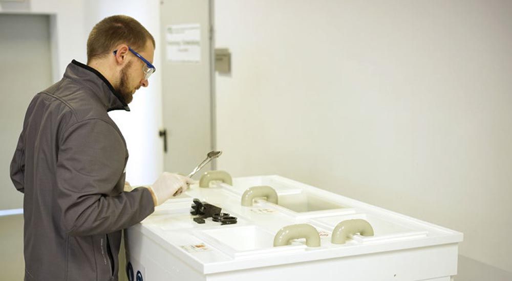

Figure 1—Mobile etching table for the Nital etching process. (Source: imq GmbH)

Nital etching (NE) exploits resistance to acids, especially dilute nitric acid. According to ISO 14 104 and AMS 2649D, the testing process is divided into a number of individual sub-steps: cleaning of the parts, the actual etching in aqueous or alcoholic nitric acid, and the evaluation of the part surface on grinding burn indicators. To enable the grinding burn test to be carried out directly on the grinding machine, a mobile etching table (Fig. 1) was developed.
Up to now, the STE is the only standardized process for grinding burn testing (see an overview of the currently applicable standards in Ref. 1). STE can be used for a wide range of parts made of unalloyed or low-alloyed steel. However, strict environmental and health-and-safety regulations must be observed because of the use of acids. It is also problematic that the evaluation of the etch indications on the part surface is currently still carried out exclusively by an inspector. To ensure the reliability and reproducibility of the process, reference bodies were developed in which artificial grinding burn was generated by means of a laser (Fig. 2) (Ref. 2).

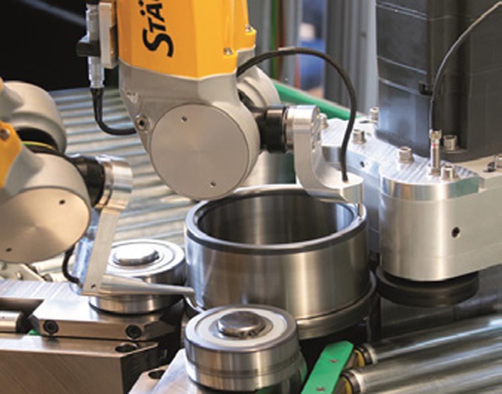

Figures 3 and 4 show examples of the inspection of bearing rings applying ET.
Here, by means of a robot, the test probe is contactless guided over all functional surfaces of the ring.
The testing machine is CNC-controlled so the testing process is automated. The test can be performed without contact, although the distance between the probe and the surface must be kept as constant as possible.
