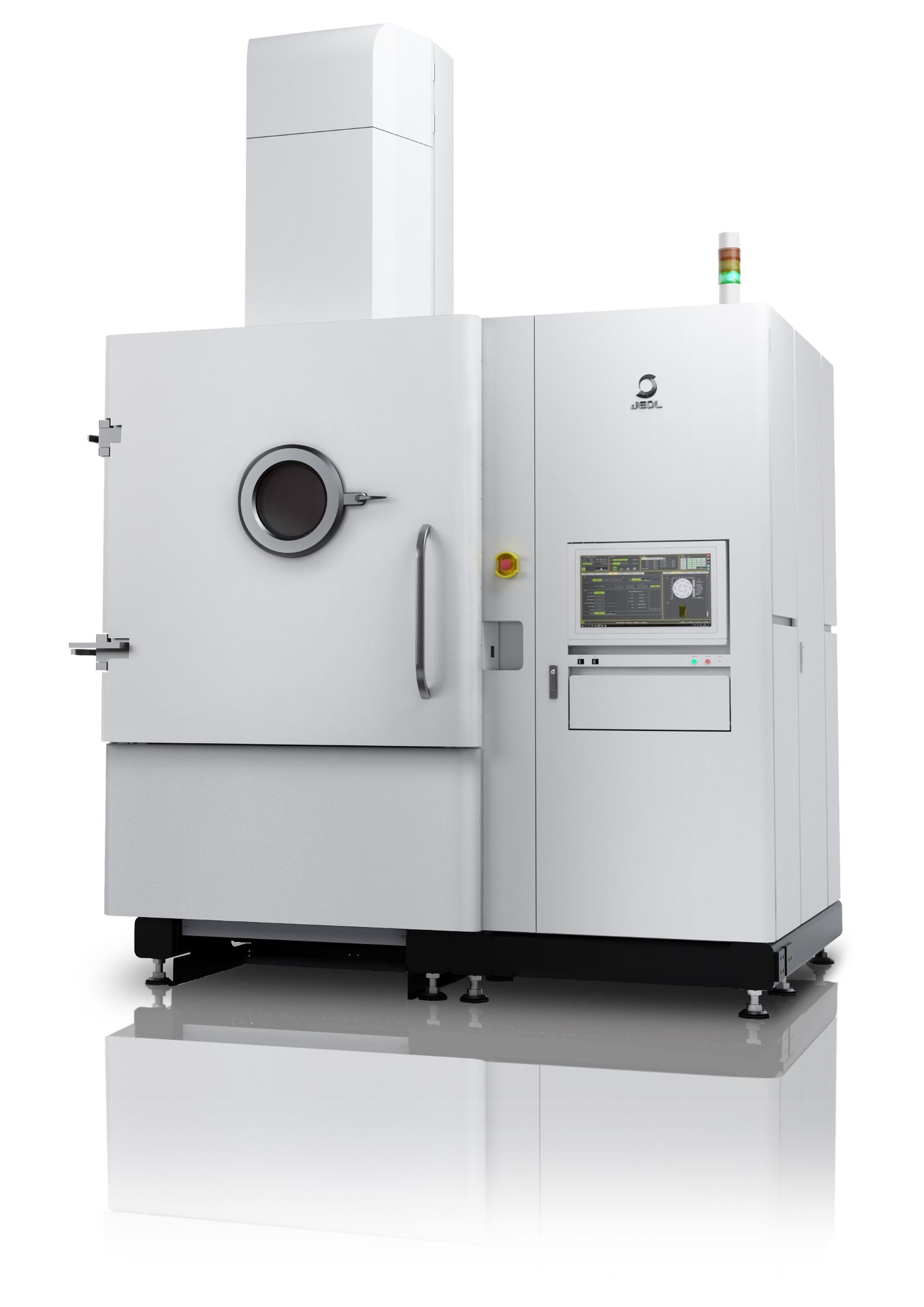

JEOL’s JAM-5200EBM Metal 3D Printer, a production-ready Electron Beam Powder Bed Fusion (EB-PBF) additive manufacturing solution, has demonstrated the ability to meet the rigorous AMS7032 operational qualification (OQ) standards while achieving the AMS7011 material requirements for Ti-6Al-4V alloy with post-deposition hot isostatic pressing (HIP). JEOL’s is the first EB-PBF machine known to meet the requirements of AMS7011 since they were first established on another EB-PBF manufacturer’s model.
The AMS7032 Operational Qualification Standard evaluates the ability of an AM powder bed fusion machine to consistently meet material specification requirements while maintaining process control and stability over several builds. To comply with the OQ procedures listed in AMS7032, three identical builds containing a large number of Ti-6Al-4V specimens in all three orientations and encompassing the entire JAM-5200EBM build envelope were made using reused powder that conformed to the AMS7015 specification. The specimens were then subjected to tensile testing, microstructure evaluation, chemical composition testing, radiography, and other tests to verify that they met the requirements of AMS7011. All required post-processing and testing of the specimen was performed at a ISO17025 accredited laboratory.
The results of the testing not only demonstrated the high stability of the machine but also revealed a key strength of this system: the JEOL JAM-5200EBM system produces material with excellent ductility and very low anisotropy. These results also indicate that designers should have significant freedom in how parts are oriented within the building envelope thus enabling greater DfAM flexibility and unlocking the potential for truly optimized designs.
