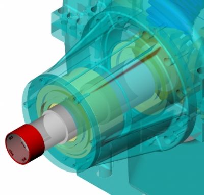

In static system analysis, the deformation of the housing can be taken into account in the KISSsoft Release 03/2016, and therefore its effects on the bearings. The resulting displacements of the bearing outer rings, deform the shaft to a greater or lesser extent, and therefore have a decisive effect on the toothing contact analysis, in particular when resilient housings and powerful forces are involved.
To perform the calculation, a stiffness matrix for the housing is imported. This stiffness matrix can now be loaded directly into KISSsys in the formats used by the ABAQUS and NASTRAN and ANSYS programs.
