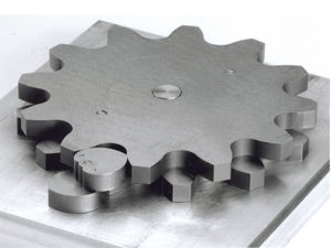

In this article, a laminated gear consists of two spur gears on the same axis, where the teeth on one gear are aligned with the tooth spaces on the other gear. The contact ratio for each mesh can be as low as 0.5. The basic geometry and circular fillet design are outlined.

In some designs, it is advantageous to use laminated gearing instead of helical gearing. Specifically, in fine-pitch formed gearing (molded plastic, die cast, powder metal, stamped), tolerances are often so large relative to whole depth that the contact ratio is less than unity. In that case,it is necessary to use either laminated or helical gearing (Ref. 1).
In choosing one or the other, note should be taken of the fact that tooling for laminated gearing is simpler and more accurate than that for helical gearing, since tooling for laminated gearing is made on a wire EDM machine, whereas that for helical gearing is made with a machined electrode guided by a rotating mechanism. Also, inspection equipment for laminated gearing is simpler than that for helical gearing (Ref. 2).

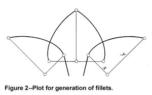

With the advent of wire EDM, it has become common practice to replace the fillet generated by a basic rack with a circular arc of specified radius. Consequently, the designer now has to determine the location and radius of a circular arc that does not intersect the fillet generated by the tip of the mating tooth. If a computer program is not accessible (some programs do not determine the fillet generated by the tip of the mating tooth and some programs do not accept one and two-tooth pinions), then the fillet can be determined graphically--the old-fashioned way (Ref. 6).
To plot the fillets, the mating gears are rolled together in tight mesh (Ref. 7). Rather than draw the rolling circles (also known as operating pitch circles), only the tooth profiles are plotted (which permits greater magnification) on 8½ x 11 vellum, as shown in Figure 2.
It is important to remember that whenever the outside form radius of the gear (Rof) contacts the base point of the pinion profile (as in Equation 3), then the specified circular arc falls on the radial line to the base point, not on the involute.
The four involute profiles in Figure 2 are traced from a single involute plotted on 8½ x 11 vellum (Ref. 8).

The locations of the y endpoints on the centerline of each tooth in Figure 2 are calculated from right triangles.

It should be noted that this method does have some limitations. For instance, even though the illustration show both the driver and driven laminated gears with the laminations flat in form and closely side by side, practical manufacturing and assembly conditions may dictate the need for a spacer of some form on at least one of the gears. The benefits of laminated gearing are only available if, in each set of laminations, there is a very accurate rotational orientation of one outline to the other and that the two outlines themselves are very closely matched. Finally, another limit on reducing the number of teeth in the driver is the need for a root diameter of adequate size, either to permit mounting on a shaft or simply of adequate torsional cross-section to transmit torque to the gear teeth.
