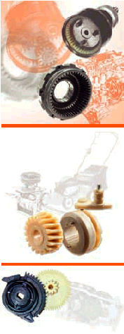

DSM’s Stanyl lawn mower starter gears, actuator gears and other products allow for higher torques through a wider temperature range.

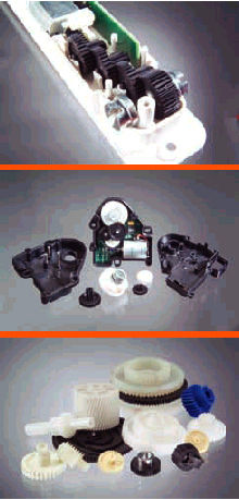

Seitz Corp. offers a gear train developed to open and close interior plantation shutters for the window fashion industry (top), actuators for HVAC applications (middle), and plastic gears with a variety of resins.
