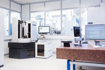

In fact, they are not traditional measuring rooms, but two bright, modern measuring cabins, located within the production plant at the Ettlingen site. This is the new home of the latest measuring technology from Liebherr. Constant temperatures, air quality and optimal lighting conditions offer the perfect environment for the measuring instruments and for the four quality assurance staff to carry out their daily tasks. When manufacturing the gear cutting tools, they make sure that the highest standards (up to grade AAA) are also met. The same standard also applies to the various gears manufactured under contract on Liebherr gear cutting machines.
