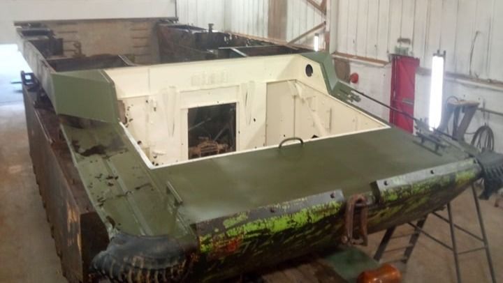

Photo provided by the Project Buffalo Historical Group.
David Brown Santasalo is restoring an ‘Operation Buffalo’ LVT gearbox for the Crowland Buffalo LVT Historical Group after being buried 30 ft. underground for 74 years. The gearbox has been preserved in a World War II military amphibious land craft and is now undergoing refurbishment at our manufacturing facility in Huddersfield, UK. However, the Crowland Buffalo LVT Association needs help to fund the restoration project and find permanent home to assist with the preservation and housing:
(https://www.gofundme.com/f/crowland-buffalo-restoration-museum)
During the ‘Big Flood of 1947’, sixteen military amphibious land crafts were sent into Crowland, Lincolnshire by the British Army to act as a barricade against the River Welland’s banks breaking. The amphibious land crafts created a standing flood defense for almost 30,000 acres of land around the River Welland, however when the water was then pumped back into the flood plain, five of the Buffalo military amphibious land crafts floated away. Whilst they were able to recover one of the crafts, two sank into fishing pits and the rest were unrecovered.
After hearing about the disappearance of the 26 ft., 18,000 kg tanks, Daniel Abbott, chairman of the Crowland Buffalo LVT Historical Group, committed himself to finding the tanks over the last four years. Starting with a dedicated committee of friends to help him research, ongoing fundraisers to maintain necessary funds and help from RAF Wittering, along with an army of volunteers and a drone flight from Crowland Cranes, the first Buffalo craft was finally recovered after a five-day operation ending on Thursday April, 29, 2021.
Once the military amphibious land craft had been brought above ground with the help of a 50-man project team, including the North Level Internal Drainage Board (NLIDB), Crowland Cranes and Tear’s Recovery, the next step was assessing the 74-year captivity damage. Instantly it was clear that the craft was still in remarkable condition despite its age, due to the preservative properties that were in the 4,500 tons of clay that it had been submerged in.
Remarkable condition after 74-years in clay!
David Brown Santasalo’s Global Defense Director and Managing Director U.K., Steve Watson said, “Upon hearing about this historical discovery, we began discussions with the Crowland LVT Historical Group. They were aware of our long-standing expertise in the Land Defense power gearbox market and our unique capabilities to repair any make of gearbox, no matter how old! I was delighted to have the opportunity to be involved and our specialist team are now working hard to restore the LVT gearbox to its original glory. DBS is pleased to offer our services to the historical society free of charge and ensure the gearbox is professionally refurbished, while ensuring it maintains its authenticity.”
In order to assess the condition of the gearbox, the company sent a trained DBS fitter, accompanied by one of its new apprentices to analyze the tank and its gearbox and provide an internal review of the requirements for the project. The gearbox was then transported to the Huddersfield facility, where it has been stripped down, cleaned and evaluated. The findings were that the gears themselves just need polishing and a thorough clean, but miraculously only have surface rust, proving how well the clay has preserved it! www.dbsantasalo.com
