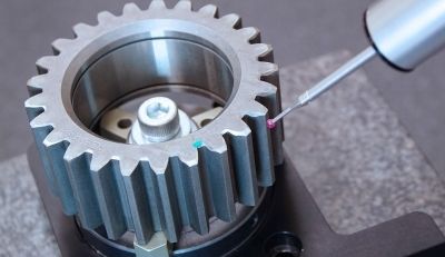

Coordinate measuring machine (CMM) manufacturer LK Metrology has introduced a third release of its CAMIO 2021 programming and measurement software featuring numerous improvements. The most significant is the inclusion of a module that automates the inspection of spur and helical involute gears.
CAMIO GEARS makes it possible to begin measuring the specific geometry of gears quickly by using the core capabilities of CAMIO software to generate straightforward inspection programs, advanced gear reports and automated probe calibration routines.
For each gear type, the software has a unique set of definitions, evaluation algorithms and reporting graphics conveniently packaged in one add-on module, making it easy for users to bring a new capability to their existing CMM. The module supports alignment of the gear axis during measurement using any of the three CMM axes and traditional touch trigger probes or advanced scanning probes.
