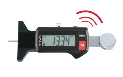

Mahr Inc. has announced an expanded line of digital depth gages. The pocket-sized 30 EWRi is easy to take along for fast depth measurements and the new universal depth gage 30 EWR-U/40 EWRi-U includes interchangeable anvils.
The 30 EWRi is a compact depth gage with a 0.06 inch (1.5 mm) contact and 1 inch (25 mm) gaging range with integrated wireless data transmission. It is ideal for mobile use in manufacturing and inspection at the point of manufacture.
