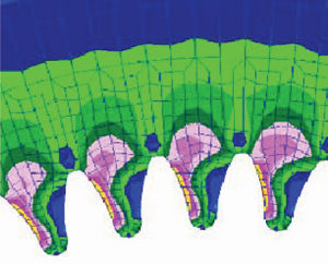

To begin development of cold forming gears, finite element analysis (FEA) was used to determine how much forming load is required, how the material will flow, and how much the tools will deflect (Fig. 2).
Figure 2—Gear die stress distribution.
Since metal forming involves movement of large amounts of material, a plastic deformation (non-linear) finite element software program is required. Today there are over a dozen commercially available FEA software packages capable of simulating metal forming processes, cold or hot.
An advantage of using FEA simulation during the development phase is to be able to determine the overall effects of parameters on the results; e.g., the effects of the punch geometry on the material flow, the effects of the material alloying and processing on the forming load, etc. (Fig. 3). As a developmental tool, FEA simulation allows the user to test several “what if” scenarios without having to manufacture expensive “hard” tools. FEA simulation can also be used to help determine what type and size of manufacturing equipment is required to cold form a family of gears.

The FEA simulation results were used to conduct an initial feasibility analysis to determine the process limitations and manufacturing equipment requirements, and to estimate if the process yields a competitive product.
