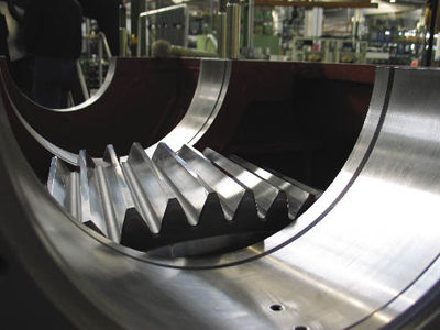

Photo courtesy of ZF Marine GmbH.
A gearbox that absorbs 30 percent of external forces, transmits power from two engines operating at different speeds, and uses gears that meet several design and specification standards at the same time.
Many gear manufacturers would wrinkle their brows at this unusual box. But what’s odd to them would be ordinary to marine gear manufacturers. The above features are commonplace in high performance marine gears and their boxes, which are used in vessels as wide ranging as luxury yachts, fast ferry boats, frigates and workboats.
Given these features, marine gear manufacturers often have to create gearboxes that are much more compli-cated than their non-marine counterparts.

Marine gear manufacturers also have to keep in mind that their gears and boxes will lack what are considered infinitely stiff foundations. The problem isn’t the gears, their box, its immediate base, or the ship itself. The problem is the water. It’s not stiff. Even when calm and in a sheltered harbor, water isn’t a road or a rigid, stationary platform.
Still, gear mesh mustn’t be affected by even rough waters.
“Stiffness is most important to have reliable tooth contact between the gears,” Hoppe says.
That reliable contact is no small feat given that a characteristic of high performance marine gears is their mechanical efficiency. At ZF Friedrichshafen AG, Gerald Rowe, R&D manager–marine transmissions, puts that efficiency at 99 percent tooth contact between pinion and bull gear.
To keep gears in mesh, their casings are strengthened with ribs or built with a double-wall design. “The casing has to be as stiff as possible, always,” says André Thuswaldner, chief design engineer for Maag Gear AG. Thuswaldner is responsible for the initial design of his company’s marine gears.

Marine gearboxes must be able to resist external forces, like those introduced into the box’s foundation from the surrounding structure or vibrational forces from the propeller and propeller shaft. To an extent, resisting external forces means being able to absorb them.
That extent can be considerable in high performance marine gears. Hoppe says gear assemblies for non-marine applications normally absorb a maximum of 20 percent of the amplitude of external forces, but marine assemblies absorb 30 percent of non-transient forces and up to factor 2 transient forces. The extra absorbency helps the marine gearbox avoid breakage.
Without the extra amount, the gearbox’s bearing assembly could overload, disrupting the oil film, which would immediately damage the bearing, causing the gears to stop. At that point, the vessel wouldn’t be propelling itself; the water would be.
