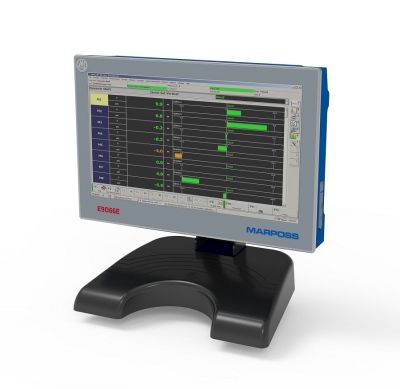

Marposs Corp. has announced the availability of its E9066E 15.6-in. wide-screen industrial computer for data collection, measurement, industrial control and production/factory automation. Running on a 64-bit industry-grade quad-core processor the E9066E guarantees excellent throughput for complex calculations and graphical applications without impacting system performance. This totally fanless and diskless industrial computer provides a compact, economic and maintenance free solution for any shop-floor environment.
This 15.6" true-flat full-HD LCD with integrated touch screen supplies operator information, rich color and crisp, detailed screen images better than ever before.
The E9066 provides your gauging applications with several LAN, USB, and legacy communication ports, as well as industrial fieldbus communication ports for any connectivity need. The system can also be provided with an integrated UPS (Uninterruptible Power Supply) and battery pack for total peace of mind in case of power outages (brown-outs, black-outs).
The E9066E is provided in a sealed, compact, shop-floor proof enclosure, and readily adapted for bench-mount or swing-arm solutions using industry standard, VESA-compliant supports.
