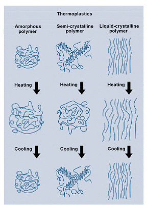

Most plastics fall neatly into one of two categories: amorphous or semi-crystalline. All plastics, regardless of their level of crystallinity, are comprised of many polymer chains. With an amorphous material, the full length of all the polymer chains remains in a somewhat random state before, during and after heating the material to the required processing temperature. The difference in the polymer at low temperature versus high temperature is that at higher temperature there is more space between the polymer chains, allowing them to move more freely (Fig. 1). This increased free volume and heat energy is what eventually allows the plastic to flow and be injection molded. With a semi-crystalline material, you’ll find these same amorphous (random) bunches of polymer chains. However, in addition you will also find areas of tightly packed, regularly shaped crystalline structures called spherulites. These spherulites are made up of many sections of polymer chains called lamellae that have folded upon themselves and are held tightly together due to intermolecular forces acting between the folded sections of polymer chain (Fig. 1).
Figure 1—Amorphous versus semi-crystalline polymer chains (Courtesy DSM).
This tight packing and intermolecular forces are what give the semi-crystalline plastic (such as acetal or nylon) the properties that are desirable for gear applications. These include friction and wear properties, chemical resistance and strength. Heating of a semi-crystalline material through its melt temperature effectively melts any crystalline structure that may have existed in the plastic pellets before processing, causing the polymer chains to go back to a widely spaced random state very similar to an amorphous material at its processing temperature. It is upon cooling of the material back through its crystallization temperature that crystalline structures are formed once again. How quickly the polymer is taken from its melt temperature down through this crystallization temperature will determine both size and quantity of crystalline structures formed. So the resultant crystallinity of any molded gear is very much determined by the gear molder.

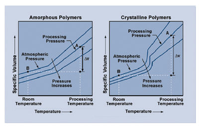

Mold shrinkage is the difference in size between a mold cavity and the molded product that is produced in that cavity. Most simply, shrinkage is a product of thermal expansion. Like most materials, plastics will expand when heated and contract when cooled. Given the relatively high coefficient of thermal expansion (CTE) of plastics (typically 5–25 x that of steel) and the high processing temperatures used during injection molding (typically 350°F–700°F above room temperature), properly predicting and managing this heating and cooling of the plastic during molding is critical in getting a high-quality part. Plastic (with no fillers) shrinkages range from approximately 0.4% to 4% of the cavity dimensions, depending on processing conditions and part geometry.
In addition to the shrinkage caused by thermal expansion, semi-crystalline materials exhibit additional shrinkage as the dense crystalline structures are formed during cooling. This is the reason why semi-crystalline materials generally have higher shrink rates than amorphous materials. In Figure 2, the general way in which these two types of materials expand heating and contract during cooling can be seen. For both amorphous and semi-crystalline materials, there is a temperature above which the rate of expansion will increase. This happens at the point where there is sufficient free volume between polymer chains and the intermolecular forces between them becomes less of a factor in holding the chains close together. This graph is showing the glass transition temperature (Tg) of the amorphous material and the crystalline melt temperature (Tm) of the semi-crystalline material. Note that the very high spike (almost vertical line) for the semi-crystalline material shows the rapid expansion as crystals melt (left to right on the graph) and the rapid contraction as they are formed (right to left on the graph). This spike is exactly why semi-crystalline materials shrink more than amorphous materials. Graphs like these for plastics are generated using very slow rates of heating and cooling on a small sample of material. In the injection molding of a typical gear, the part will have a comparatively large cross section and experiences a comparatively fast cool rate. Because of this, all or most areas of the part will not behave exactly as shown.
Figure 2—Specific volume versus temperature for amorphous and semi-crystaline polymers (Courtesy DSM).
Shrinkage becomes variable and quality defects can result if care is not taken by the molder to minimize the amount of variation both across the length and width of the part and through the thickness of the part. Also note in the graph that the amount of shrinkage is also dependent on pressure. This is another variable controlled by the molder. (With machined plastic or metal gears, this process of expansion and contraction of the raw material has already happened in production of the gear blank itself and is therefore not a variable that requires consideration by the gear manufacturer.) On the other hand, a plastics mold maker and molder need considerable experience with making plastic gears to understand fully how much shrinkage is going to occur and, more specifically, understand how shrinkage rates will vary across the length and width of a part as a result of the various geometries and wall thicknesses in the part.

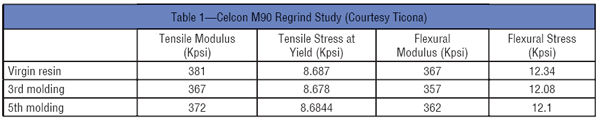

Regrind. By definition, a thermoplastic material is one that can be melted, formed (through cooling), re-melted and re-formed again. This characteristic of plastics is taken advantage of by molders and end users by allowing molded parts and runners to be ground up and recycled into new molded products. Using this recycled material (regrind) is a very good thing for reasons of cost and conservation. And if the quality of the regrind is controlled properly by the molder, there is very little reason for not using some percentage of regrind in your molded gears.
When someone in the molding industry speaks of regrind quality, they are usually referring to the consistency of the granules that are produced after parts or runners are reground. A consistent granule size with a minimum amount of fines (small dust or flake-like particles) or excessively long granules is desired for a few reasons. A consistent granule size will help to ensure uniform melting in the molding process the next time the regrind gets used. Non-uniform melting results in the molten plastic having inconsistent viscosity, which in turn can result in inconsistent dimensions in your molded part. Fines in the regrind can lead to black specking in a light-colored material due to the fact that the small particles melt sooner and may degrade during processing. Since dimensions and black specking can be detected through physical and visual inspection, there is no need to discuss them any further in this paper.
Of even greater importance than granule size is the regrind cleanliness (lack of contaminants) and the controlled exposure to heat and shear. It is during the process of creating and using regrind that contamination has the best chance of being introduced into the molding process. For this reason, everything stated in the earlier section on material handling applies in particular to the regrind. Also many molders do not keep sufficient tabs on the number of heat histories that the regrind has seen and will not discard material after an acceptable number has been reached. This can result in material properties that are greatly reduced due to the excessive amounts of shear and heat seen by the plastic. A gear could be produced that meets print specifications (dimensions and material call out) and has the same appearance, but it could fail due to reduced physical properties.
If regrind is properly handled, plastic parts made from unfilled plastics can typically be molded and remolded at least five times with virtually no drop in material properties. (See Table 1 showing the regrind properties of Celcon M90 acetal material, which is one of the most common plastic gear materials in use today.) This information should not be construed to say that plastic can be reground and reused indefinitely. With each remolding, a higher percentage of polymer chains will have been reduced in length or degraded. Polymer chain length or molecular weight is directly related to key material properties such as tensile strength, flexural strength, fatigue strength and creep resistance. When the percentage reaches a critical limit, more significant drops in properties can be expected. For materials with fillers, it is more important to keep the percentage of regrind or the number of times the material gets reground (referred to as number of heat histories, generations of regrind or regrind pass) to an amount suitable for the requirements of the application. This is mostly due to the fact that the average fiber length will get reduced each time the material gets reground in the grinder, sheared in the molding machine barrel and sheared passing through the gates of the mold cavity.
It is difficult to find published data on regrind percentage properties; even if it was readily available, it would be difficult for a designer to use confidently because so much of the properties are dependent on how the molder chooses to handle the regrind. As a result, gear designers often specify no or low regrind percentages allowed in their plastic gears. A better option is to find a molder committed to the highest quality regrind and to do some up-front testing with gears containing varying percentages to prove that the material will have the properties required for your application. A molder with dedicated press side granulators versus large-scale bulk grinders will be more successful at keeping regrind clean and manageable. Knowing the gear molder has specific procedures in place for tracking the number of heat histories seen by the regrind and discarding the material after a maximum has been reached are most important.

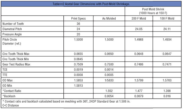

Post-mold shrinkage. So far in this paper, a number of problems that result from molders using excessively low mold temperatures have been discussed. These included voids, molded-in stress and low crystallinity. There is one more very important problem that can have significant consequences in terms of how a molded gear will function in service.
Post-mold shrinkage is when a molded part continues to shrink well after the part has been molded and cooled down to room temperature. For most all molded plastic parts, there is some amount of stress relief and shrinkage that occurs over the first 24 hours or so after molding. This is generally understood and is not a problem to deal with. It is the shrinkage that can occur weeks and months later that spurs the conversation of post-mold shrinkage.
As stated earlier, if polymer chains are frozen in a non-random state, internal stresses result inside of the material. Polymer chains will continue to try to move to the preferred random state. And even though a plastic may be a solid at room temperature, polymer chains still have some amount of mobility as long as the temperature is above the Tg of the material. Acetal has a Tg of 9°F, which means that even at room temperature, the polymer chains have some mobility. This mobility, albeit minimal, allows the material to continue to shrink and stress relieve long after molding. Nylon has a Tg somewhere between 70–140°F (depending on how much moisture it has absorbed), which means nylon will experience overall less post-mold shrinkage, and it will usually require higher than room temperatures to start to happen. For both acetal and nylon, post-mold shrinkage increases quickly as the service temperature increases.
Figure 6 shows post-mold shrinkage versus exposure temperature for acetal molded at various mold temperatures. It is easily seen that post-mold shrinkage is much higher for parts molded with a colder mold. A cold mold restricts initial plastic shrinkage as the molded part gets frozen into a larger, more highly stressed form (the shrinkage that needs to happen does not happen initially). On the contrary, a hotter mold allows shrinkage to occur more naturally, resulting in a smaller, less stressed molded part (the shrinkage happens now instead of later when an end user may not expect it). Because of post-mold shrinkage, a gear could be molded that meets all physical measurements of size and form at the time of first inspection. If measured again many weeks later, especially if the gear was exposed to higher temperatures, it could measure well out of tolerance.
Figure 6—Post-mold shrinkage of acetal (Taken from DuPont Molding Guide).
Table 2 demonstrates what the effect might be on a typical plastic gear’s dimensions when exposed to 150°F for 1,000 hours. A gear that measures nominal for all dimensions at the time of molding can end up being out of spec. by 0.0005 in. on the gear test radius (GTR) and 0.0014 in. on the OD when a 200°F mold gets used and end up being out of spec by 0.002 in. on GTR, and 0.005 in. for OD when a colder 100°F degree mold gets used. This will translate into reduced contact ratios and increased backlash. It is also very possible to have a gear that was flat and round at the time of initial inspection become warped or out of round as a result of excessive post-mold shrinkage.
The best way to minimize these effects of post-mold shrinkage is to minimize stresses during molding (minimize shear and avoid excessive pack pressures) and to use a sufficiently high mold temperature.
