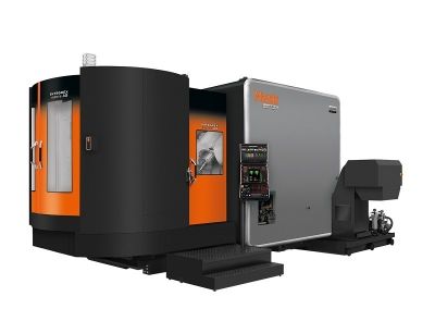

During its Discover 2021 event, Mazak showed shops how they can add gear cutting to their part-processing repertoires and eliminate farming out such work with the company’s INTEGREX i-630V AG HYBRID Multi-Tasking Machine. Equipped with Mazak’s MAZATROL SmoothAi control, SMOOTH Gear Cutting software suite and additional rotary axis scale feedback, the machine eliminates the guesswork often associated with gear cutting, particularly in terms of programming and the synchronization of turning/milling spindles at high rpm. The results are a far more refined cutting action and smoother gear teeth surface finishes.
Designed for heavy-duty 5-axis machining and large, highly complex parts, the INTEGREX i-630V AG employs a powerful turning spindle with C-axis control and a rigid milling spindle with B-axis tilt of -30/+120 degrees, both of which are monitored via rotary axis scale feedback.
